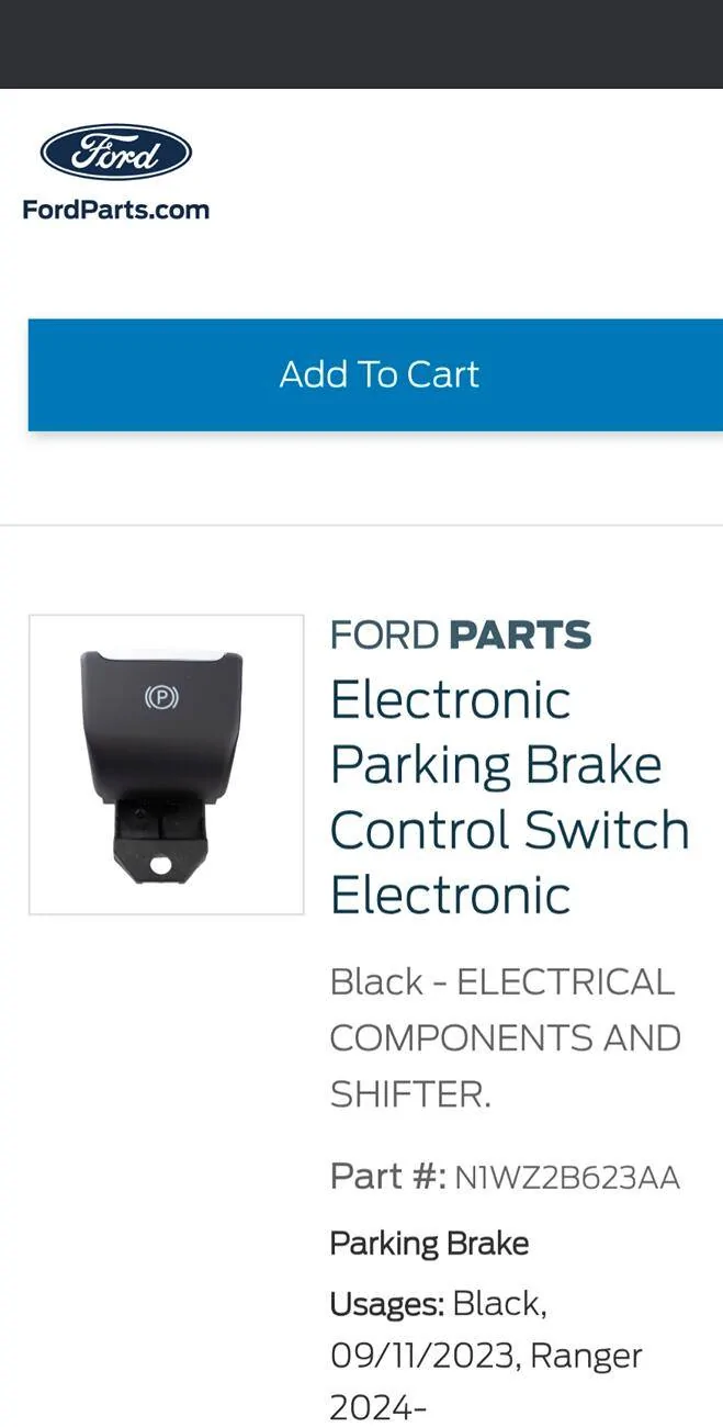

It was control switch electronic parking brake

Ford Ranger Parking brake limited function less than 9 k on 2024 1000014711
