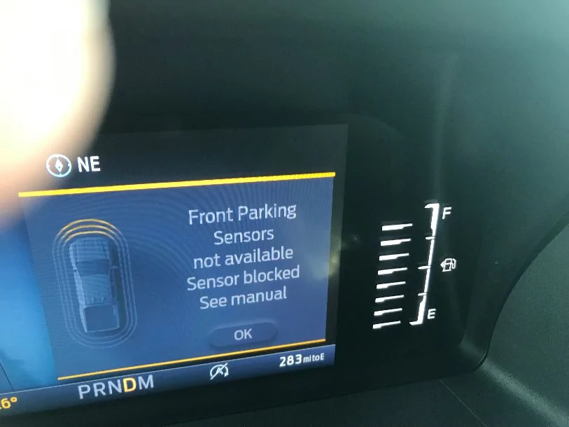

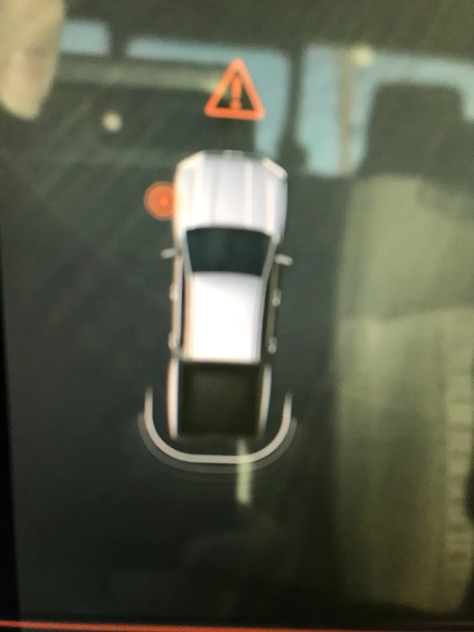

Hello, I have a new 2024 XLT with the parking sensors front & rear for parking, how close you are to something. My problem is when the temps get below 32 degrees it keeps going off in the dash & radio, once it gets above 32 degrees it fine. The dealer says no codes showing so they can't do anything about it without proof that something is wrong! as you can see the pic of the dash & radio screen with along the beeping that comes with it. It will pop up when you are below 10 mph & will keep going off until you get above 20 mph @ stoplights just waiting for the light to turn green sitting in the driveway. I have done everything & nothing works, includes cleaning it blowing it out but stops when the temps go up & doesn't do it all summer long! even with the pic & telling the dealer all the info they say they can't get it to do the something & no codes so they can't do anything. ! there suggestion was stop by when it's doing it, which I have done & when asked service if someone could just come out & look @ it while it was going off, I was told no you need an appointment we just can't stop & have someone look @ your truck @ that time. They have had it since Monday morning when I dropped off, it was doing then I asked them to come out & you will see what I am talking about, that was not wright now! when they called today & said they can't get it to go off or show a code the best thing is to stop by when it happens, said to them I have asked you 3x to do just that & you told me no! has anyone else had anything like this happen to you @ any point!

I think there’s been a few posts here with similar issues. Looks like their fix has been to get that sensor replaced. Seems they get quite sensitive when the temps are low

I had same problem last year, and it won’t send a code, took 4 or 5 trips to dealer for them to just replace the simple sensor, and then they could not find the right paint code to paint it , thru these forums I figured it out and gave them the paint code . What a hassle for a batch of bad ford sensors,, Your right, below freezing was the trigger….
