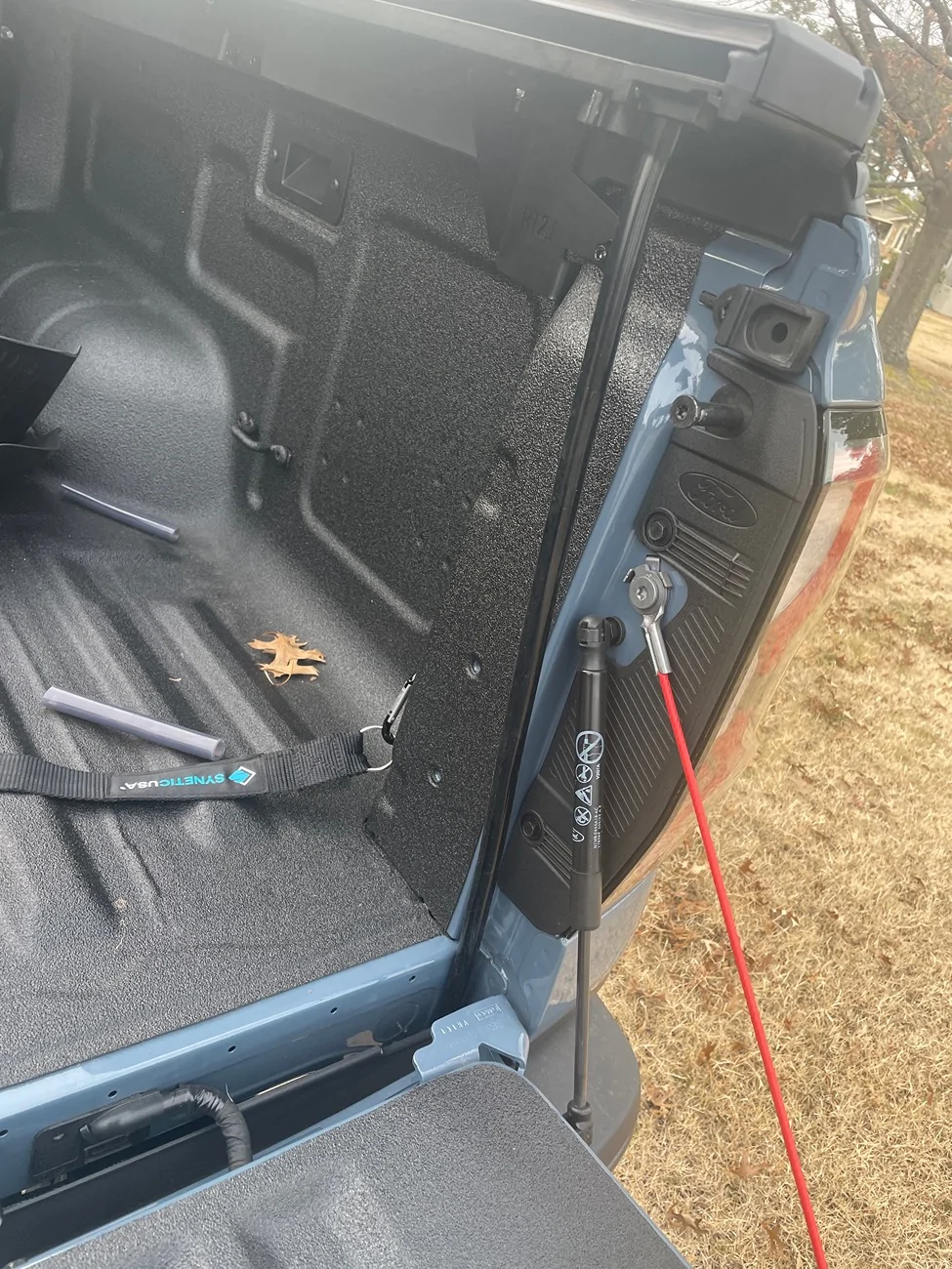

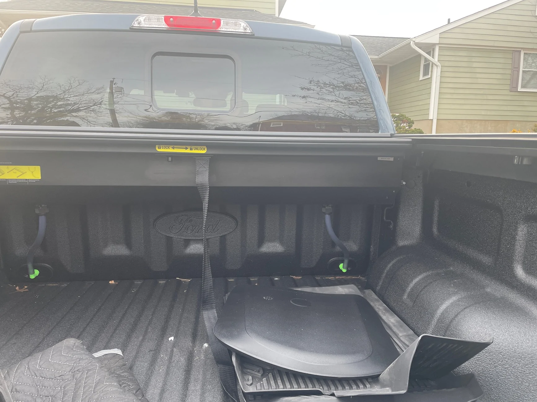

Simple install, about 1.5 hours. I sacrificed the supplied shorter tubes to ensure the main drain drops to alongside the frame rail vs onto exhaust, insulation, wiring. Added Rain Bird irrigation and sprinkler 90 degree bends, like .98 each x 4. I also added, a section of 1/2"ID 5/8"OD silicone tube for the rear drains because it fits perfect between bumper/Tailgate and Bed with tailgate closed. No water entry, though I may ad a 1/2"x1/2" hard foam insulation tape between the topper rear seal and the topper, sit it sits more vertical and maybe a bit tighter seal with center of tailgate. No gaps, but just barely.

No leaks in car wash!

Yeah, after car wash it was peeing out the 4 tubes at the frame line. The one over tank dribbles a bit, inside the plastic tank shield $4 for fittings, $6 for silicone hose.
