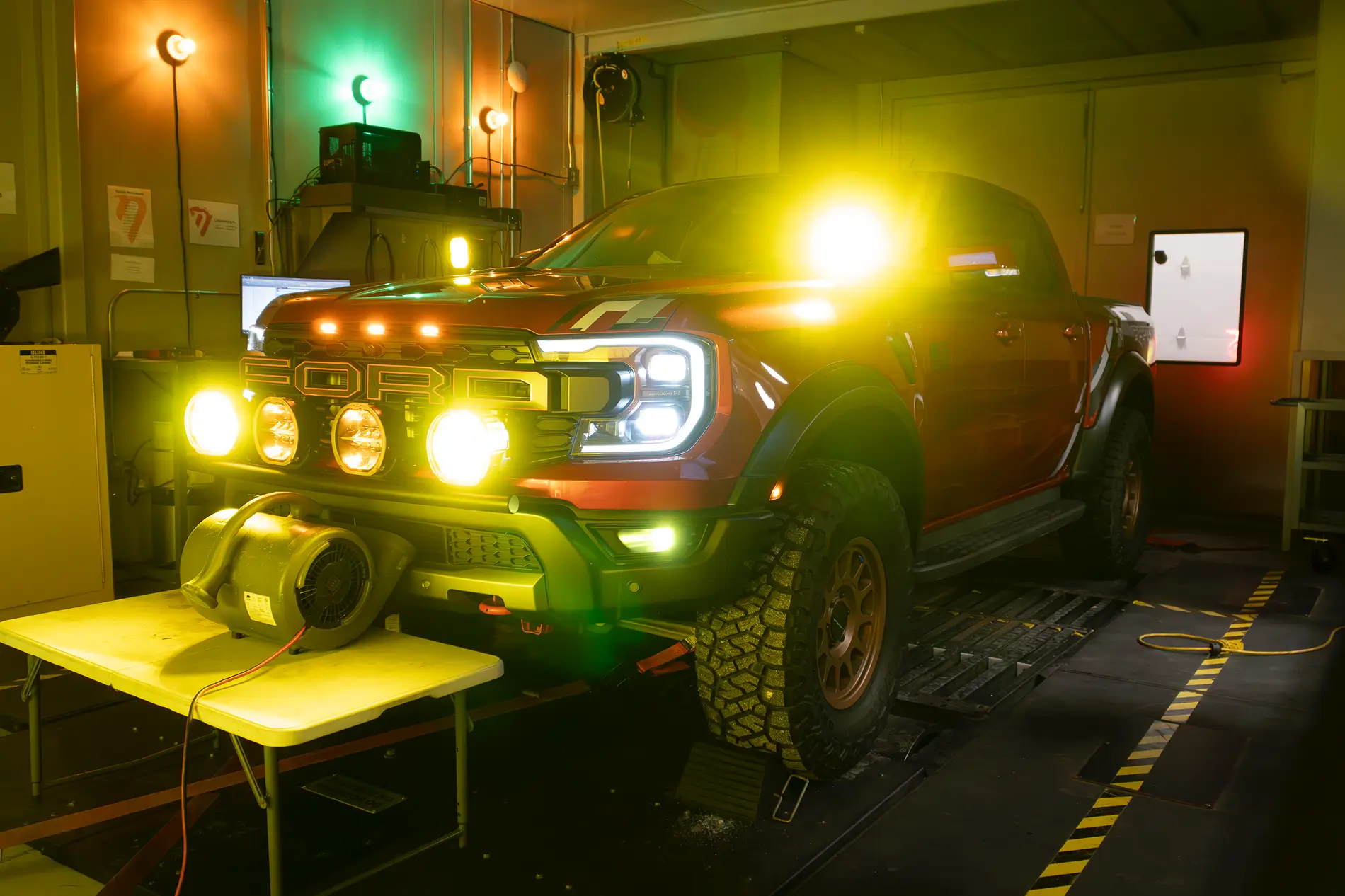

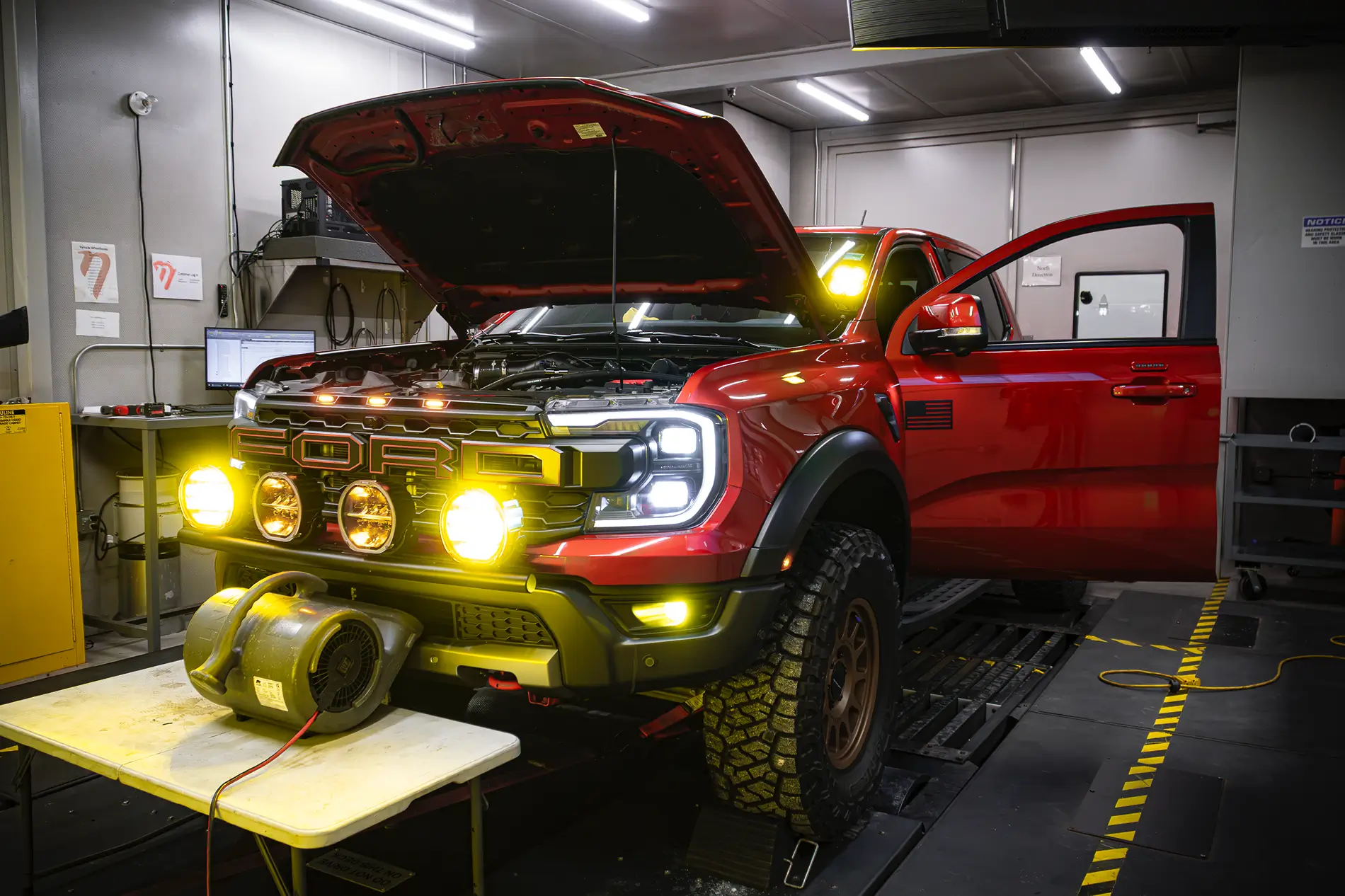

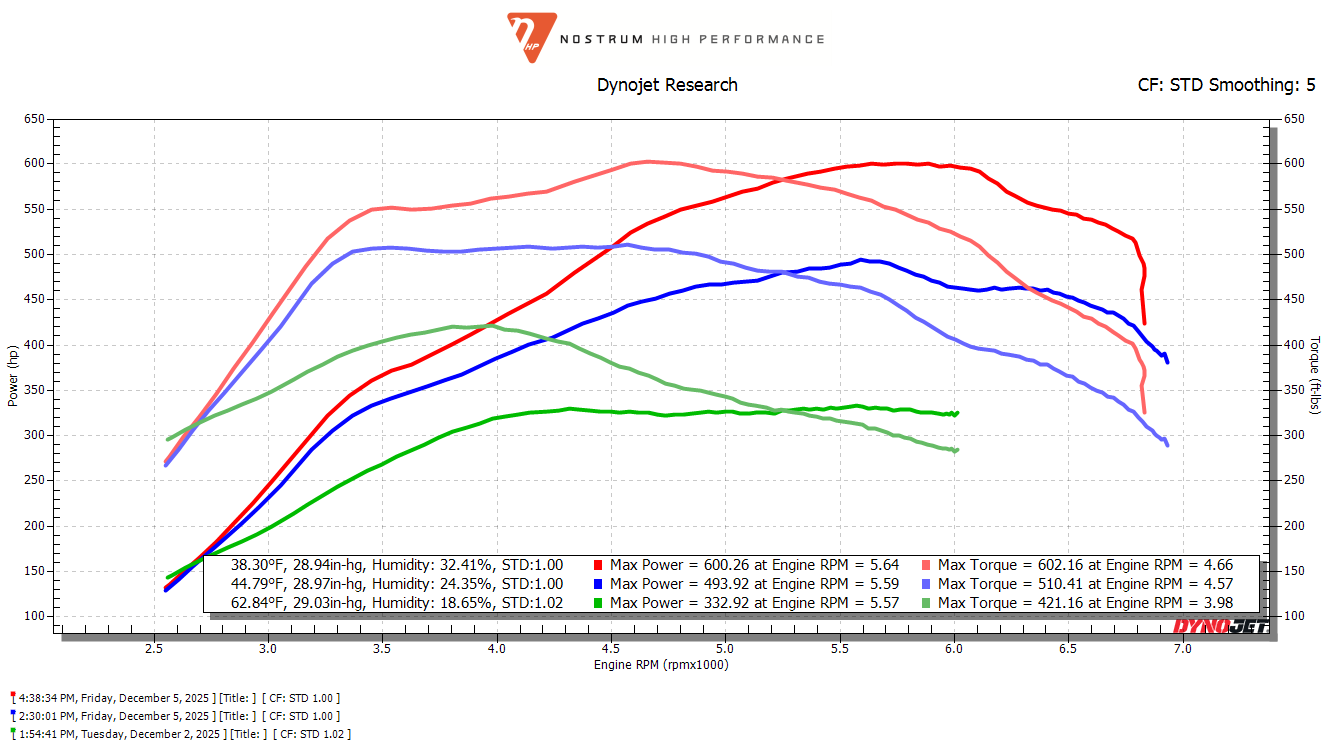

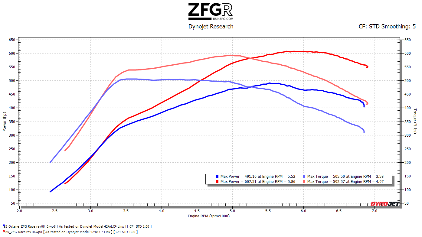

Hats off to the Nostrum crew. Willing to build what the customer wants and do it with no hassle. They handled everything. 600hp with 35” wheel/tire combo. With more coming. It’s going to be rowdy…
NEW numbers coming soon!

Nice build man! Any idea why it lost almost 100hp after 6000rpm?
What size tires do you have?
Edit: Just saw you mention it's on 35s. Figured that's why it's down -70whp from the other build Nostrum did with the same mods.
I tuned a Bronco Raptor on HEAVY 38s and it lost -30whp from where you're at.
TIRE SIZE MATTERS, glad you're on a proper tire! Have fun!
Not just tire size but tire weight is HUGE. That's one of the first things I look at with tires when I know what size I want.
Also awesome build truck looks great and I bet its a blast to drive.
100%. I had a guy try to compare a heavy 38in tire to a 33in tire and claim more power on the same setup on the dyno.
I thought he understood size/weight vs power on a chassis dynamometer, I guess not. Then again he has very little on hands dyno experience. Not apples to apples.
This truck looks awesome on 35s, I think that's the sweet spot for the Ranger Raptor!

Stock trans at the time if the dyno. Power is definitely a little Limited with brand of intake that's currently on it. Looking forward to what's next!

Edit: I just noticed you had the chart from Friday we ended up making 2 more pulls Monday to clean up the e85 tune top end. Here is the dyno chart after I cleaned up the e85 tune on Monday! Now it's time for some more mods!
Ford Ranger Pyroraptor 600+hp build…not done yet 93 vs e85
I’m waiting on Houston Speed Freaks & GSP to create a carbon intake for us like the ST’s. We laser scanned under the hood of my RR for the design. 🤞
