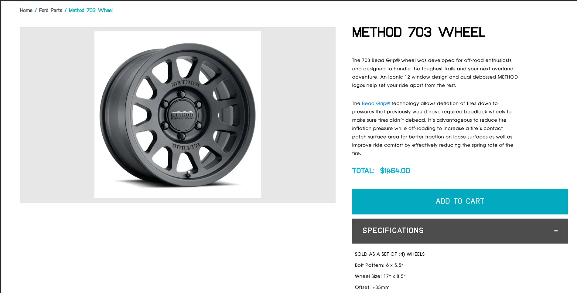

i assume its the offset of the wheel, since everyone is saying they work, but your factory ones only work with spacers. Ask them if you need a 0 or +35mm offset in order for them to work. By looking at how much others stick out with the portals, it's probably +35mm.
Since they (74Weld) only sell the +35mm.....
Screenshot from 74Weld website
Ford Ranger 74 Weld Portal Axle Kit & Wilwood Brake Kit - UK/EU First! With a catch... Screenshot 2026-01-21 at 10.12.54 PM

Since they only sell the +35mm.....
The method wheel that 74weld designed for the kit is a +45 offset so I am guessing he will either need those wheels or a 10mm spacer to clear the brakes
The screenshot I posted is from 74welds website ⬆.
Maybe if you buy the first 35mm they throw the other 10mm in for free.
You are correct, that one does say it’s for their portals.
Only reason I posted that one was OP kept saying 703 wheel model.
we’re doing a lot of work, when they’re website tells what to use. Maybe we get a discount or free Tshirt.
