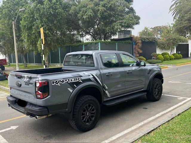

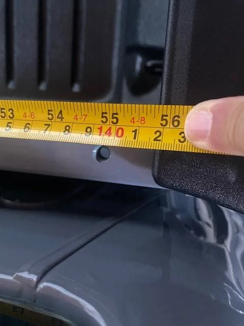

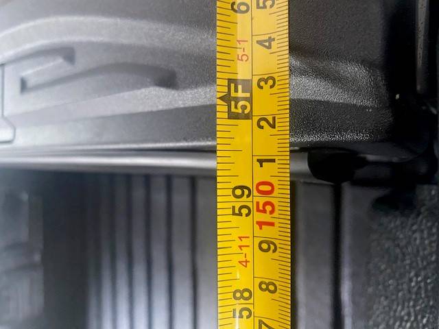

I will correct my previous post as I have taken precise measurements of the bed and the US-spec 5g Bakflip MX4 cover. The bed measures L1512mm x W1418mm, right to the edge of the bed rail caps, while the US-spec 5g MX4 cover measures L1532mm x 1435mm. The good news is that it will indeed fit perfectly on the Ranger Raptor. To complete the installation, I need to order a replacement rail assembly set since I have misplaced the ones that originally came with my backflip cover. I will share pictures as soon as I finish the installation. My apologies if I provided incorrect information in my previous post.

Seriously bad-ass looking truck, Luis!

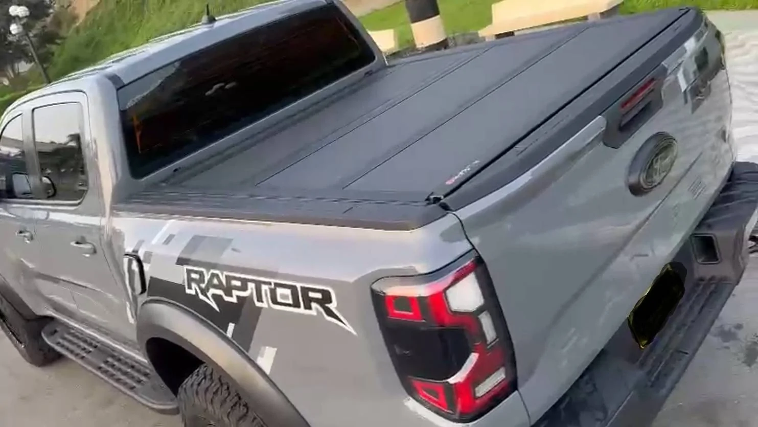

Great to know.. any pictures after fitment? Any gaps?

@borfoo3 Sorry for the poor picture, but I captured it from a video I recorded before selling my Ranger Raptor. My Ranger 2019-2023 Bakflip MX4 tonneau cover (P/N 448333) was a perfect fit for my truck; there were no gaps whatsoever. It seemed as if it was custom-made for it. You can rest assured that you can transfer your 5th generation tonneau covers to the 6th generation.
