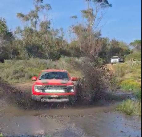

You have to share a bit more about that light bar you installed in the grill. How bright is it? Was it hard to install?

Hi rwolfcastle happy to do so!
The Product is from
Strands Lighting Division
COMPLETE KIT SIBERIA SR 32″ LED BAR
SKU: 809172-KIT
RRP: €360.50 (excl. tax)
COMPLETE KIT SIBERIA SR 32" LED BAR - Strands (strandseurope.com)
The Specs are listed under the Link.
I chose this one because of the E-certification to be legal here in Europe on the road.
a nice side touch is the driving light that gives a cool effect behind the Grill.
almost like the F150 Position lights in the front - just a little cooler to my humble opinion :)
You can select them to Orange or White (legal here)
The installation was not difficult in the complicated sense.
You have to cut the universal Brackets and drill new Holes in them.
Secondly you need a Rotary Tool like a Dremmel to sand some small
spaces on the back of the Grill - really minimal.
Connect it to the Upfitter Switches leads with the wire harness in the Kit -
Hook up to the switches is easy because the leads are nice provided in the front by Ford AND
documented in the user manual of the Ranger Raptor.
if your used to work on your car its not difficult.
hope that helps

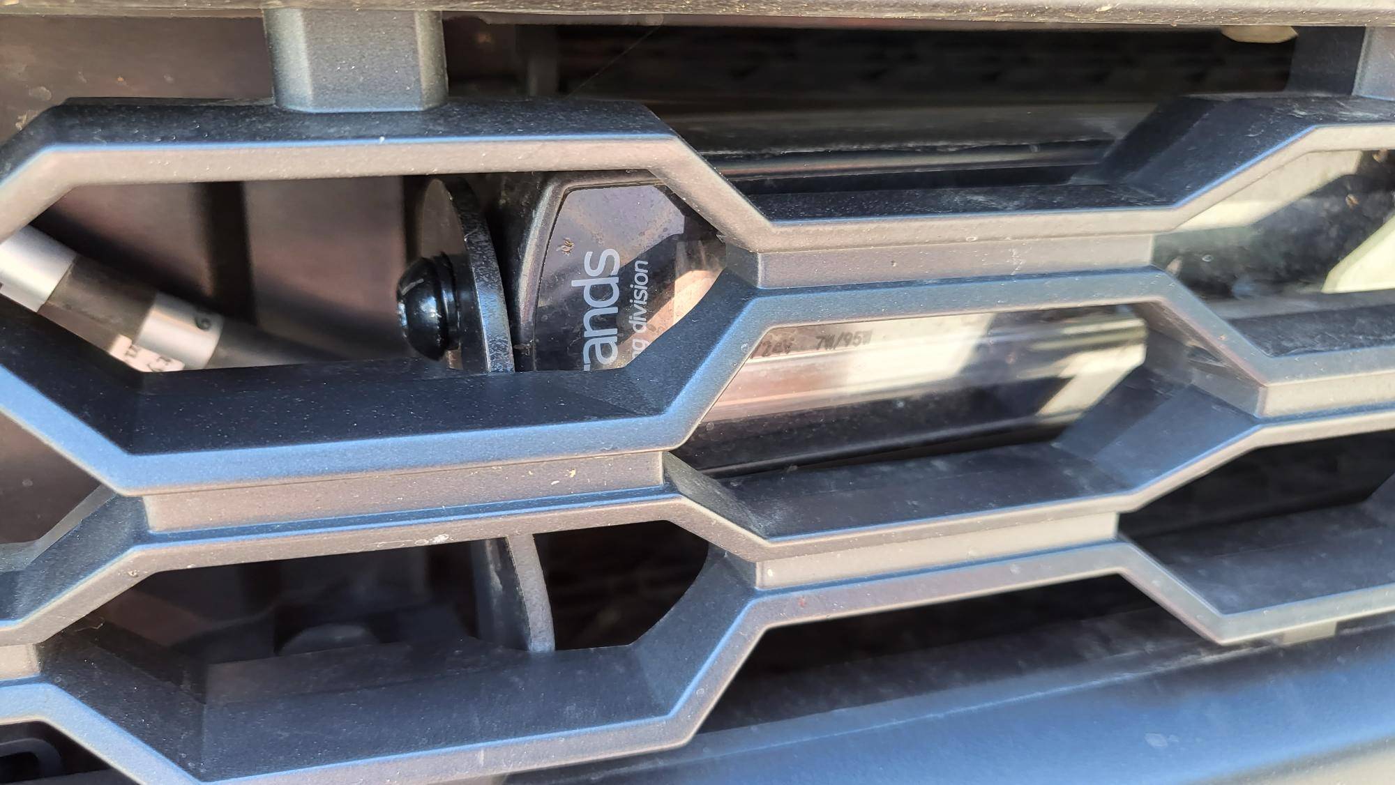

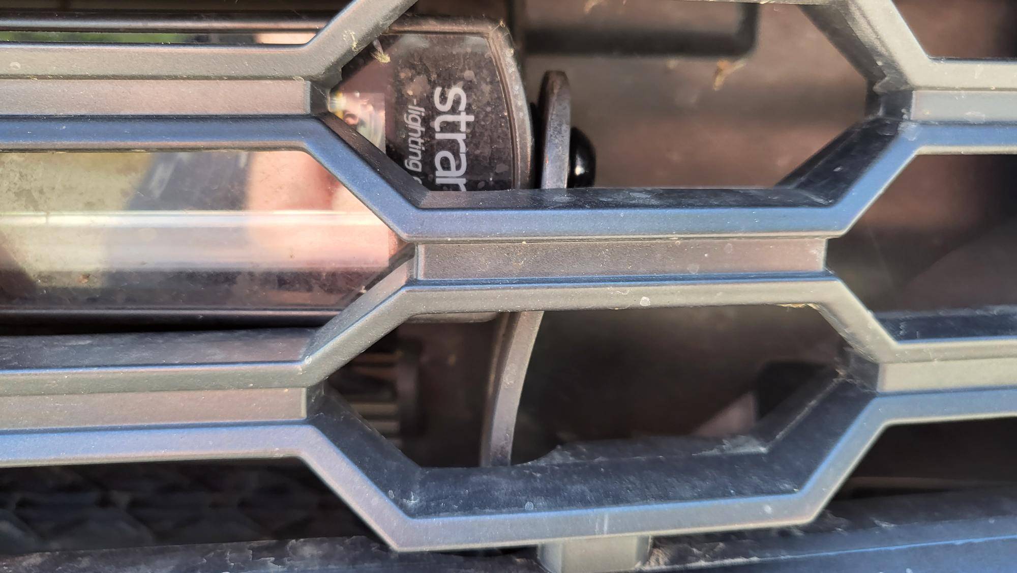

Thanks! Compared to what that light bar looks like on their site, it almost looks like you've placed it behind the grill so that the grill is splitting the light bar into those sections. If you have a chance, I'd like to see some close ups of the light bar to get an idea of how it's attached.
I like the built-in look of it a lot. Does it block much airflow to the engine?

Hi - Here a Link to a Different solution behind the Grill - so you get an idea of the work involved. Split lightbars install behind grill - I will post some detail pics of my solution later today, but the outer left and right mounting points are the same as with the Video.
Her some Closeups from my Install :
