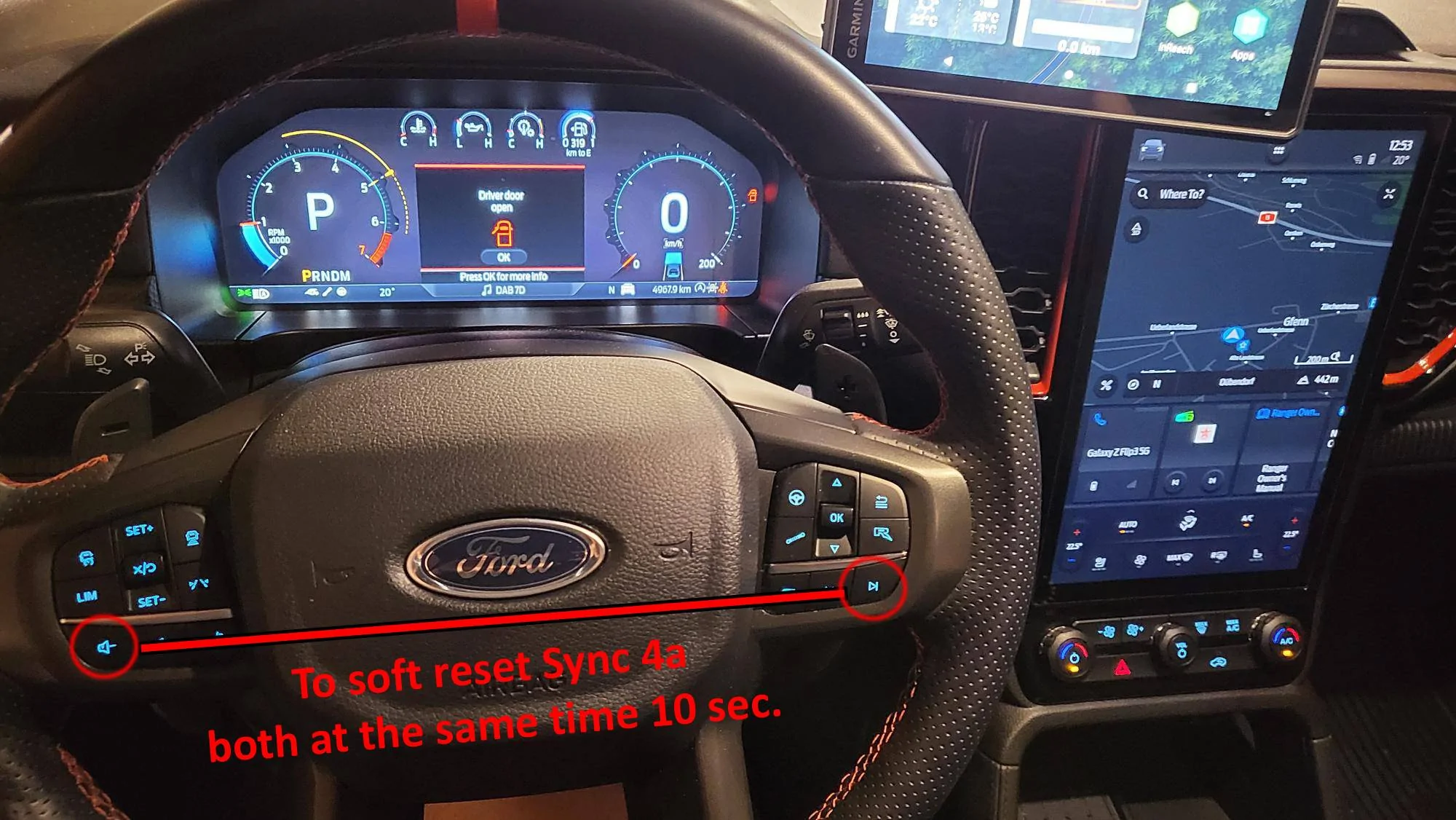

The worst was the freezing up of the Sync4a screen - workaround (also works during driving:
Ford Ranger A few of my thoughts/issues with my new Raptor New_Gen_Ranger_Raptor_softreset_Sync4a
A software update is comming apparently - but the soft reset is easy and no hassle.

Thanks for your reply!
Good to know about the soft reset. I only had it happen once fortunately.

The freeze will always happen. I have a 21 edge and the screen still freezes no matter what update they push out. Luckily the reset works but its annoying. Sync 4 still needs a lot of work

Hi coldconfession13 yeah indeed is was highly annoying - on tracks when the group wanted to move on everyone had to wait 5 minutes (deep sleep) or disconnect the battery - you can imagine the "Jeep Guys" had their laughs - Until i found out about the soft reset as a work around then it takes a couple of seconds to get back where it should be.
I hope very much, as you, Ford will get a grip on this Gremlin so we not have to worry about it anymore.
