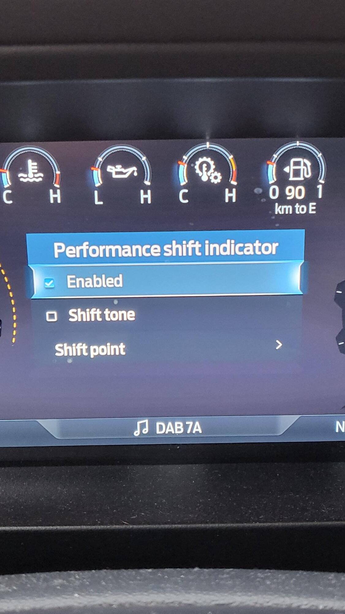

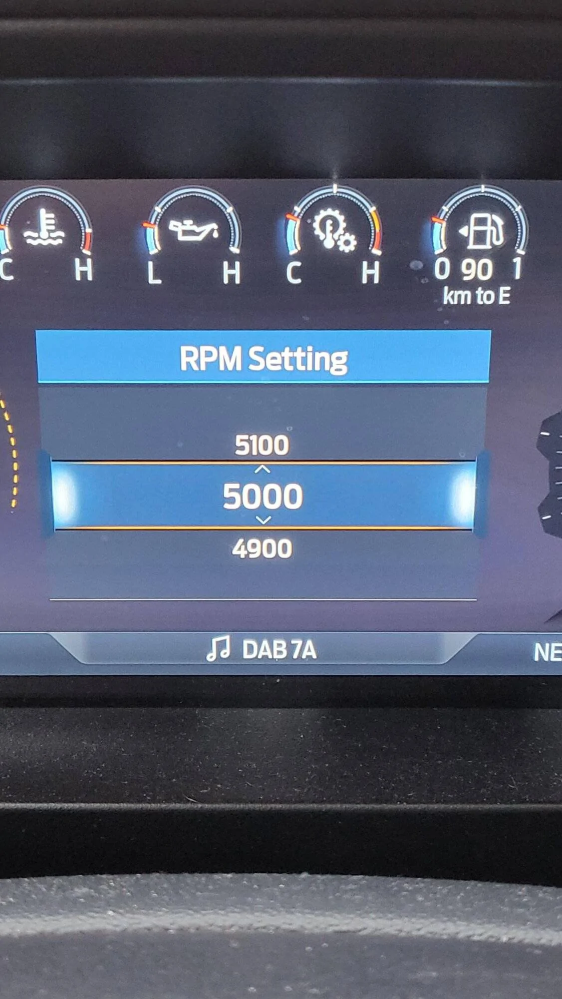

Flashe30: the shiftpoints can be set here under Settings - all the way down - then:
Ford Ranger A few of my thoughts/issues with my new Raptor 20231024_090036
Then shift point and select the RPM :
Ford Ranger A few of my thoughts/issues with my new Raptor 20231024_090051

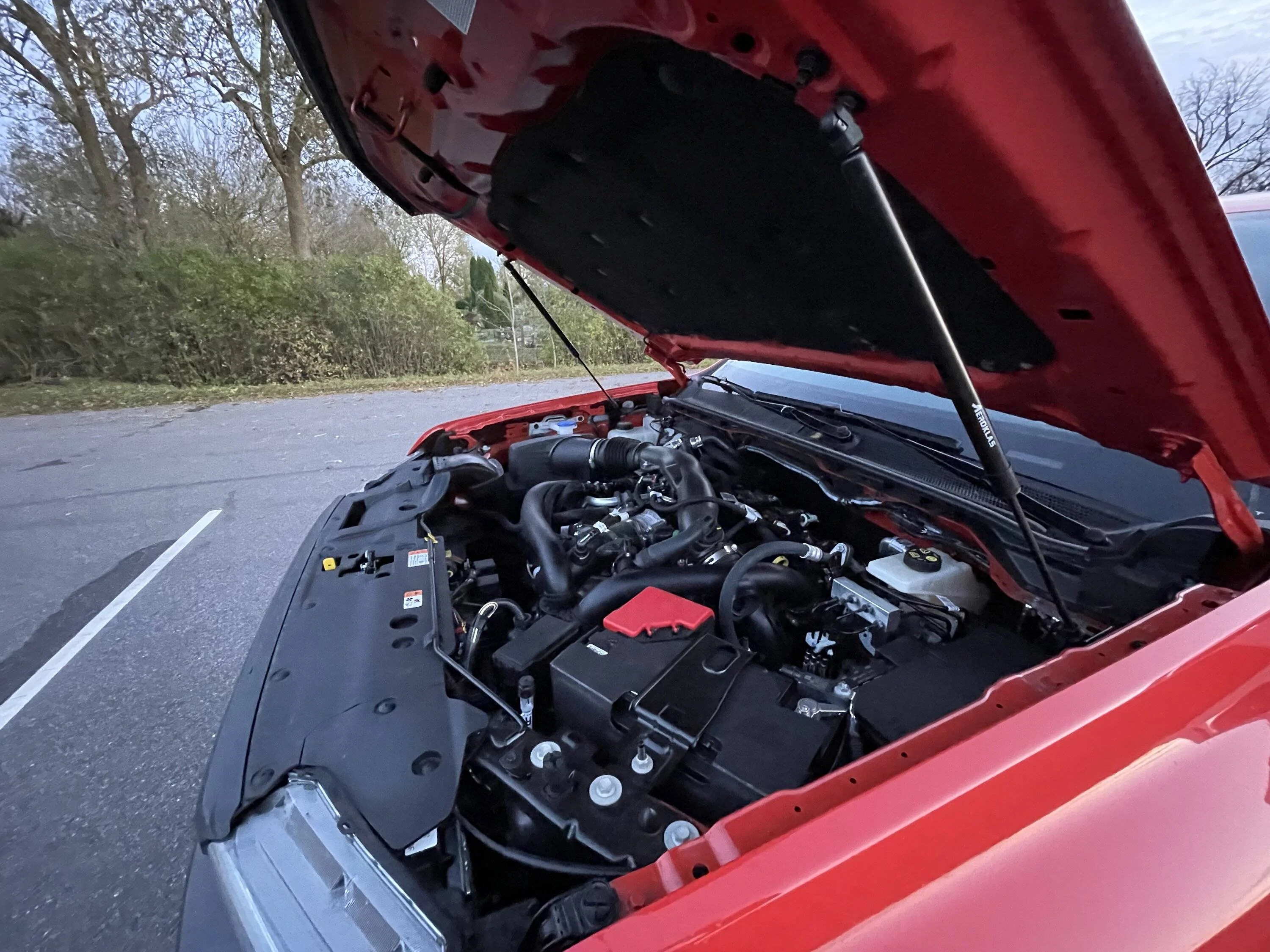

You have hood struts or not? I got them installed by the dealer and at least left side of the hood sometimes really vibrates.
Showing gear numbers or D it depends on the driving mode you have selected. Regular rear wheel normal drive shows only D and you can see the gear you’re in if you pull the flap.
No I don't have hood struts, are they an option?
I also notice the lef side from 120kph onwards but the right is the same, it's just not in my field of view.

I plan first oil change on 5k that means in about few weeks. Also planning to ask about this vibration, pretty scary with strong wind and big truck coming to my way on the road and the hood suddenly jumps and vibrates like that :D But if they find it ok, let it be. Let that big orange hood fly away.
The thing is I don’t know about right side as I am too short to see that side, left side I see.
I had only the standard stupid hood stick but then we realized it’s a little complicated for me to handle the hood because I’m too short, so my dealer helped me out and got me hood struts.
