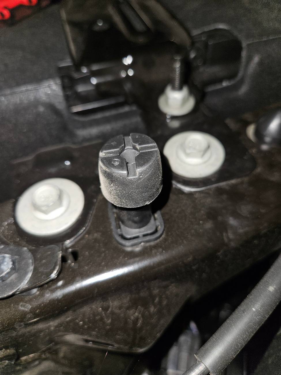

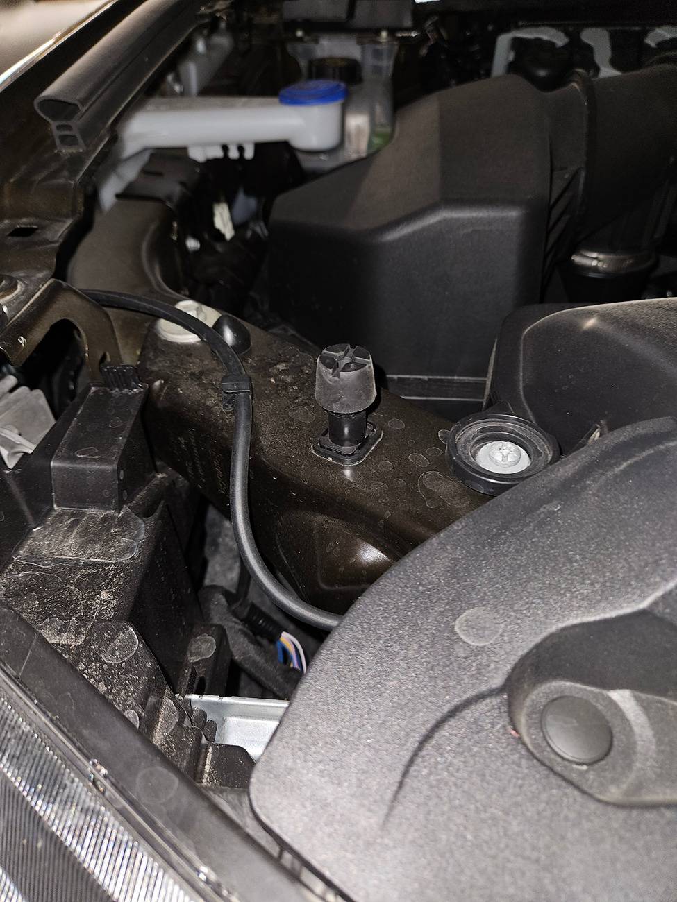

My initial theory is on how hard I slam the door. If I bring it in (no lights on dash) normally I get whistling. If I consciously close the door with more effort it appears to solve it. That’s my running theory.
Other issues:
* Driver taillight paint chip
* Rear seat latch
* Front hood doesn’t fully close unless I use some momentum from 2 feet above (maybe that’s normal for a Ford)?
* Occasionally static on car CarPlay phone conversation.

Hood latch has a bulletin about it. It needs adjusting.
