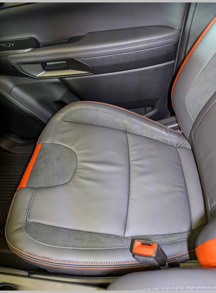

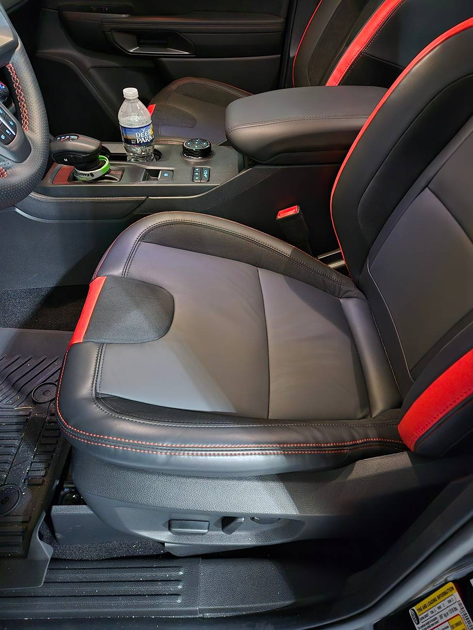

Just checked my seats at 3 months old. No issues here either, except the normal rear bolster wrinkles that happen with every leather seat. I would be bummed out with the pics I'm seeing being posted.
Ford Ranger Driver Seat Leather issues: Ranger Raptor 20240912_075305
Ford Ranger Driver Seat Leather issues: Ranger Raptor 20240912_075254

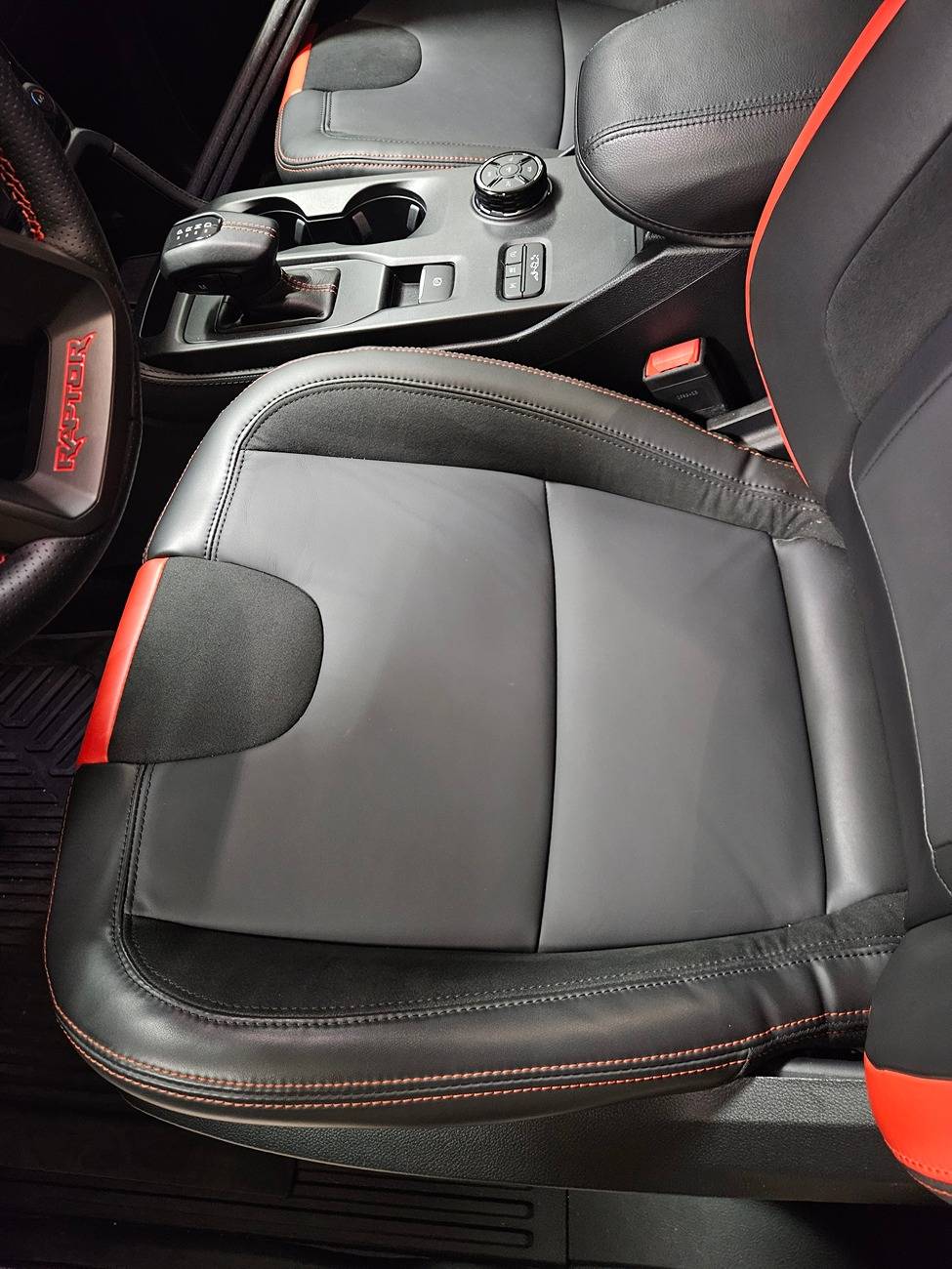

Unfortunately not limited to the drivers' seat. Mine looks better than some, but definitely not perfect.
However, the passenger seat, which has literally had a passenger for 10 miles total

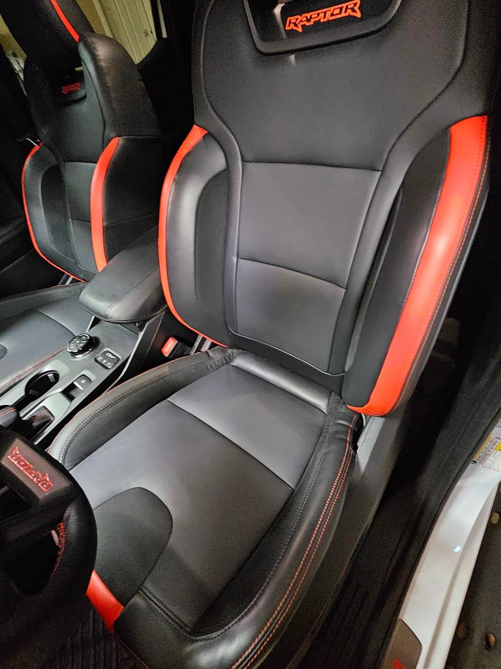

Ford Ranger Driver Seat Leather issues: Ranger Raptor 1726166030986-za

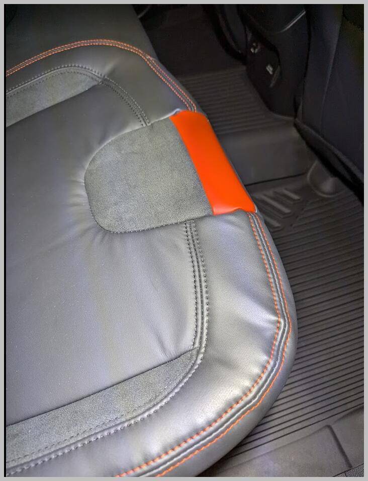

and the rear seat, which has never had a person in it
Ford Ranger Driver Seat Leather issues: Ranger Raptor 1726166062013-hi

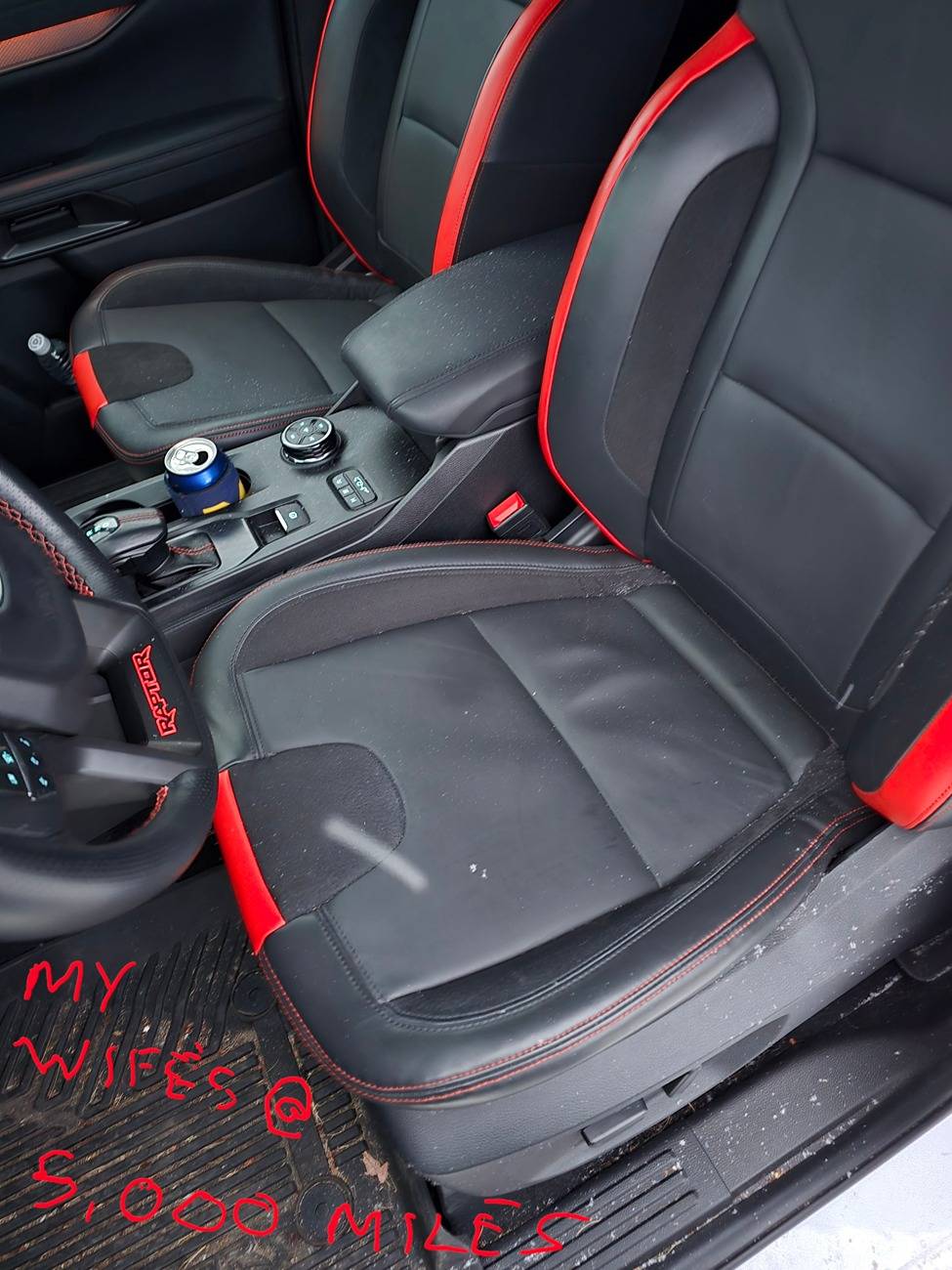

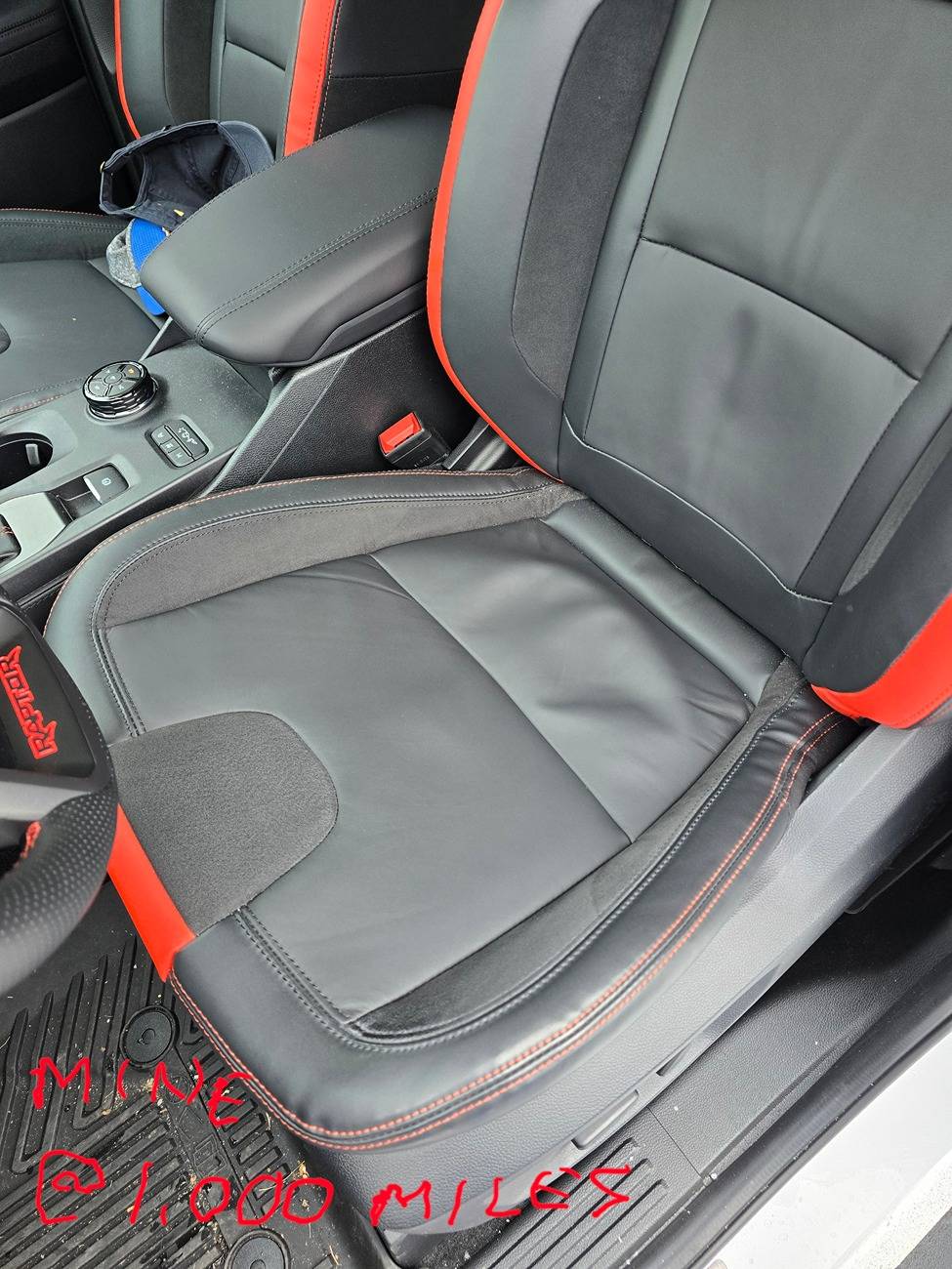

This is my wife's @ 5,000 miles and mine @ 1,000 miles. My wives aren't as bad as mine, but this is still totally unacceptable for a premium priced vehicle. What a blatant slap in the face to know this is continuing, and they're still letting these vehicles be made. I love my ranger raptor but this will definitely take the wind out of my sails about this Premium Truck from FoMoCo.
Ford Ranger Driver Seat Leather issues: Ranger Raptor 20241130_165759
Ford Ranger Driver Seat Leather issues: Ranger Raptor 20241130_092540

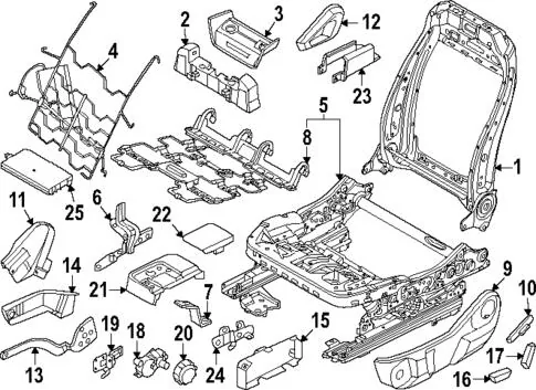

Everything will fail. The problem is that there is no support under the foam seat cushion, #4 basket is insufficient support for the back half. The back half of the seat just freefall sinks with weight. Put a 3-4" plate in the middle of the frame to support the foam.
Ford Ranger Driver Seat Leather issues: Ranger Raptor 7bacfe22ae3522faae7880baed938c69
Yeah that makes sense. I used to work for a auto seat manufacturer. I just talked to the head engineer there, showed him your diagram, and he told me obviously that oems are doing everything they can to cut costs, and they are going from sinusoidal type spring to a "flex mat". He doesn't make this particular seat, but he said he's going to speak to the engineers at Ford and get back with me regarding any pertinent information if there even is any. He also stated something that we all need to know. Leather is supposed to wrinkle like old man's face, vinyl isn't supposed to wrinkle. We used to make fun of vinyl back in the day, it's called pleather, fake leather, so what would you prefer? Thanks for sharing the blueprint !
LM Manufacturing is who makes the seats, per the sticker on the plastic that was on my seats.
