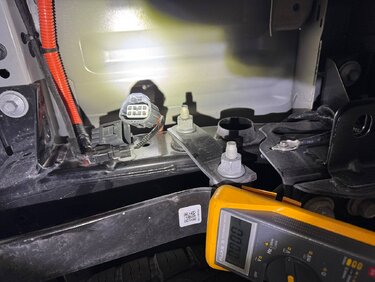

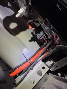

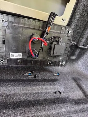

Ok, I’ll do it this way:
It is bad practice splicing or using wire taps in an exposed area like that, so will always use a liquid intrusion resistant connection. The manufacturers do as well for the same reason.
There is a fair amount of room there, and the connectors are well exposed, so I did the connector work lying on a creeper in my shop.
If you follow the 120V wires down to the frame there is connector there. The male side, which goes up to the bed mounted plate has 4 unpopulated pin positions. If you compare the female side to the male side, you can see that there are two positions that have female sockets that have wire from the frame harness terminated there. One is black, (12V-), the other is violet (12V+). The male side is missing the corresponding pins, so it is just a matter of running wires and pinning the terminations. The male side has silicone rubber plugs in them, but they can be easily pushed out; a small Allen key works nicely. I had pins that happened to fit from some TE connectivity (aka Amp) connectors I had leftover from a project a couple years ago, so used those. I also have all sorts of specialized crimpers, which made the whole operation simpler for me. (I will hunt for the part# of those pins and will update this if I can find them.)
You could twist and tin the ends of the wires and carefully insert them into the male connector if you don’t have or can’t find the right pins or install tools. The pins are flat, so once tinned, you can flatten the ends to help with insertion, noting the flat orientation of the female sockets.
Those connectors also use silicon wire seals, (necessary for that high ‘splash’ area). that you need to put on before you pin the wires, but if you don’t have the seals, a little dab of of silicone sealer pushed into the back of the male connector at those positions will work once you have the wires inserted, and that will double up to hold them in place once the sealer sets up. Just make sure it sets up evenly all around the wires. This is important to prevent moisture (and corrosion) intrusion.
I then used some split black plastic casing to protect the wires from any chafing, and zip tied it to the Ford casing. Ford used the same stuff, but it is orange as it’s considered ‘high voltage’ wiring.
As noted in my earlier post, I used black (12V-) and red (12V+) silicone insulated 14awg wiring as that’s what I had in my shop. The insulation is thicker on that stuff, so it was a bit of a pain to work in the connector. Any 14awg stranded THWN (wet location) wire will work fine for you.
