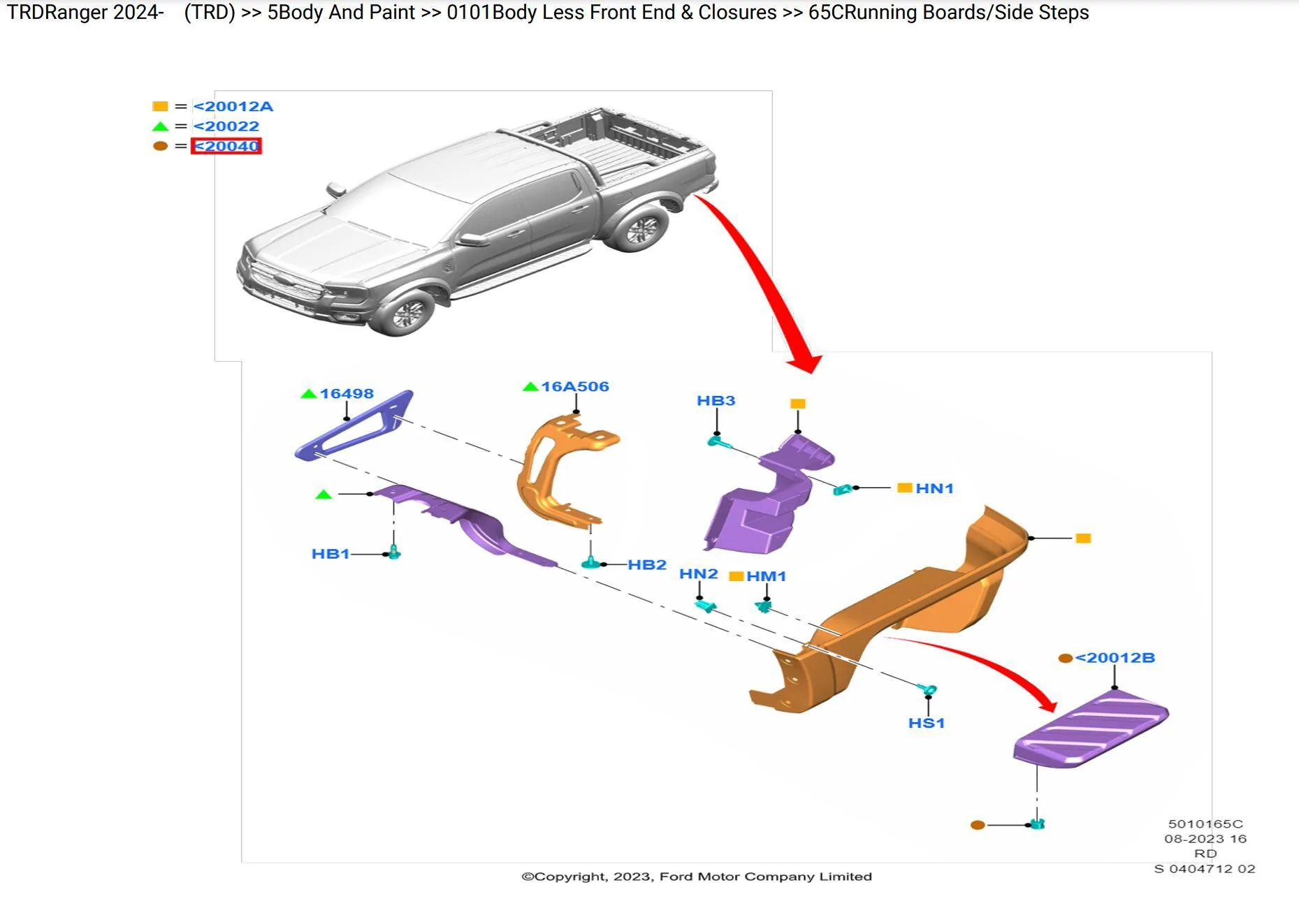

I am looking to add the box step after the fact as well. A Ford OEM parts manufacturer sent me the following diagram for the step parts. Looks like it should be doable.
  • Body Side Step - Right —> Part #N1WZ6020040A
  • Body Side Step - Left —> Part #N1WZ6020041A
Ford Ranger Adding Options at Dealership After Delivery Screenshot 2024-05-03 at 7.32.47 AM
Please report back if it works for you or not.

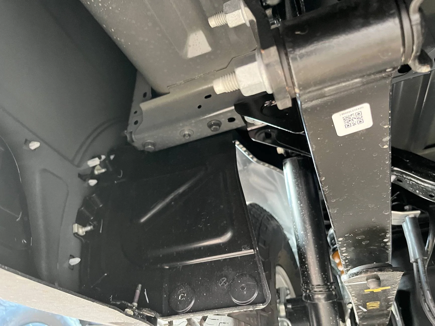

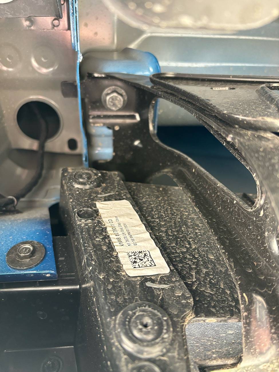

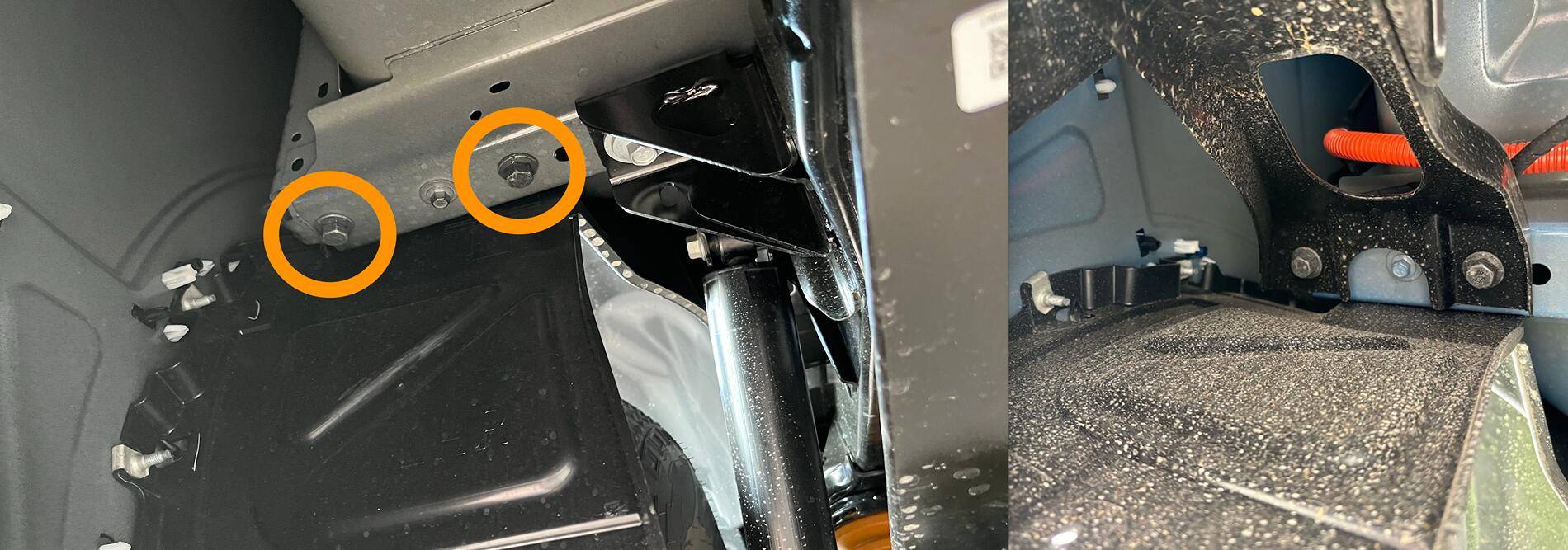

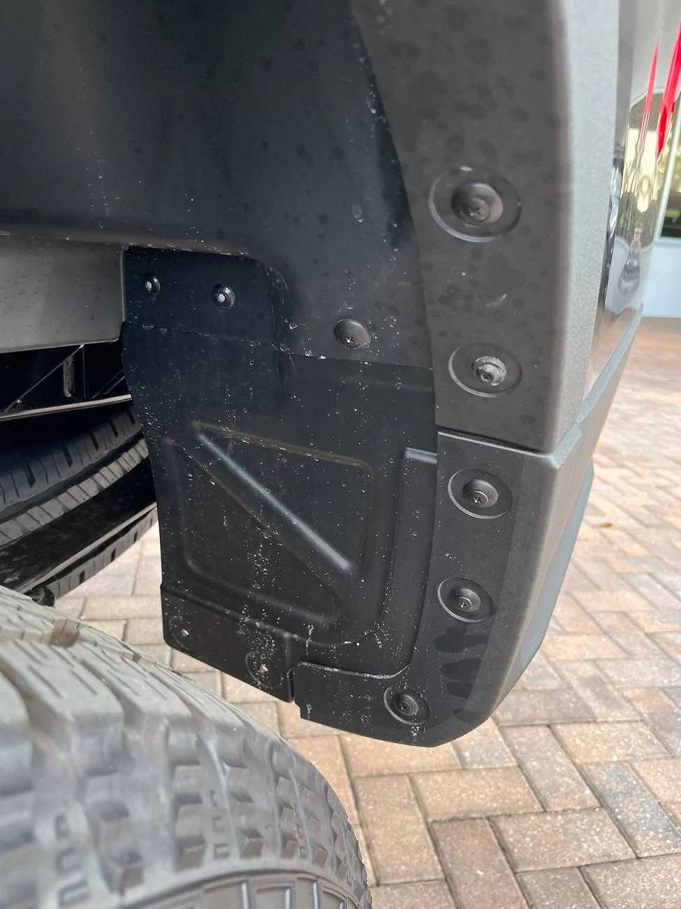

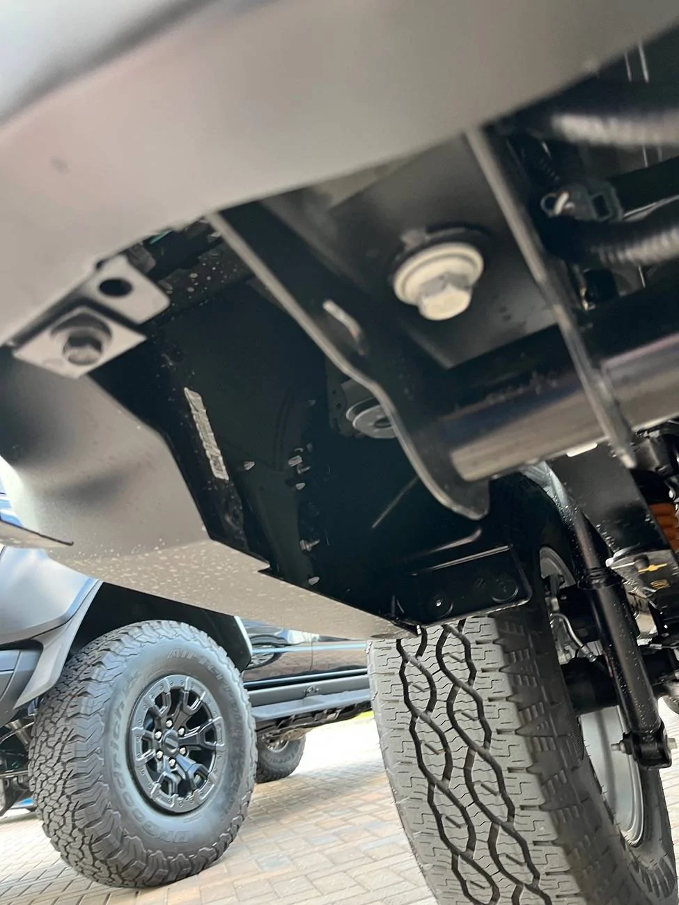

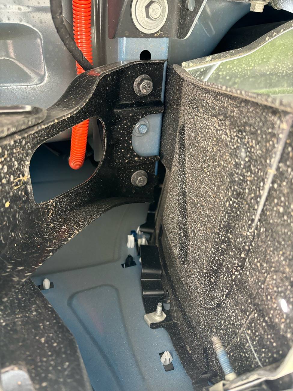

I took these pics under the drivers side rear fender area of an STX that does not have the bed step. Based on @jedadiah pics of the front that they posted with the step and my front pic without the step, it looks like the same bolts/holes exist in the frame for both. However, I didn’t take a pic at the same angle as them on the back so that one remains inconclusive unless someone else can take a picture of their non-step truck on the back. It at least looks promising that it could be added later. I included pics of how it’s bolted in the wheel well too.
Front of non-step STX:
Ford Ranger Adding Options at Dealership After Delivery EE006C1E-88CD-470F-9248-165263ED1A22
Comparison side by side with bolts circled:
Ford Ranger Adding Options at Dealership After Delivery 114FCD77-8280-4399-919B-DB11707EE4DA
Back of non-step STX (not good angle):
Ford Ranger Adding Options at Dealership After Delivery C30ED3D5-A1F6-410F-8614-54FBAE83437C
Wheel well of non-step STX:
Ford Ranger Adding Options at Dealership After Delivery 89B8E0FC-D4AF-45A1-A4E4-3CF3C68A2DF3
