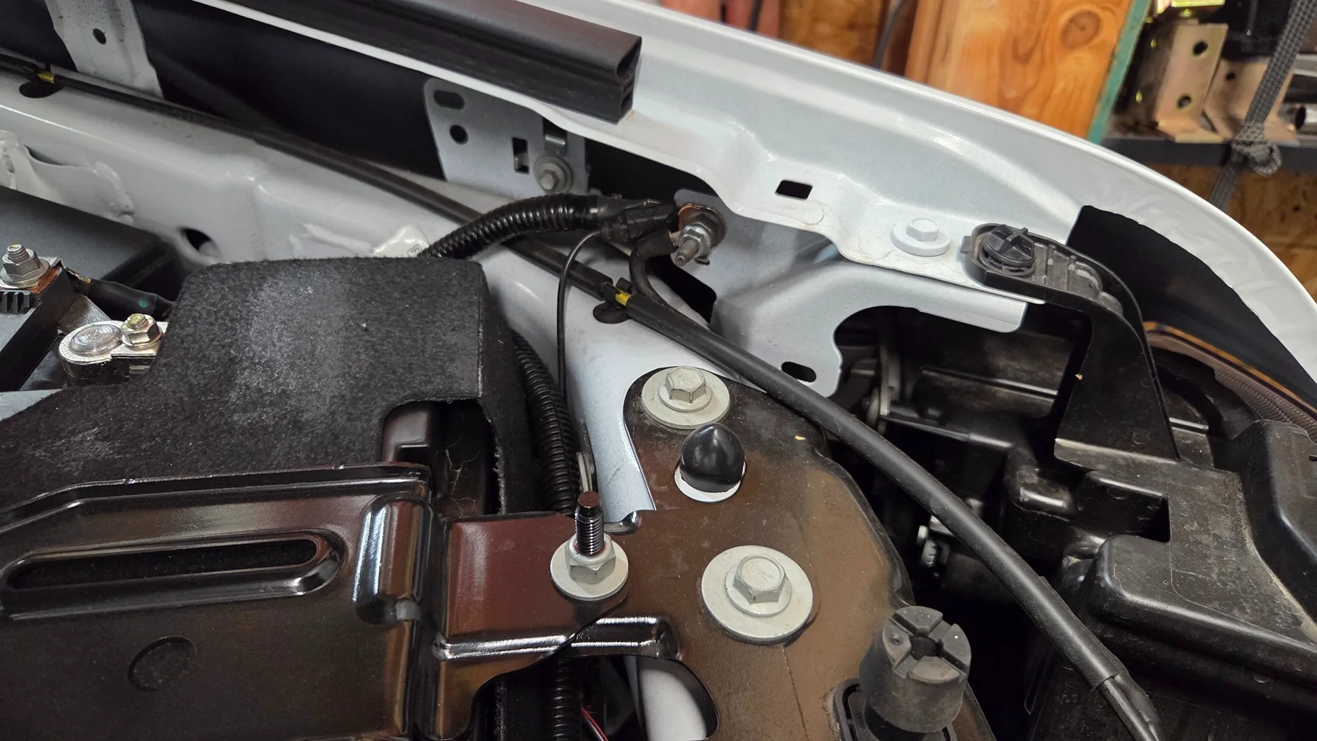

You connected it properly, there is a battery management module attached to the negative post and you want to take current on the frame side of that, otherwise the BMS won't see the current flowing out of the battery and it won't know to tell the alternator to step up the pace.

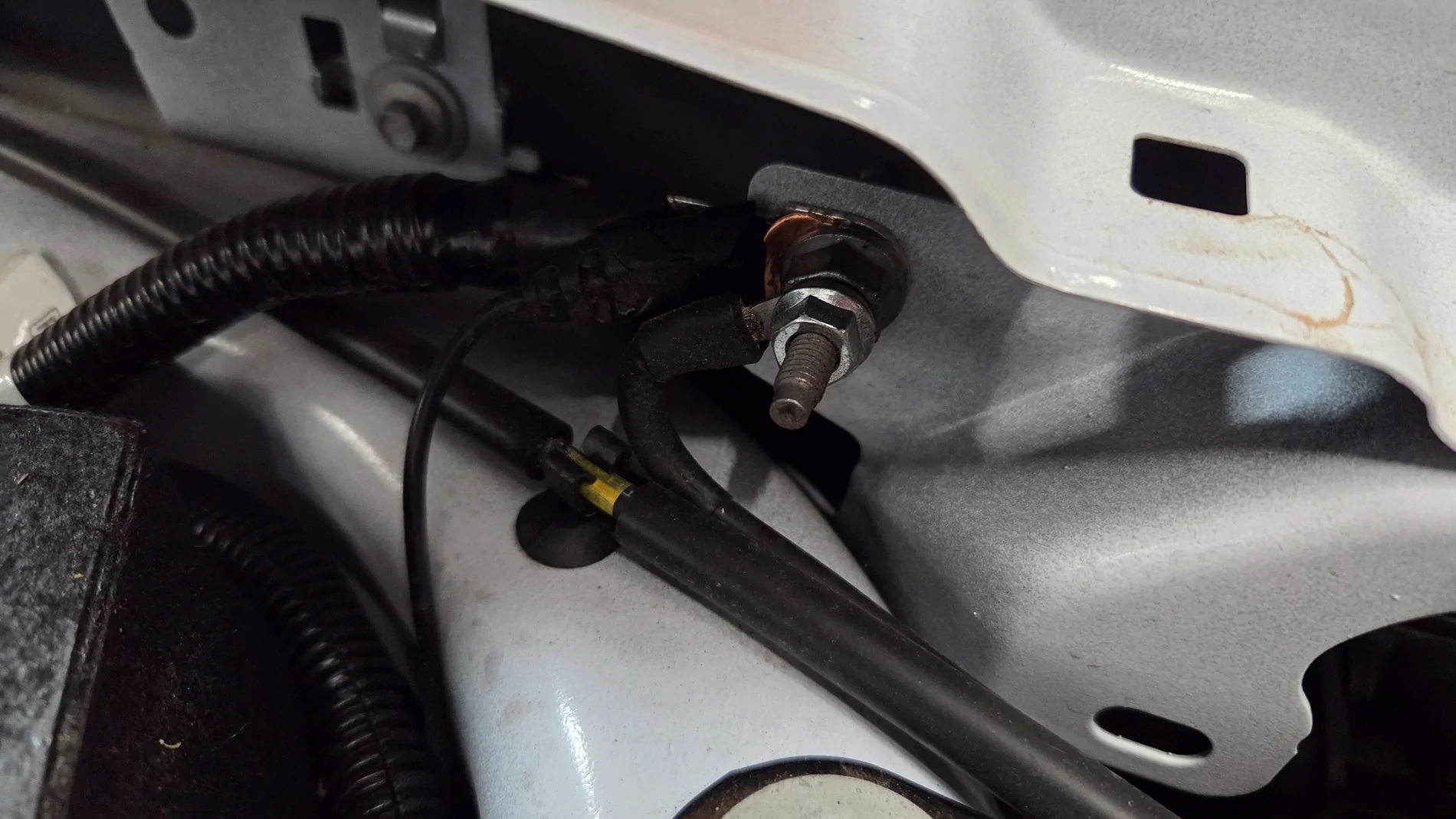

Did you have the engine running when using the compressor? What compressor do you have and do you have the specs ie current draw and CFM at various pressures? Did you have a good, paint free connection on the frame? Maybe try the fender bolt right near the battery where the ground cable connects.

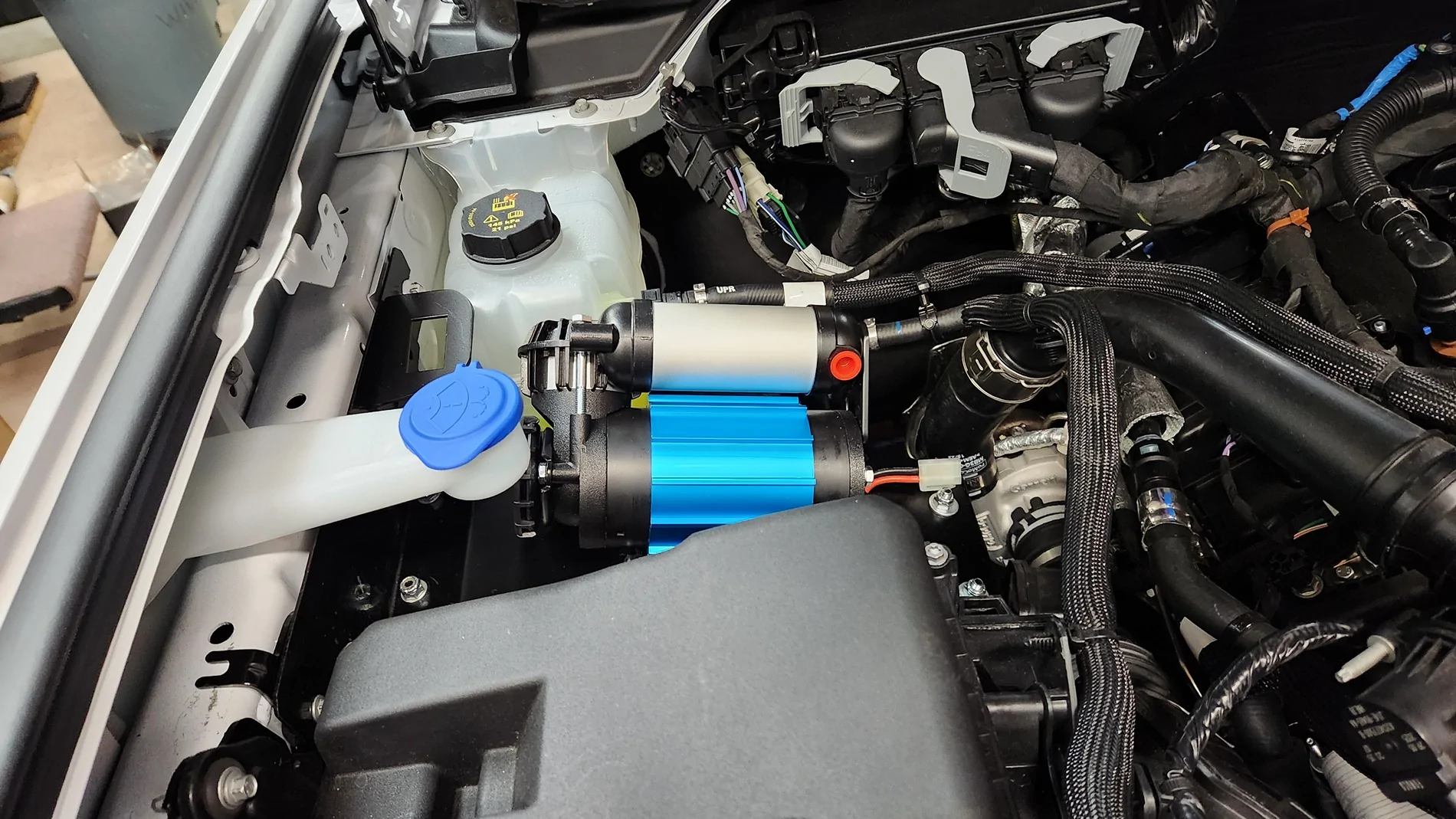

I'm using an ARB single connected to the factory ground cable. There a paint free stud with a nut on it right there you can use. Have not had an issue. Granted my ARB single is not that greedy on current, and I have stock tires so only a few minutes of run time to air up.

Yes - Engine was running for all aspects of connection, fill up (power on) and power down and unclip. yes - I used that connection point...
So it's a SmittyBilt 2.54 cfm compressor, 30amp fuse (although I can't imagine it actually pulls that in a steady state?).

My ARB single draws up to 25 amps under load and is fused at 30 amps. I doubt yours is much different.
