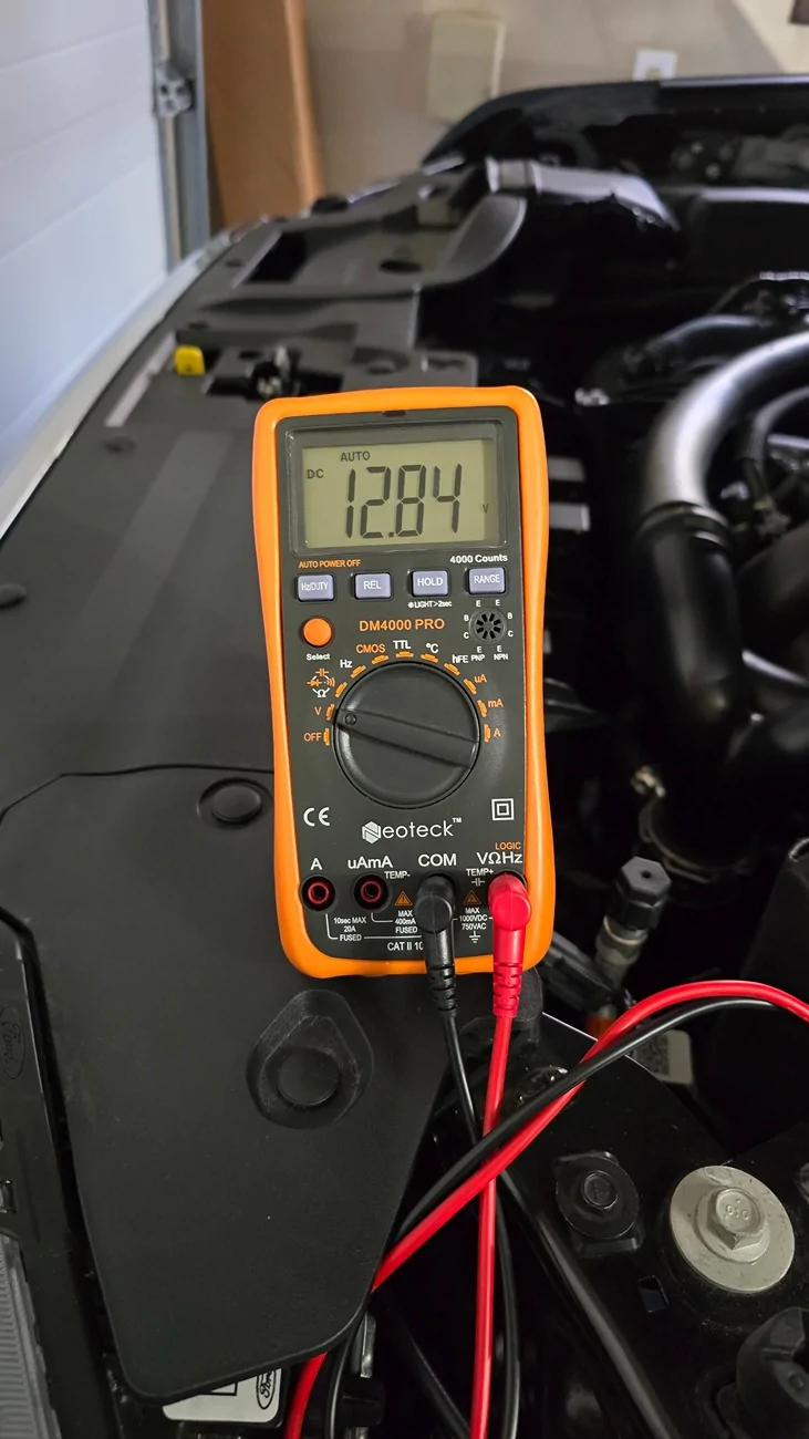

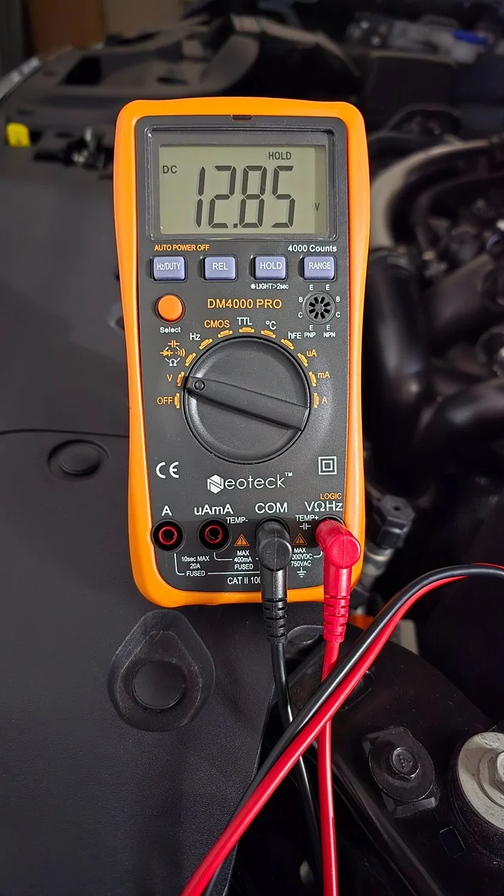

Here is what it looks like since last night... was at 12.81 when i got home its now 12.70 so not too bad after about 12 hrs
