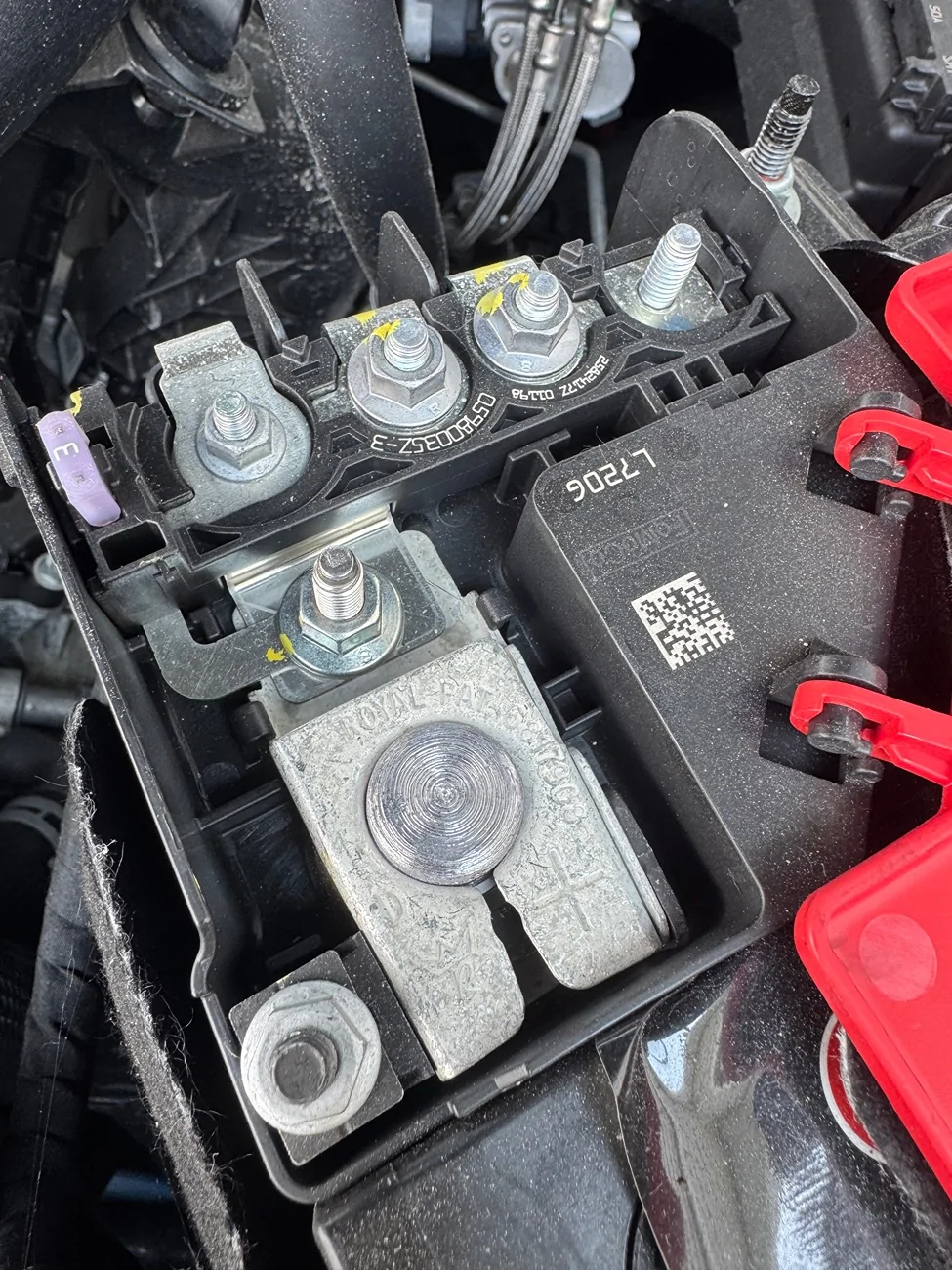

Hello, I am wondering if all the 2024-26 Ranger Raptor US models with the 3.0 twin turbo engine all have an AGM battery?
I’m trying to charge it slowly with a 2a NOCO genius and want to be sure before I connect it.
thanks all!

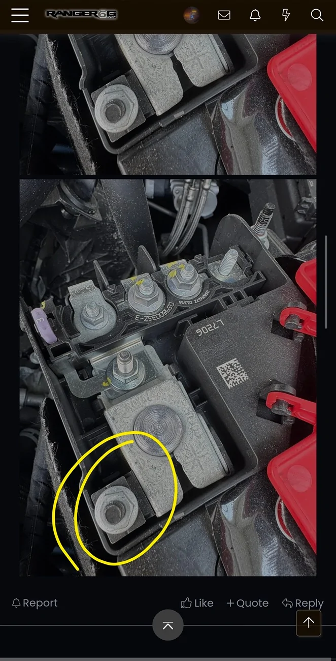

this one is the positive post nut. and they are 94r agm
Ford Ranger Battery type on the 2024 Ranger Raptor Screenshot_20260812_150225_Samsung Browser

Thanks! Is it OK to install my battery charger ring terminal to that bolt you circled so I can charge the battery?
I put my noco clamps on both posts to charge mine. so I cant see why not.
