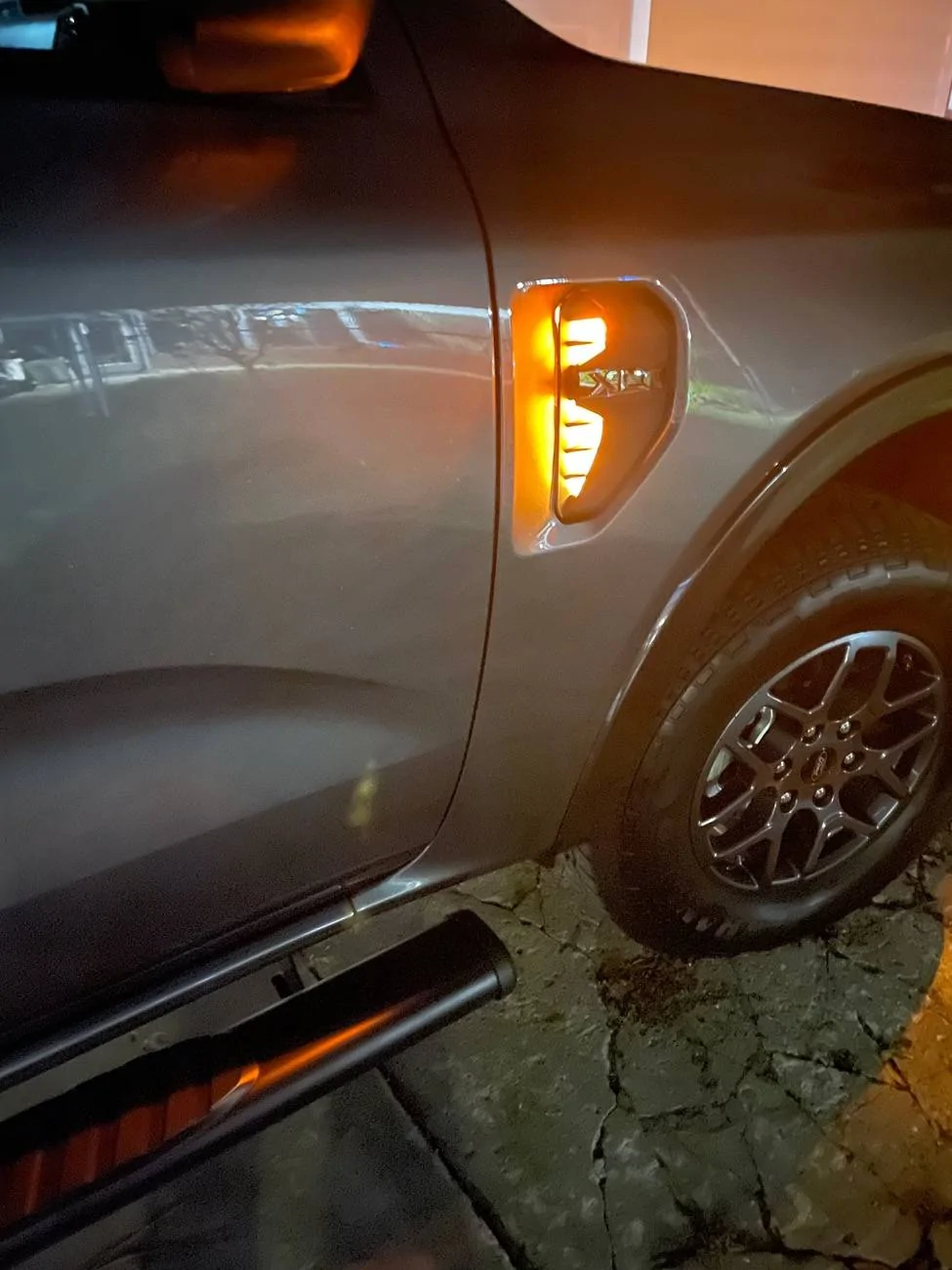

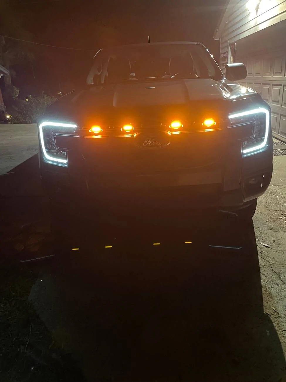

I bought the grill lights but didn’t want to drill 4. 1/2” holes in it. I dropped them down a row and used trim tape. I am pretty happy with them, but the week after i bought them they introduced the plug and play harness. Literally the day after i hooked them up I got the email. I also got the fender badge lights. I like the way they look. The carbonized gray XLT has no lights on the side between the front fender and tail lights.

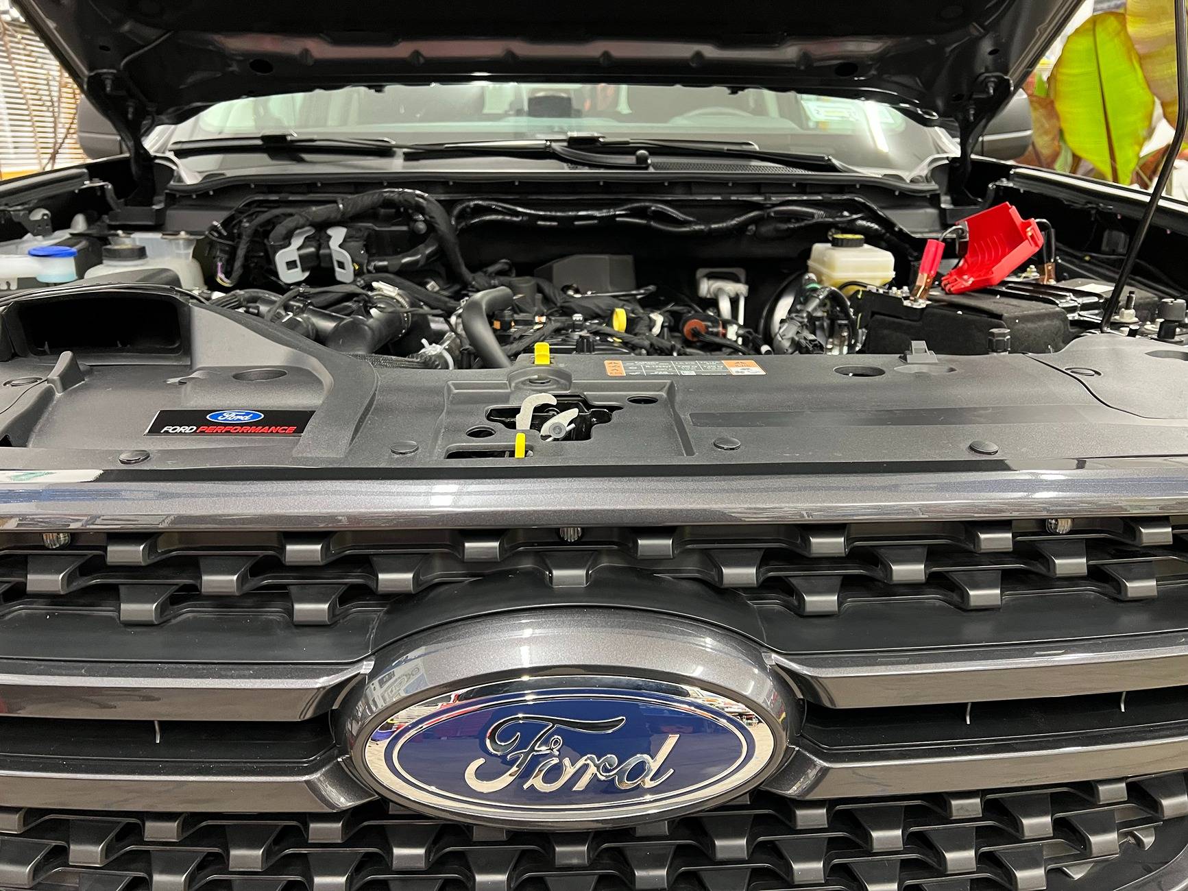

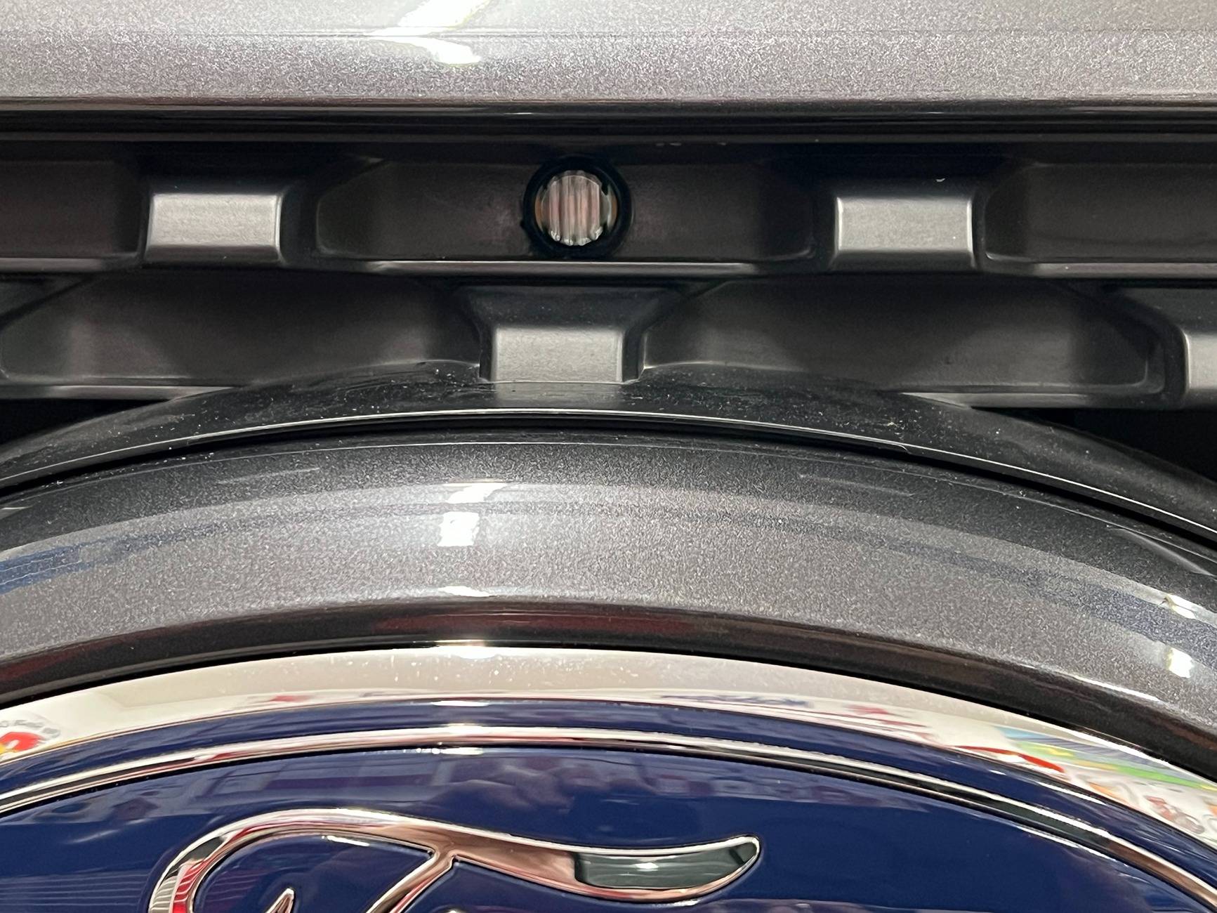

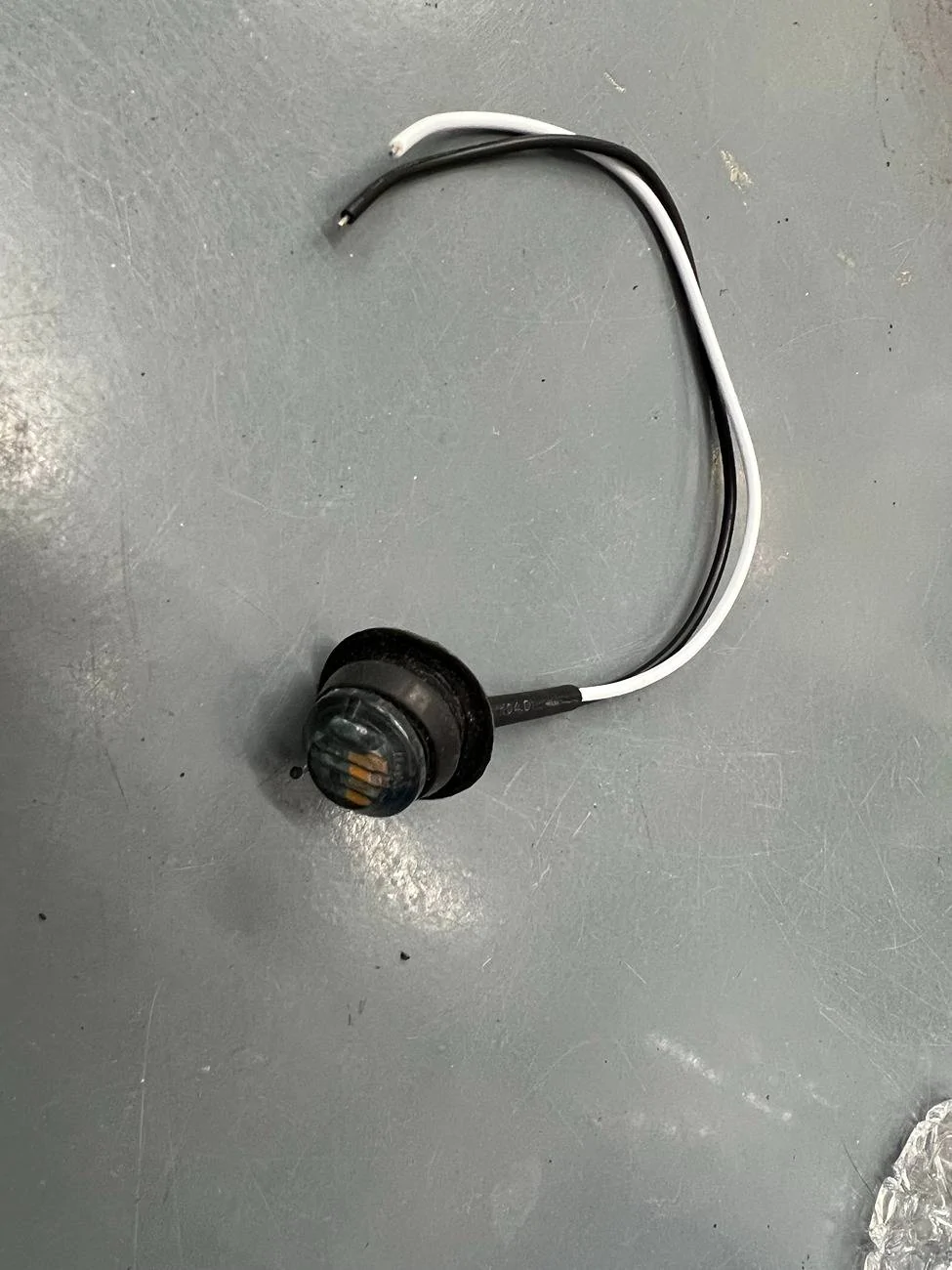

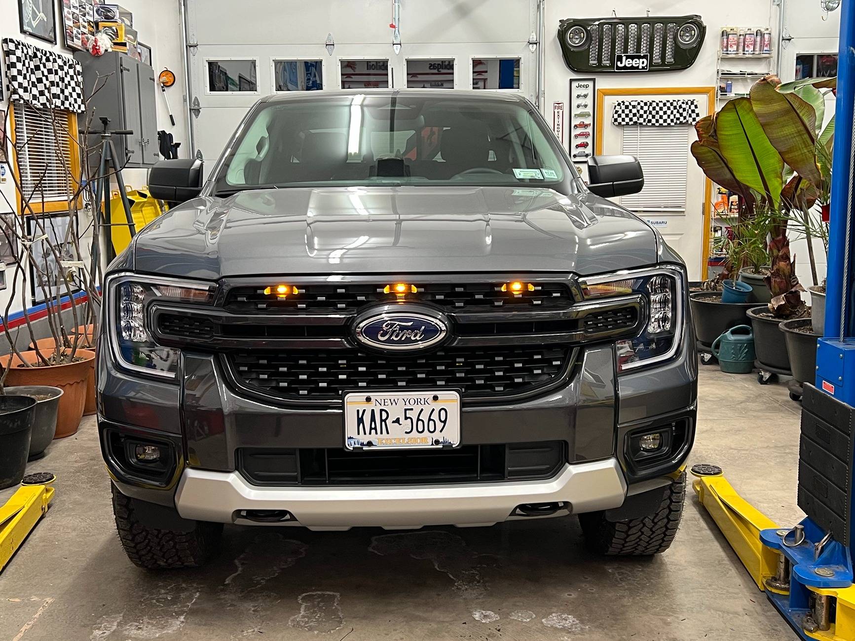

I got the lights installed and the wires properly routed. They look pretty good and the music sync is actually kinda cool. Only issue I have at this point is that they tell you to use the fuse tap on #34 which is hot even with the key off. I need to find a slot that is switched to tap into. Any suggestions?
Moved the fuse tap to #35 and it works! Overall, I am pretty pleased with it, but I might recommend people waiting until they have a dedicated RANGER kit with appropriate instructions.​
I installed grille LED's today. I used spare fuse #139 5 amp to power them. The fuse is switched so only hot with key on which is what I wanted.
