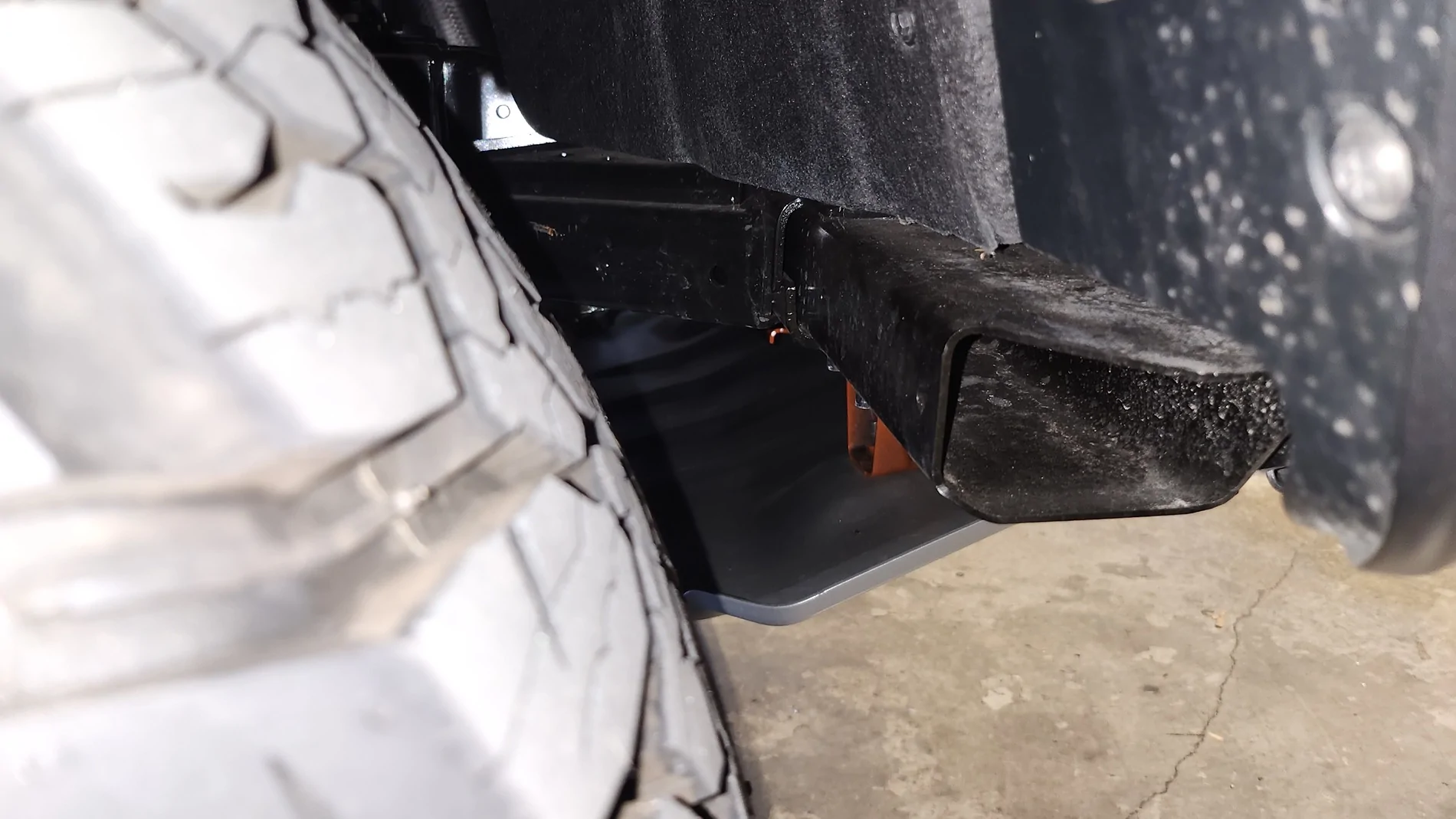

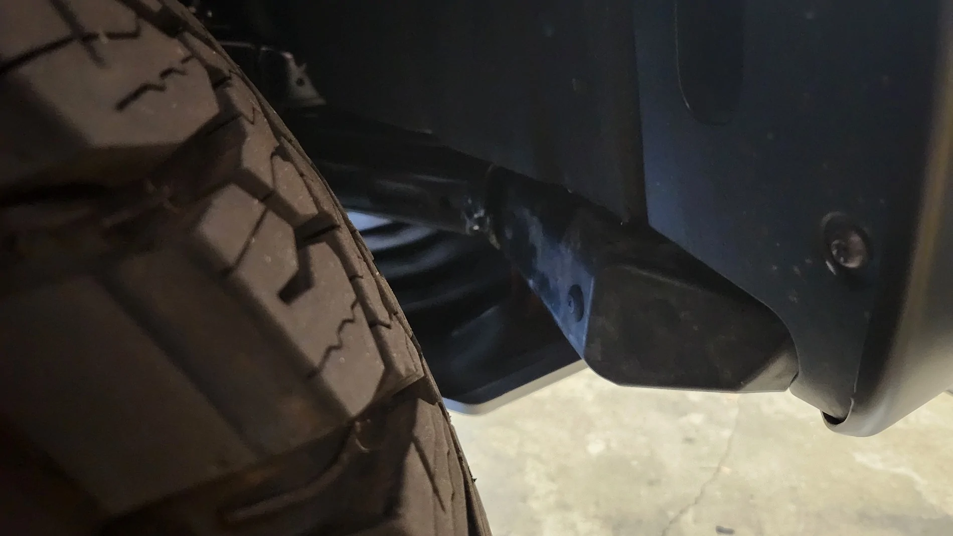

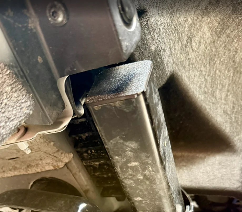

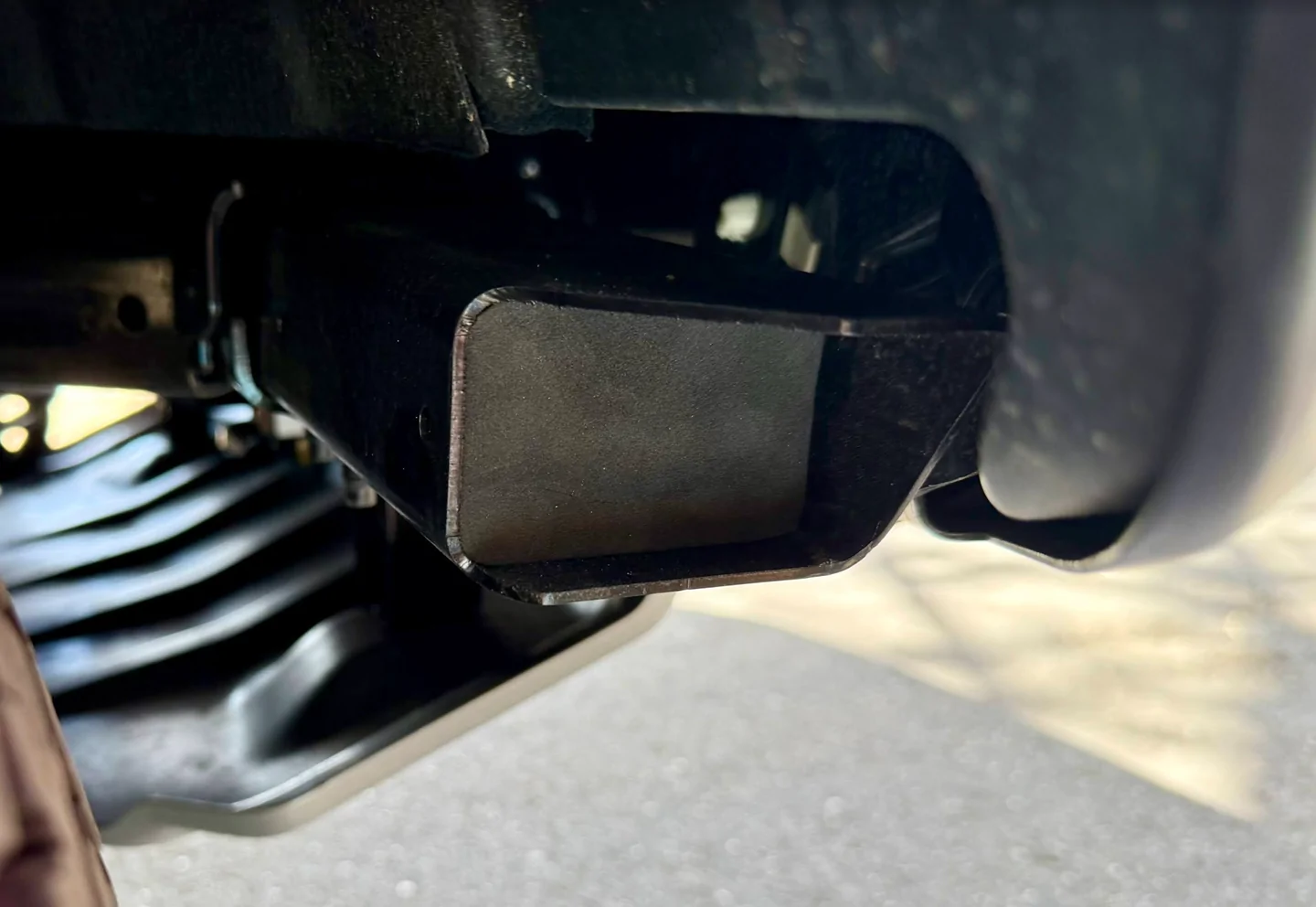

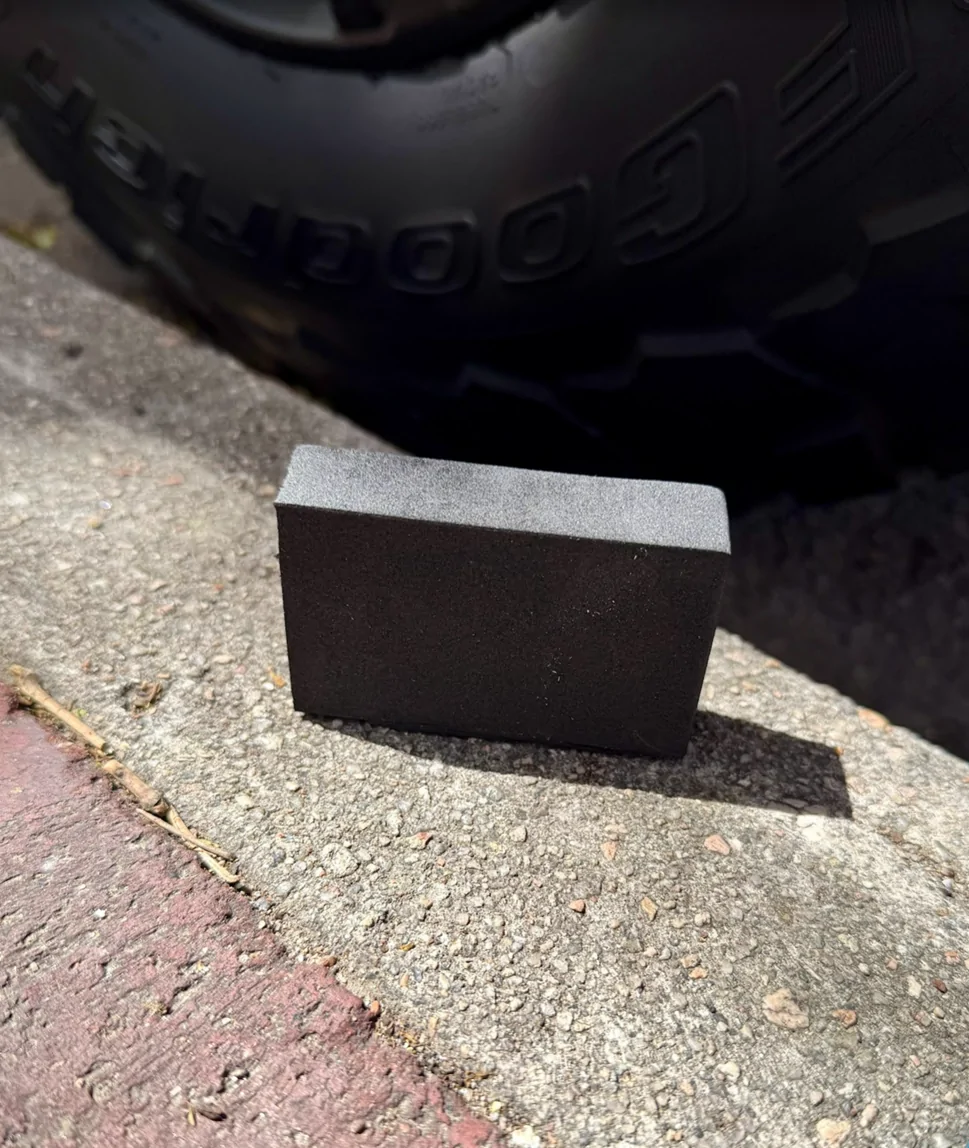

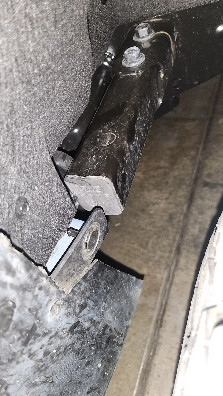

Until I find a better alternative, I cut some pieces of closed cell EVA foam and stuffed it into the front crash bars for now. No idea if it will hold up to the environment, but for now the foam is cheap
Ford Ranger Anyone know if there is crash bar / frame plugs for Ranger Raptor? rraptor_crashbar_plug_front_2
Ford Ranger Anyone know if there is crash bar / frame plugs for Ranger Raptor? rraptor_crashbar_plug_front_1

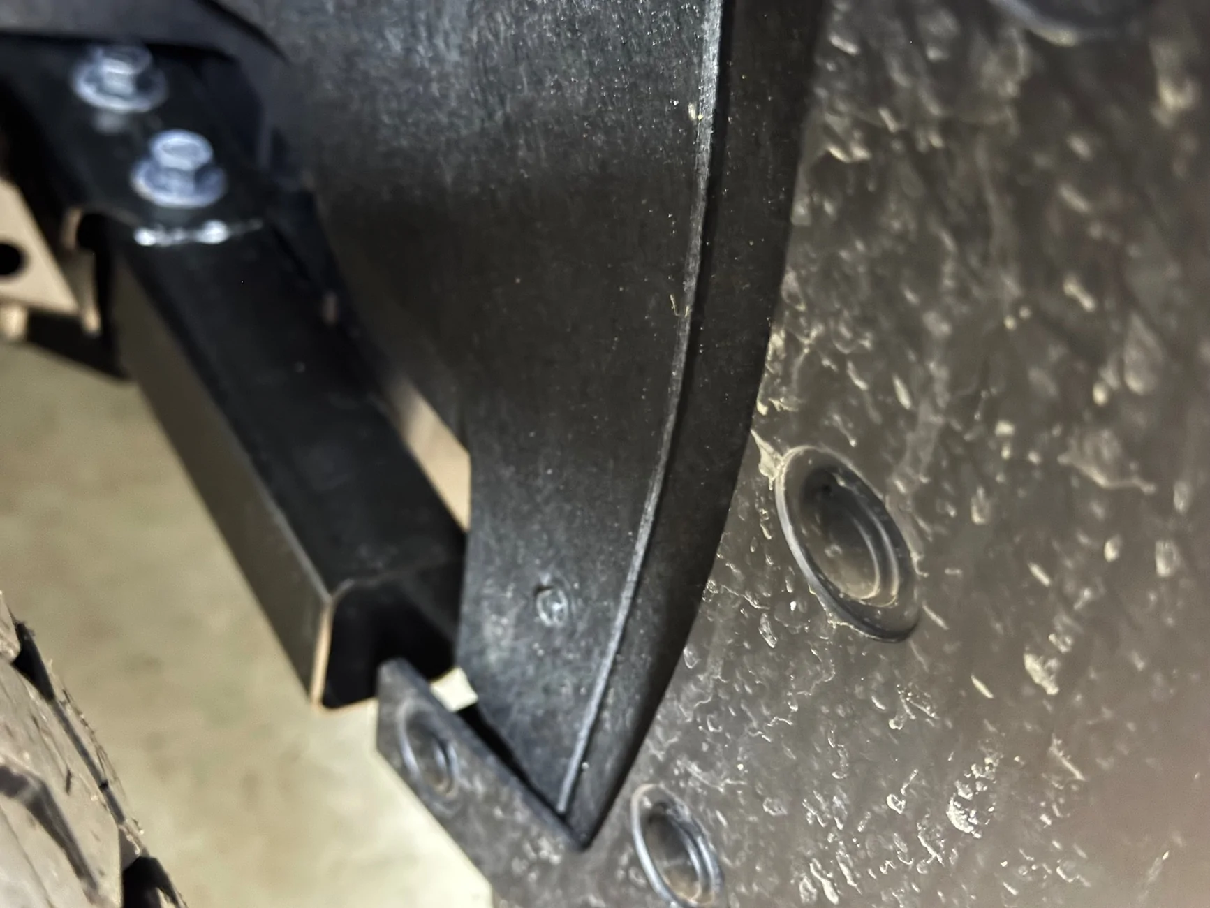

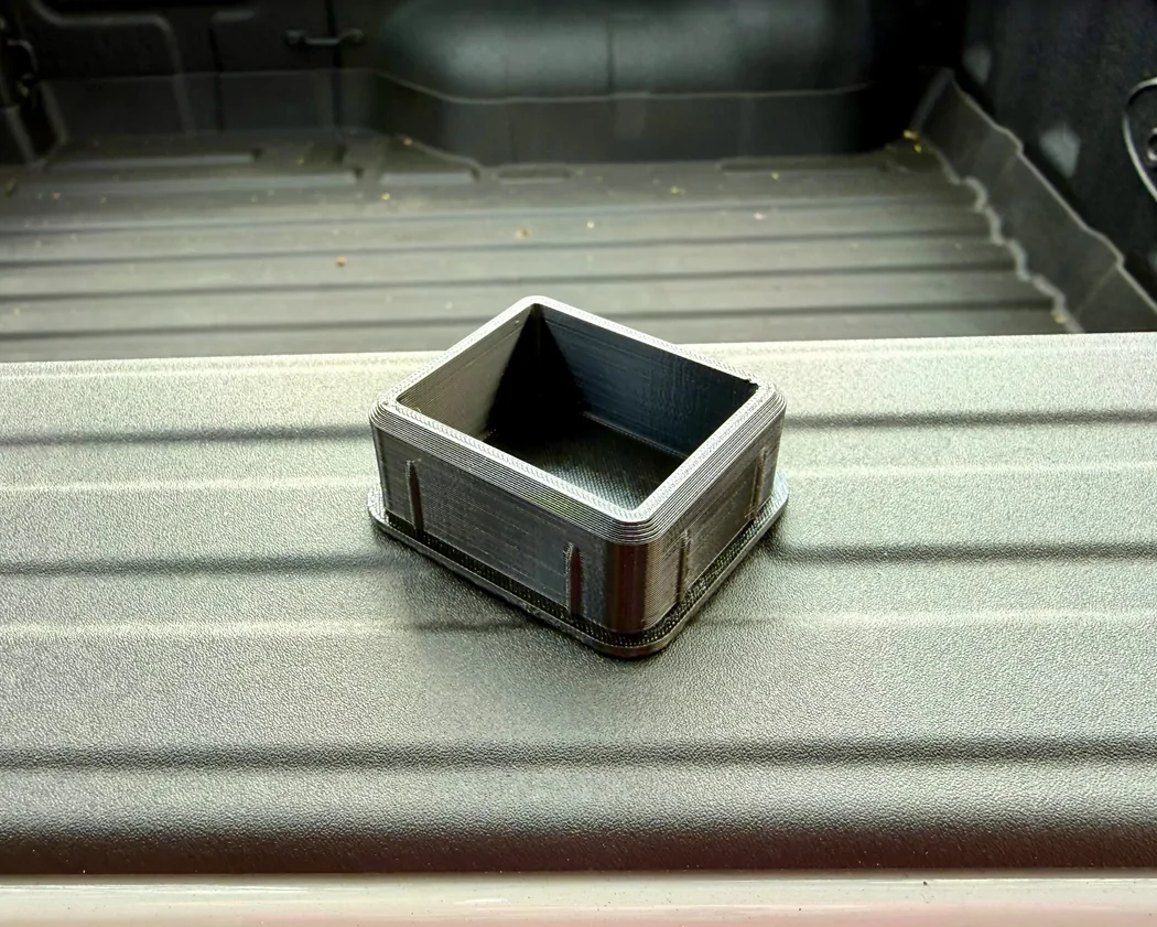

The rear one is a lot simpler so I am currently 3D printing some plugs in TPU... I'll post once they are done printing.

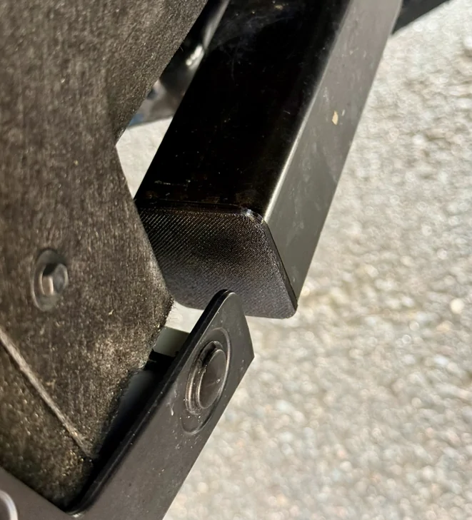

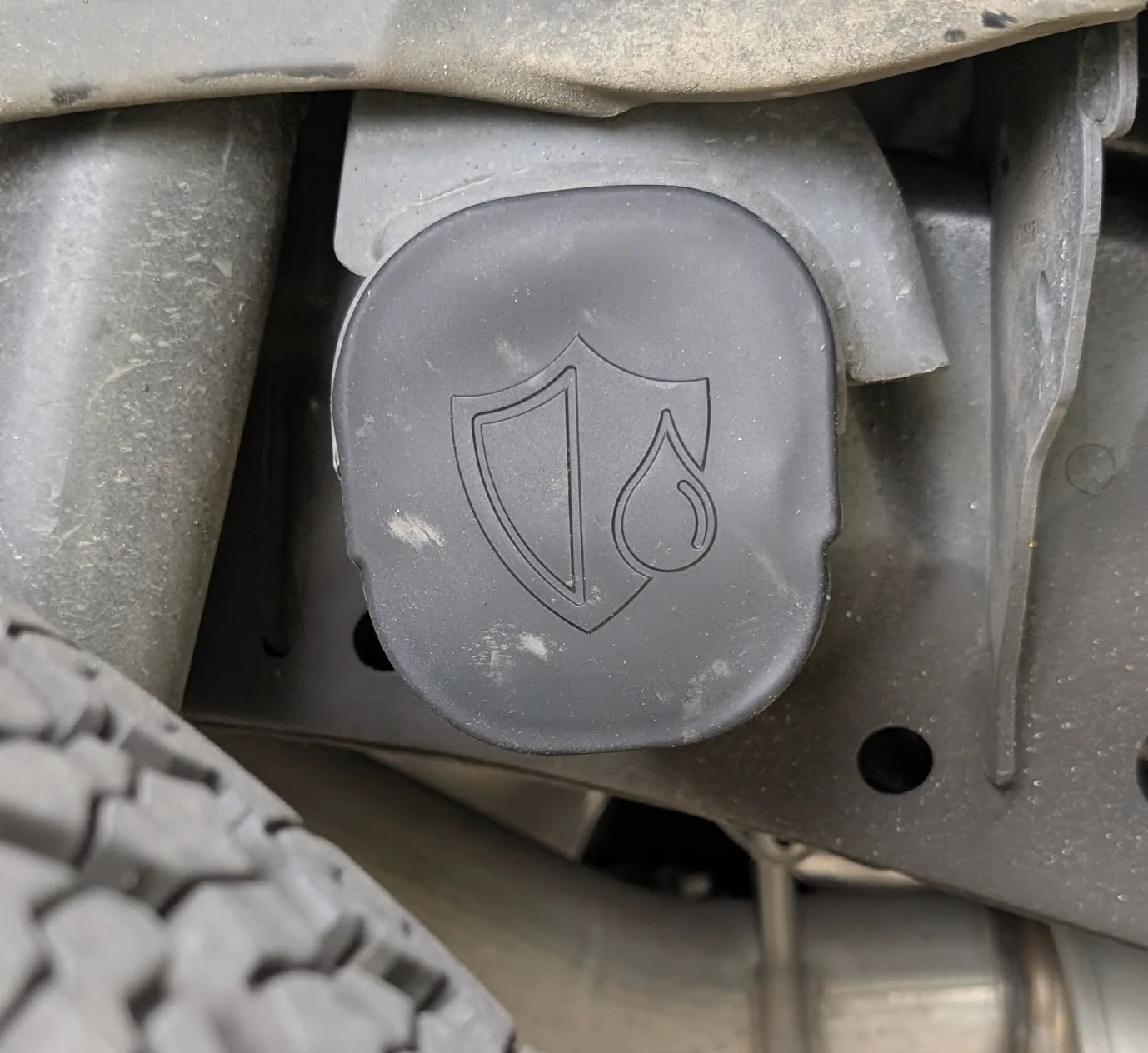

Finished up one of the firewall side plugs in TPU. My first iteration was a full 5mm too narrow. I guess I don't know how to use a ruler :like:
Second version fits great
Ford Ranger Anyone know if there is crash bar / frame plugs for Ranger Raptor? ranger_crash_bar_plug_1
Ford Ranger Anyone know if there is crash bar / frame plugs for Ranger Raptor? ranger_crash_bar_plug_2
Ford Ranger Anyone know if there is crash bar / frame plugs for Ranger Raptor? ranger_crash_bar_plug_3
