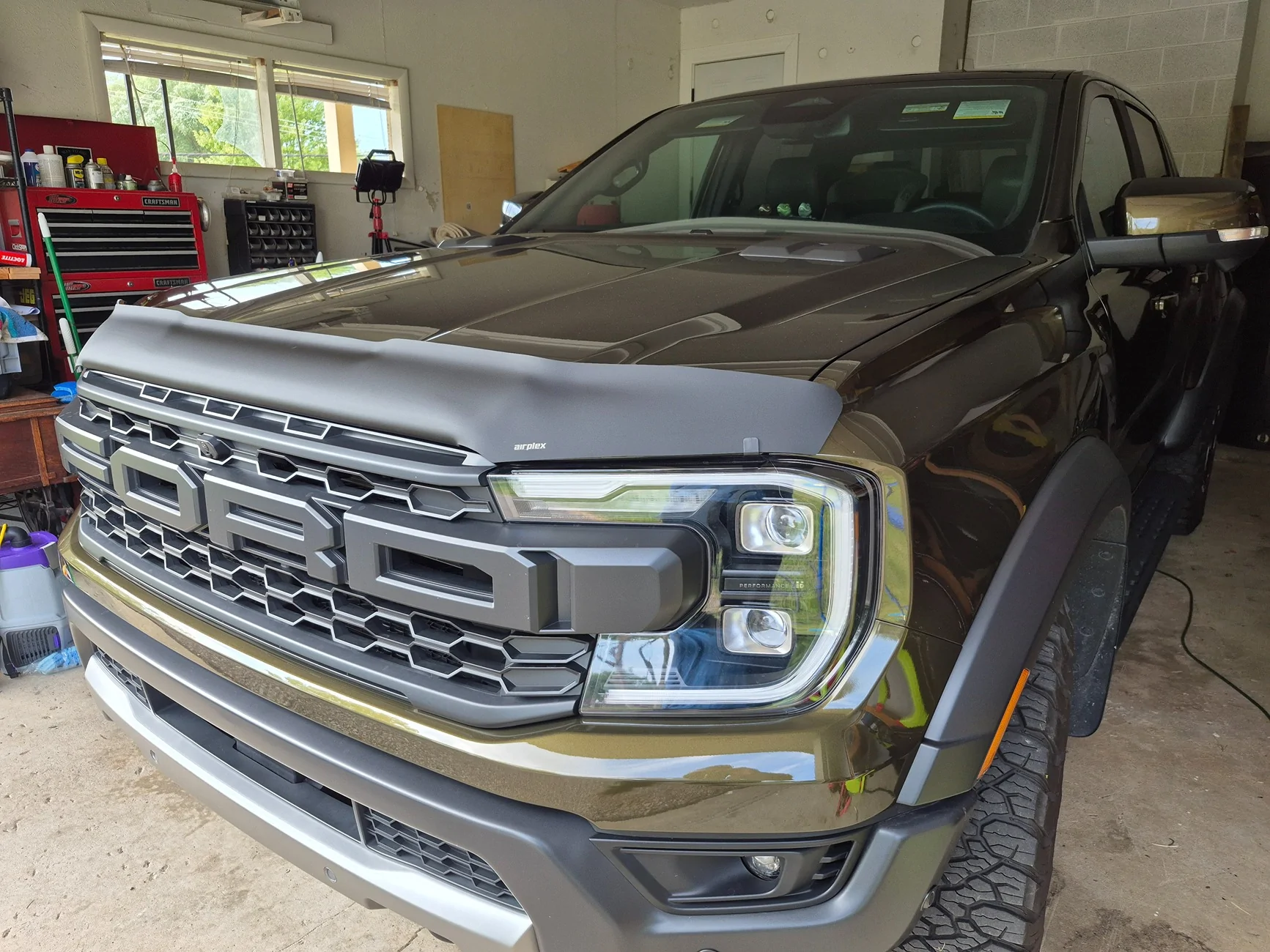

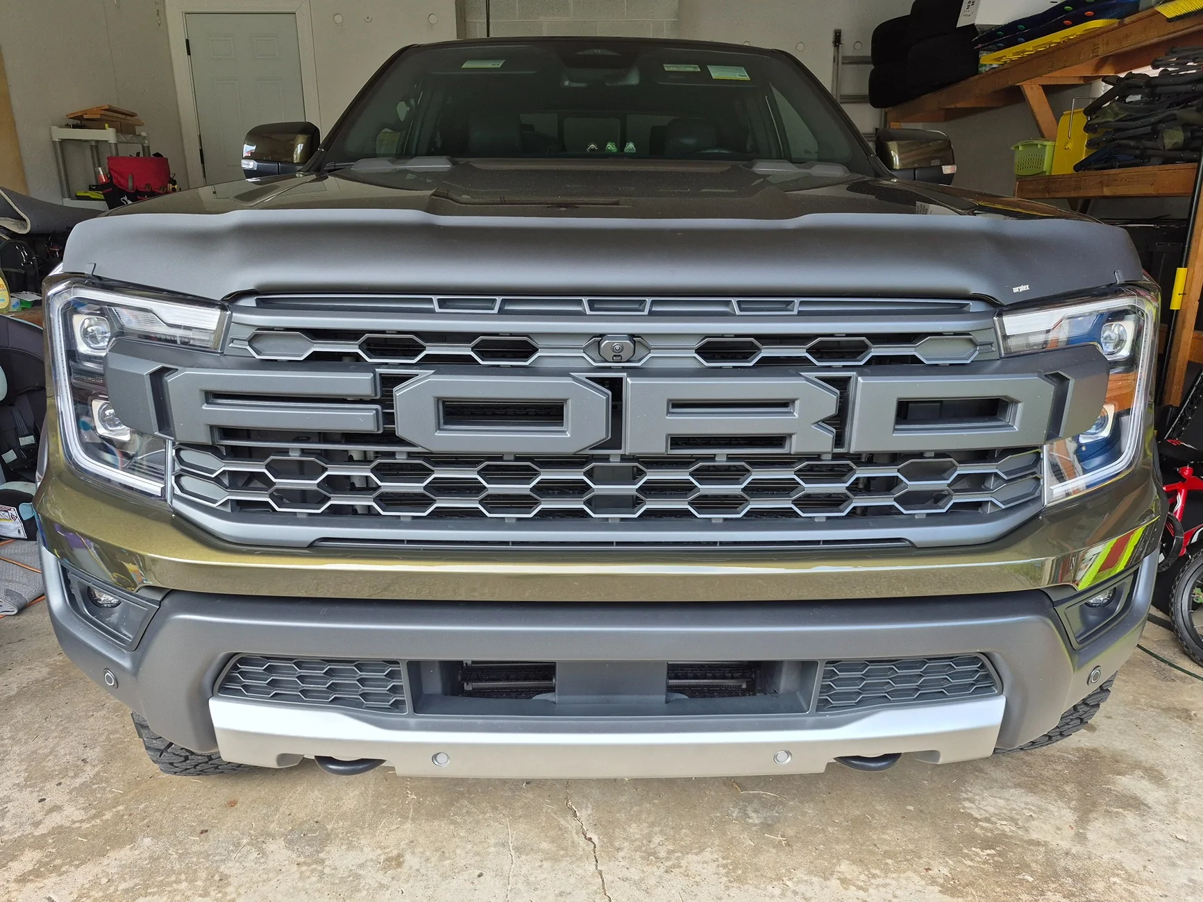

While I wasn't expecting it, the color match to the stock "charcoal" colored OE polymer on the grille / fenders is a VERY close match to the stone guard from Airplex. It is a matte black, but it has a bit of an egg-shell sheen that makes it look more "charcoal grey" than you would think, it's almost an OE look.
I love it. It's also quite robust, the material is of similar plastic type to the grille and it's about 2mm thick, so it's quite robust. I would not expect it to crack for break unless you get into a actual collision (which you'll have bigger issues than a cracked stone guard). I think this is "the stoneguard to get" for this truck.
It also has the winglets that cover the front edges of the fenders right where most of my rock chips are, so it should reduce them significantly. You could also put this over PPF if one wanted to. Install is also removable, uses two push pins with screws (which expand behind the mounting hole), then two clips at the ends with a PPF-like clear pads so the plastic clips don't scratch your paint.
Was a bit of a pain to get on, but once it's on it's very secure and fits nicely, generous clearance from the hood and not really anywhere for water to pool. Although, with any screw-on type if you get a lot of debris from trees, you might need to blow it out periodically with compressed air or a soft brush. Aside from that (not an issue for me), it's a very well designed stone / bug shield.

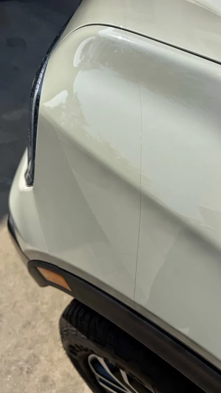

I’ve had deflectors in the past and maybe I own my vehicles too long but I was never really happy with them In the long run.
This time I have factory paint protection film and it covers along the front edge of the hood and down the sides and the area just in front of the rear wheels.
I find the opposite. Over time the PPF becomes obvious and the seam stands out more and more. Also it doesn't do shit besides get torn up when a rock actually hits somewhere hard that would be enough to damage the paint or dent something. I had Xpel on a car and when I removed it after it got covered with little holes, the paint underneath it was in terrible shape.

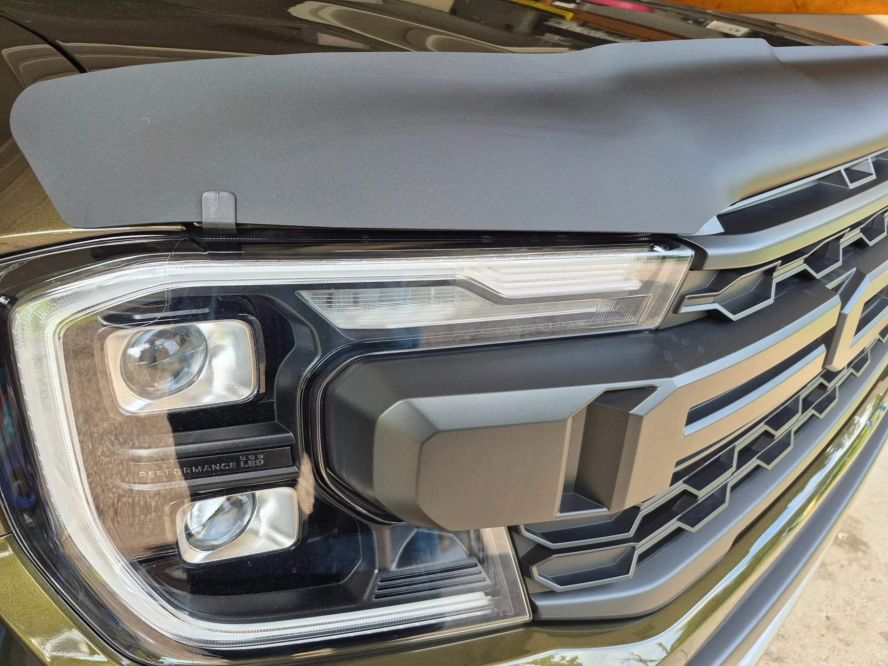

For those wondering about the clearance between the bug / stone guard (in Euro speak, bonnet guard) and the hood / fenders, here are a few pics:
Ford Ranger Anyone Know of Any Bug / Stone Guards for Hood that Go All Way Across? 20250827_063109
Ford Ranger Anyone Know of Any Bug / Stone Guards for Hood that Go All Way Across? 20250827_063123
As you can see, it actually stands off quite a ways from the front lip of the hood, so it's not "curling around the lip of the hood" where it will trap water / debris and rub / vibrate that it would cause paint damage over time.
Ford Ranger Anyone Know of Any Bug / Stone Guards for Hood that Go All Way Across? 20250827_063233

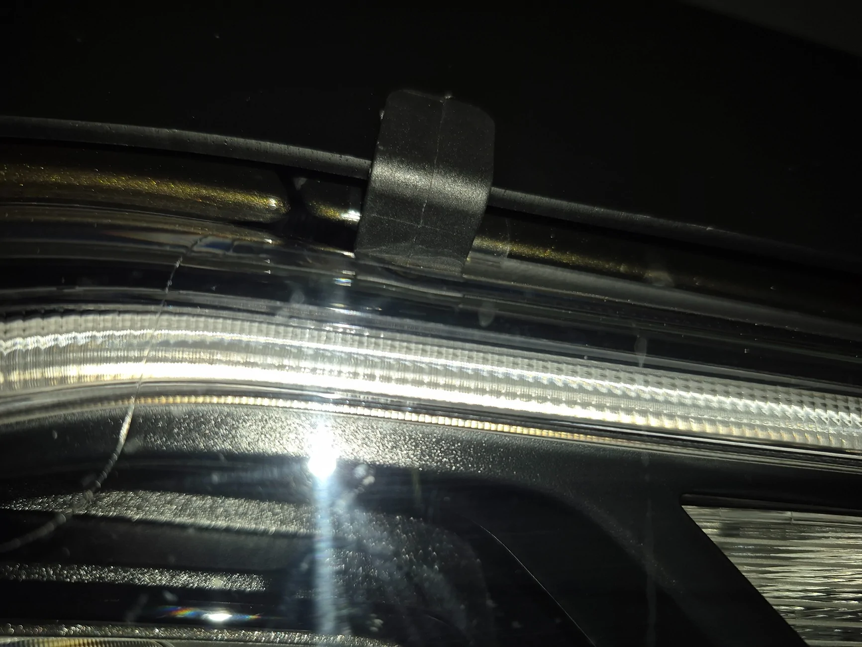

The outer edges are then secured by plastic clips and there is a PPF type film you put over the contact areas that the clips slide over. Obviously, you could take it off once a year and replace the PPF pads if you wanted to do some maintenance / inspection, but I'm not seeing how those would cause an issue.
They aren't exposed to UV since the guard blocks all the sunlight, so the film isn't going to sit in the sun and bake on. Maybe over time it might age and get brittle, but you could just buy some PPF strips for a few bucks and may once every year or two just replace the pads if it's a concern.
The clips are removable, the only possible issue I see with them is that over time, with lots of UV exposure, maybe they could become brittle and crack if you try to pry them open too hard, however the acrylic used is of the same grade that your grill, fender flairs and other exterior plastic moldings are made from, it's quite robust.
Overall, I think this is by far the best designed and best-looking stone guard. Well thought out and designed, a bit of a pain to install just due to position stuff and then trying to insert the expanding push pins and screw in the screws to the push pins by yourself, but with 2nd hand it's fairly easy.
Under the hood section, you remove two push pins from the front hood gasket / seal (2nd ones from outer most edges), slide the edge of the guard under the gasket, insert the push pins and tighten down the screws so the pins expand in the hole and hold it all in place. Easily removable if necessary.
