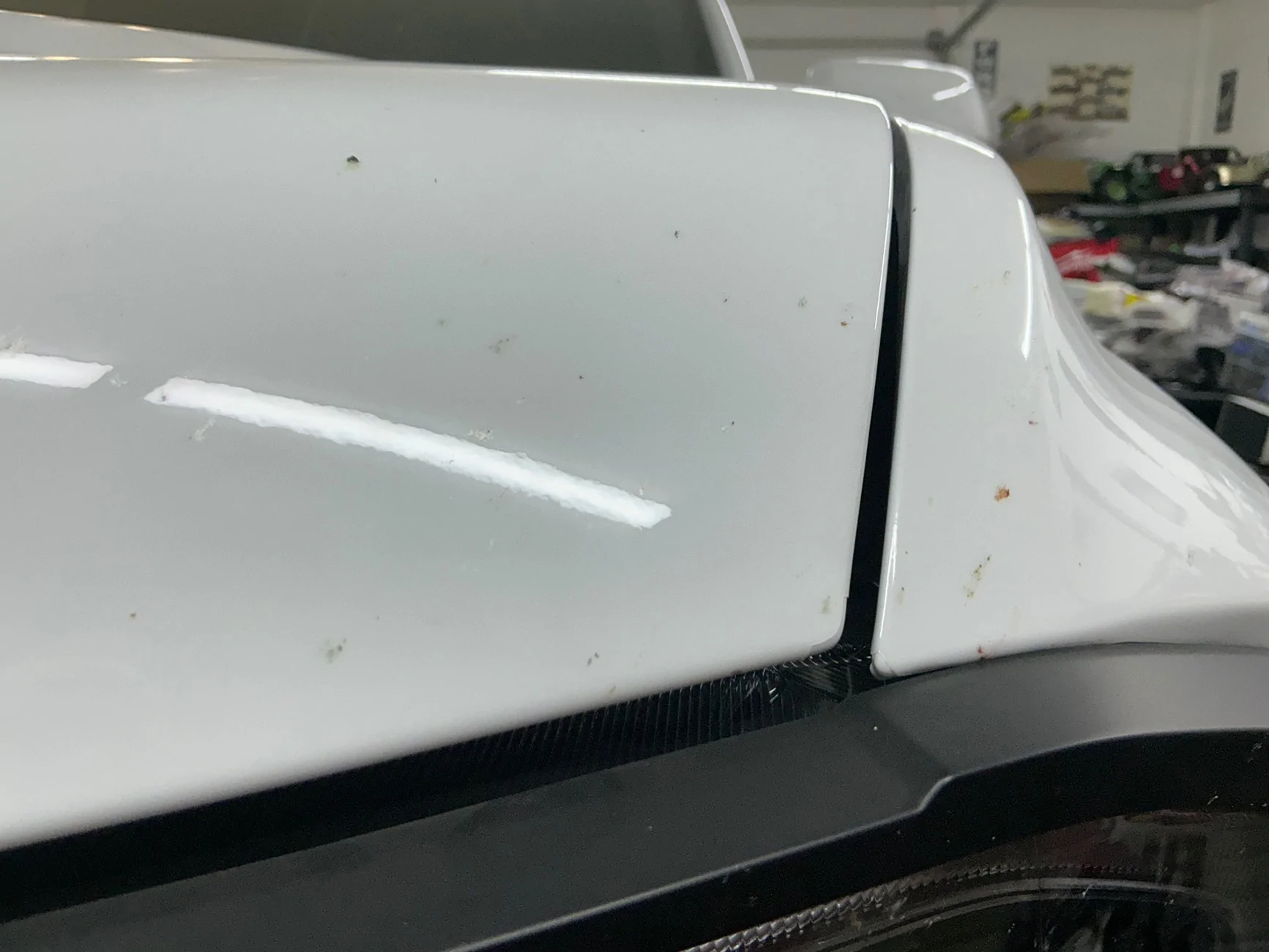

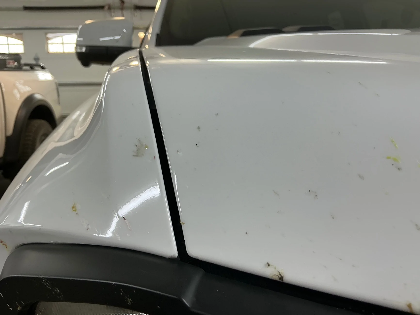

My 24 is pretty spot on and rarely moves in the wind, the alignment looks really good both sides
Its tight and seems very buttoned down.

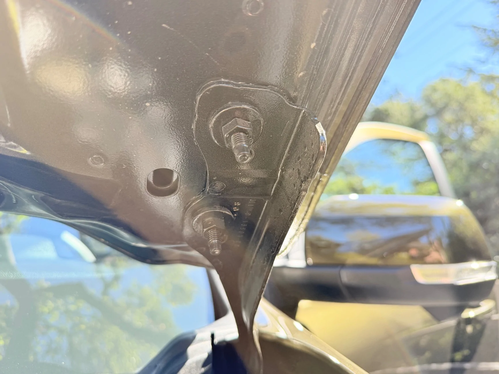

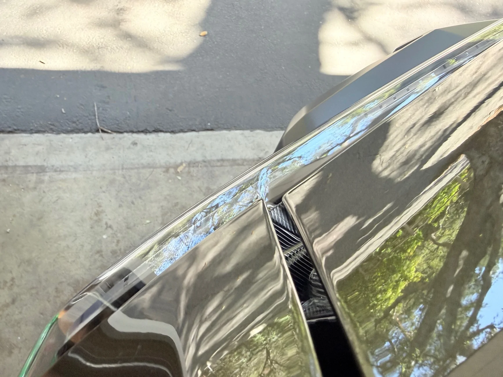

After yesterday’s little 3 hr road trip in the 25 and seeing the hood bouncing around like crazy to the point a couple times I was a little concerned it might launch off the truck. I decided I needed to try again to figure this out.

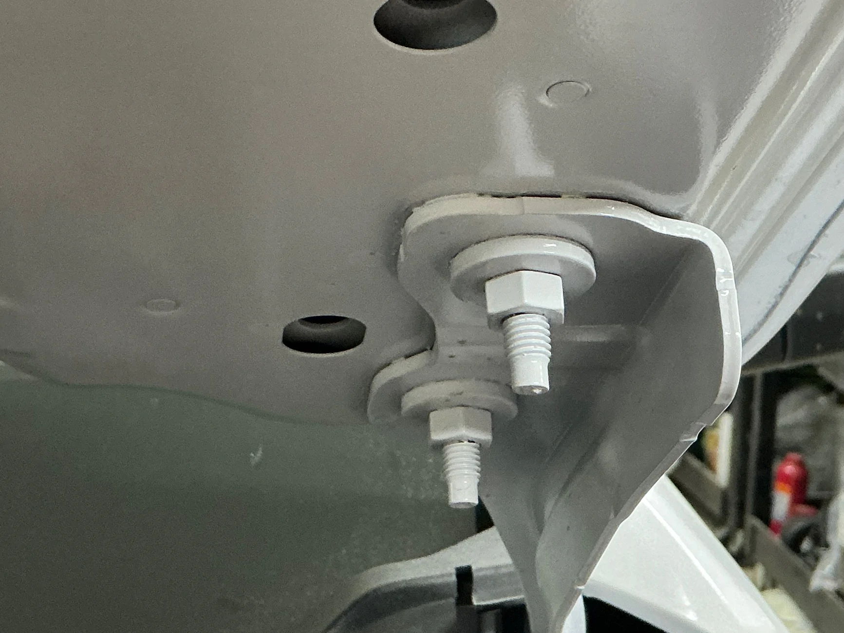

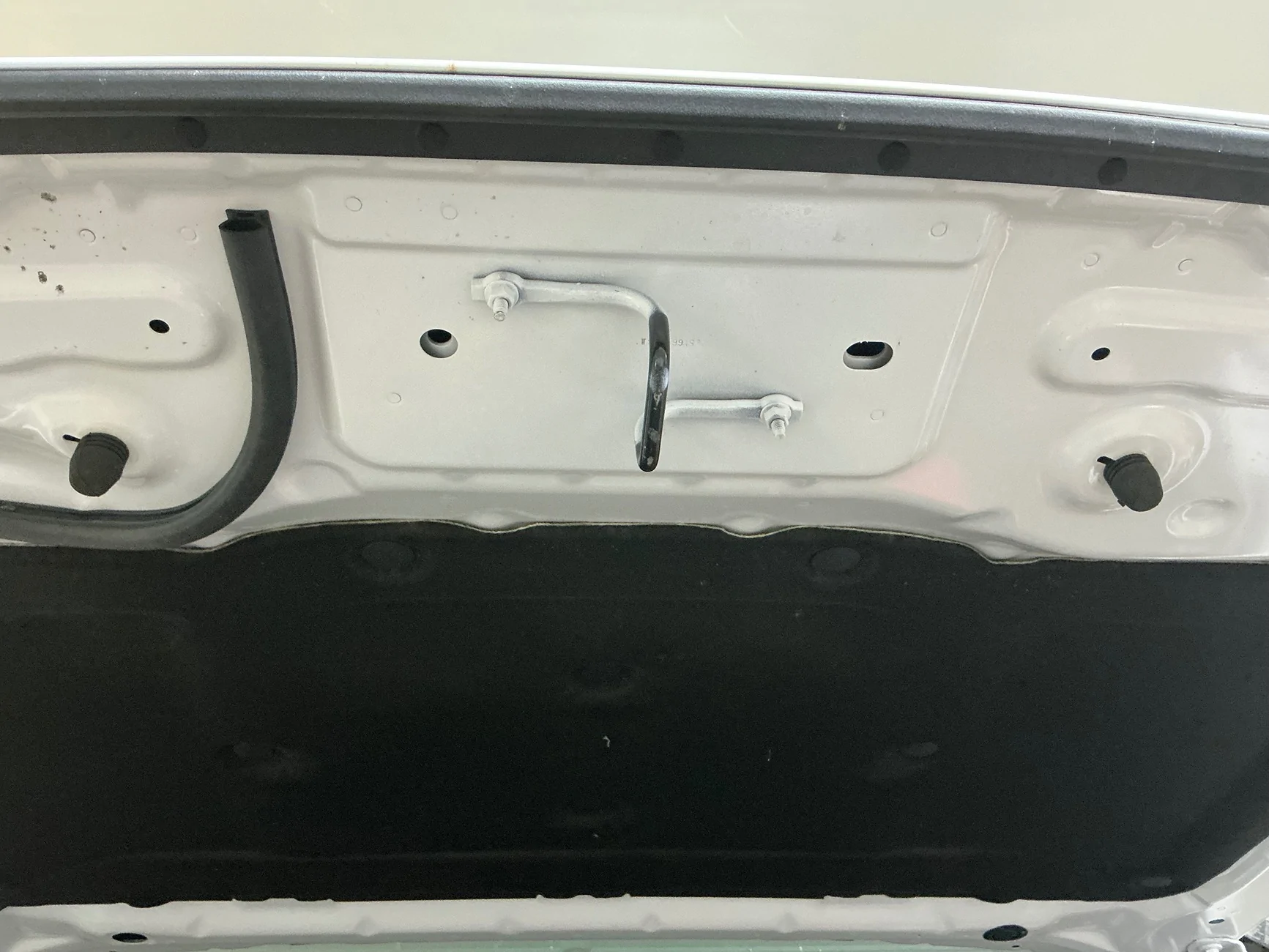

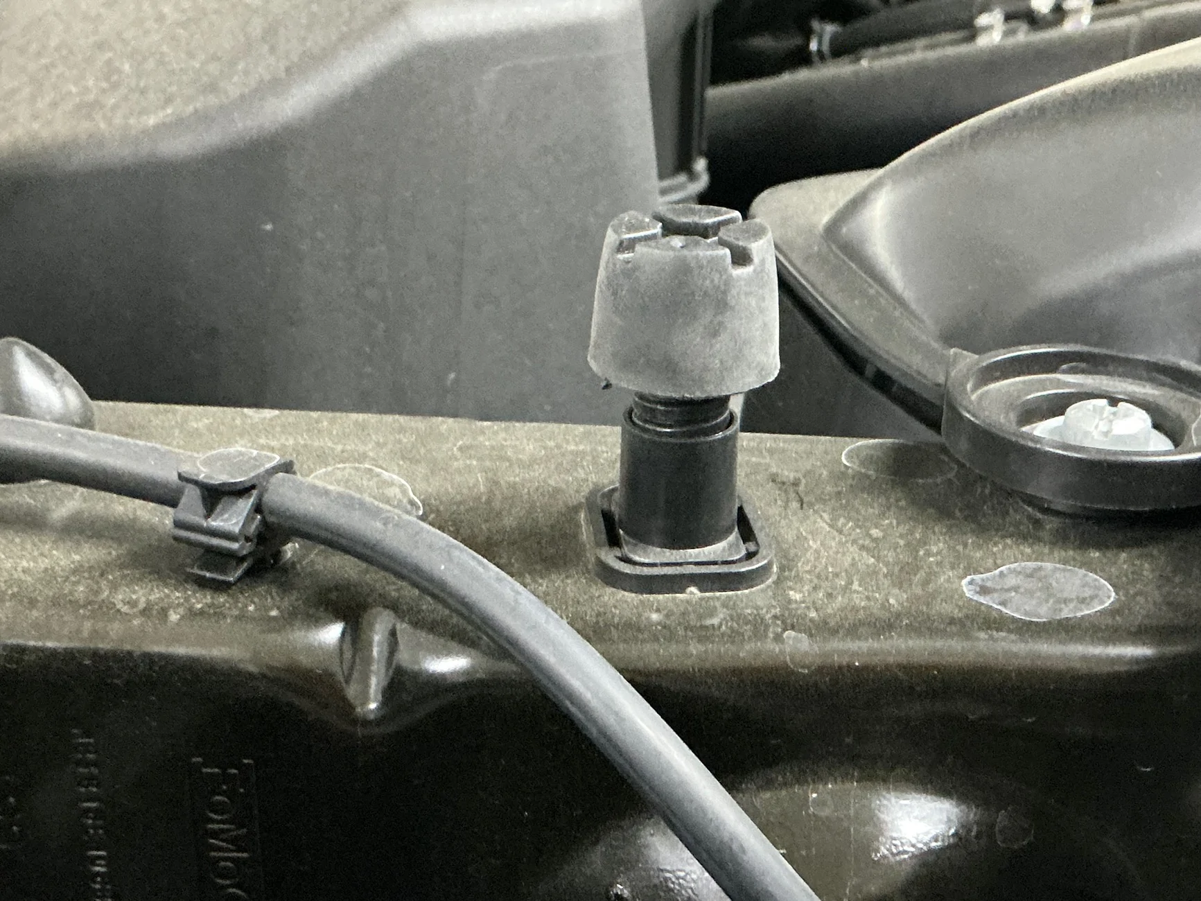

Last night I did spot these adjusters on the hood itself.

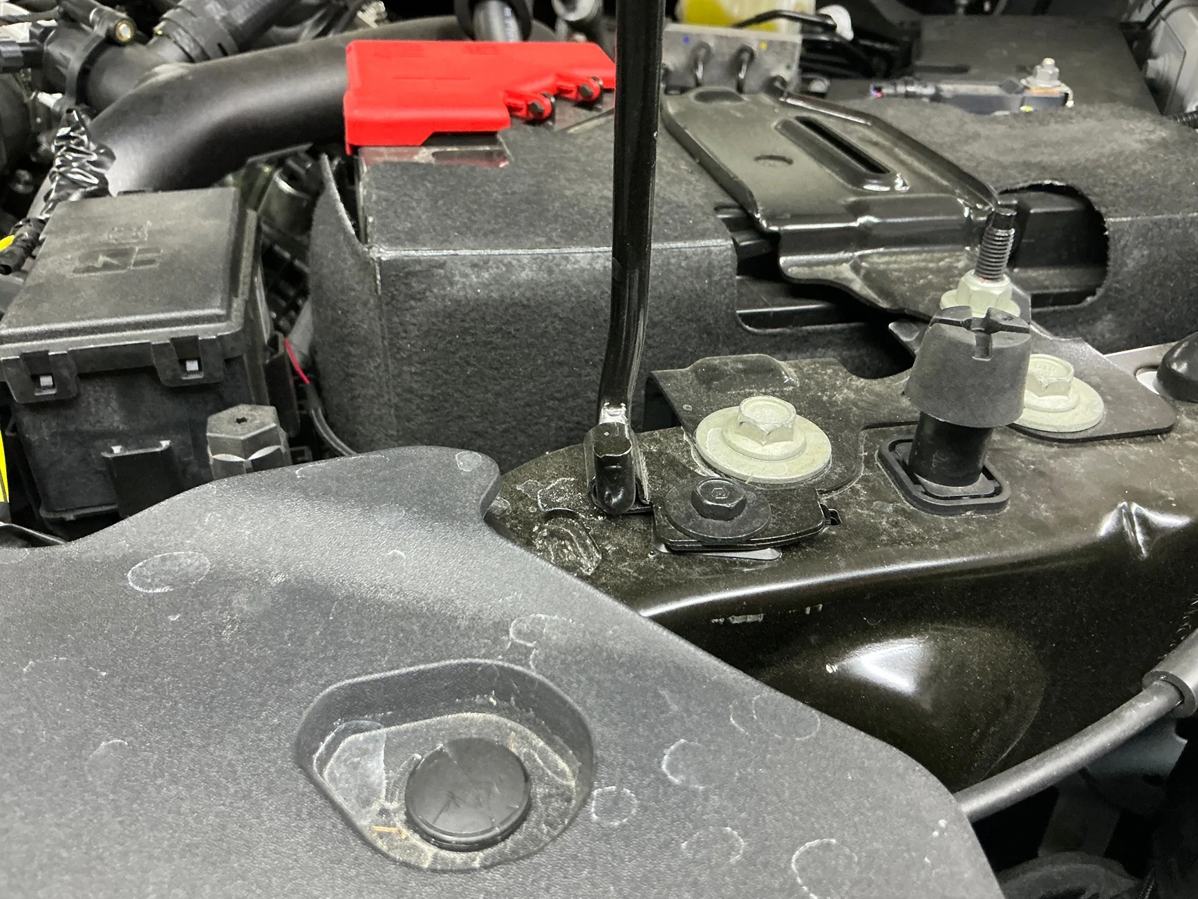

After countless tries open adjust close test , repeat.

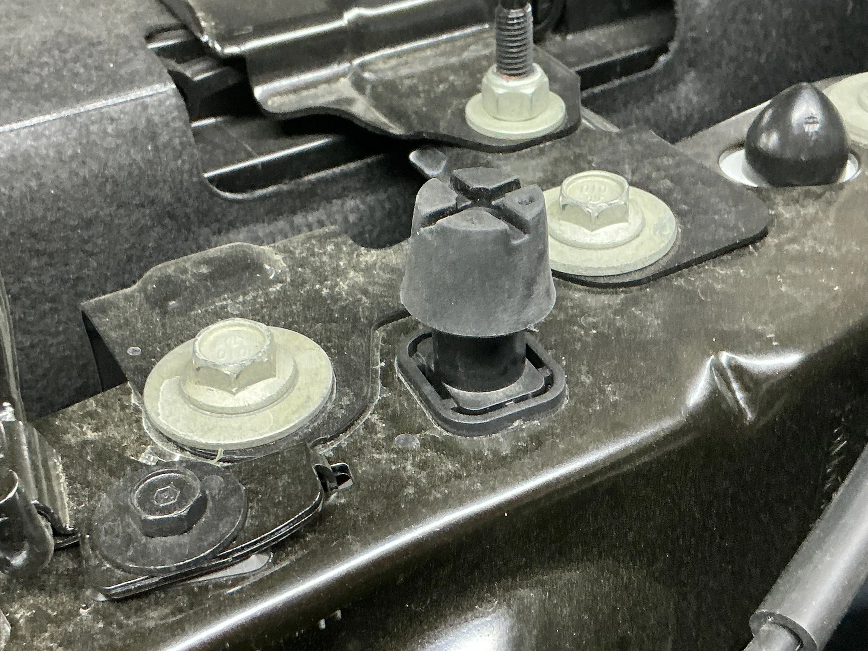

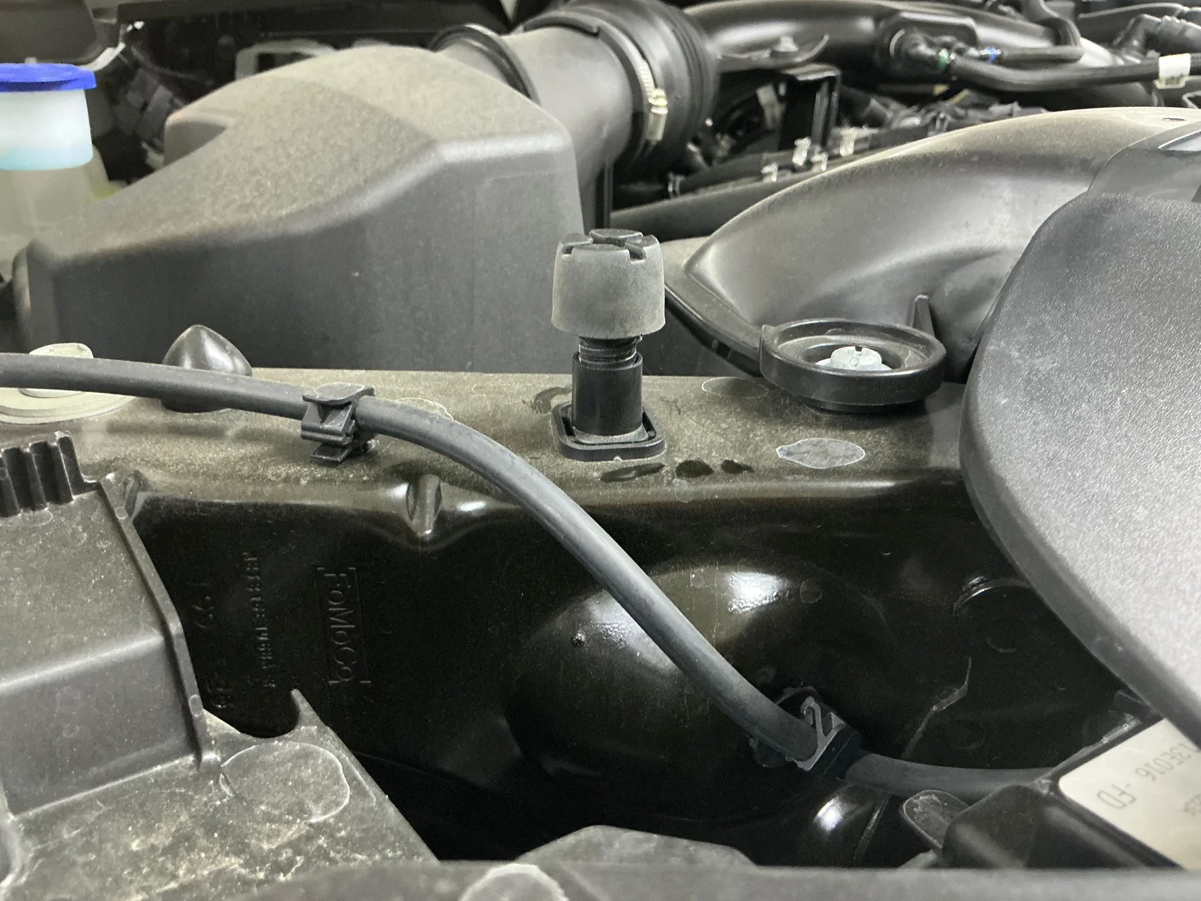

‘Using the 24 setting next to it and studying its adjuster settings, and sorting out a way to test it.
I think I have made some decent improvements.
Still need to test it in the real world to really know if I made any improvements.
Here is setup I ended up with.

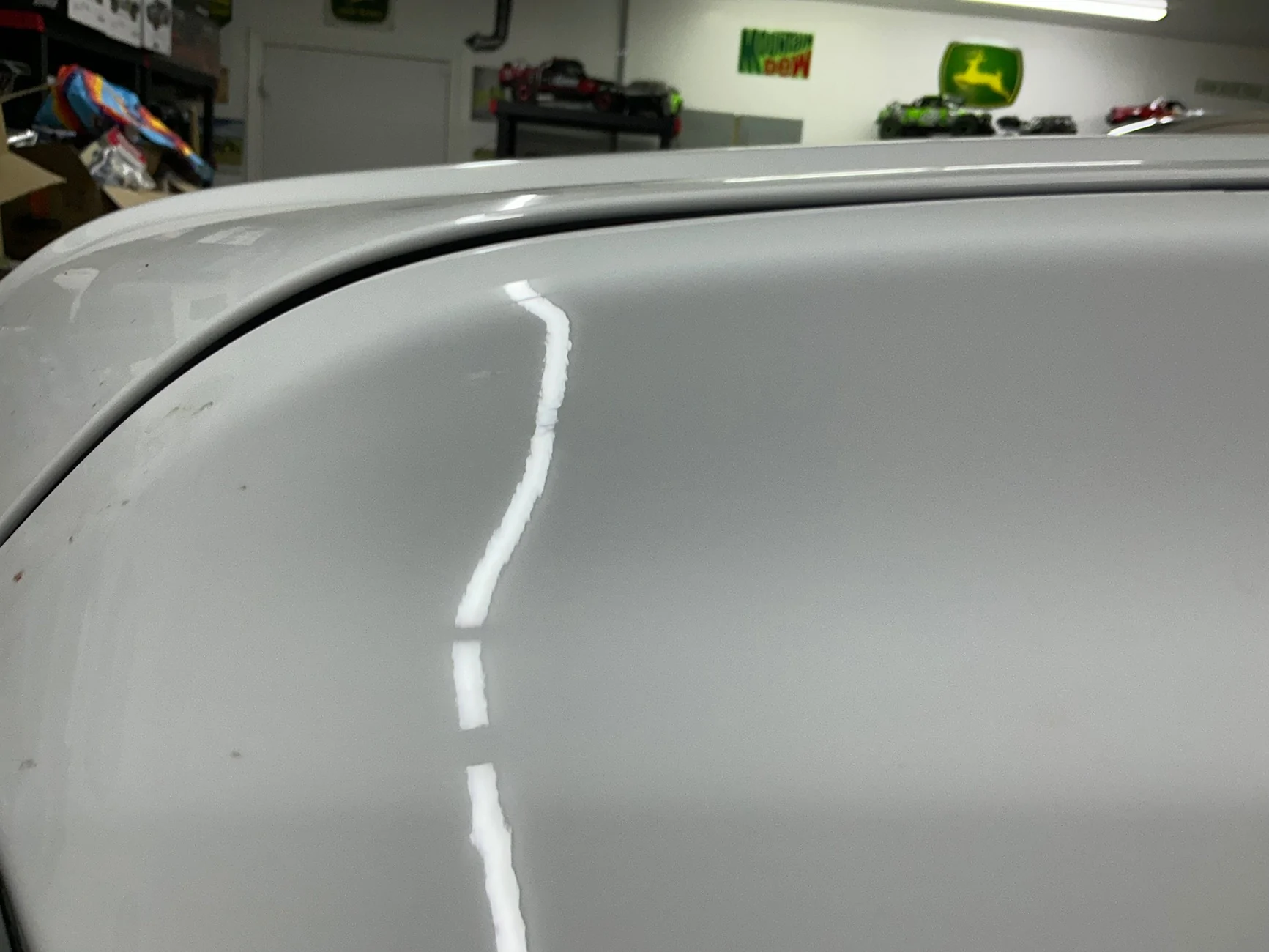

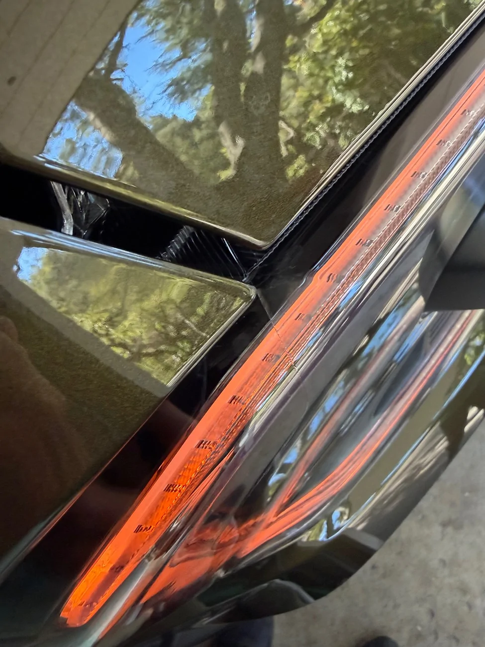

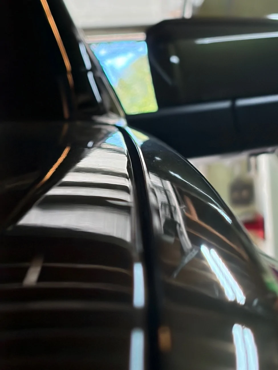

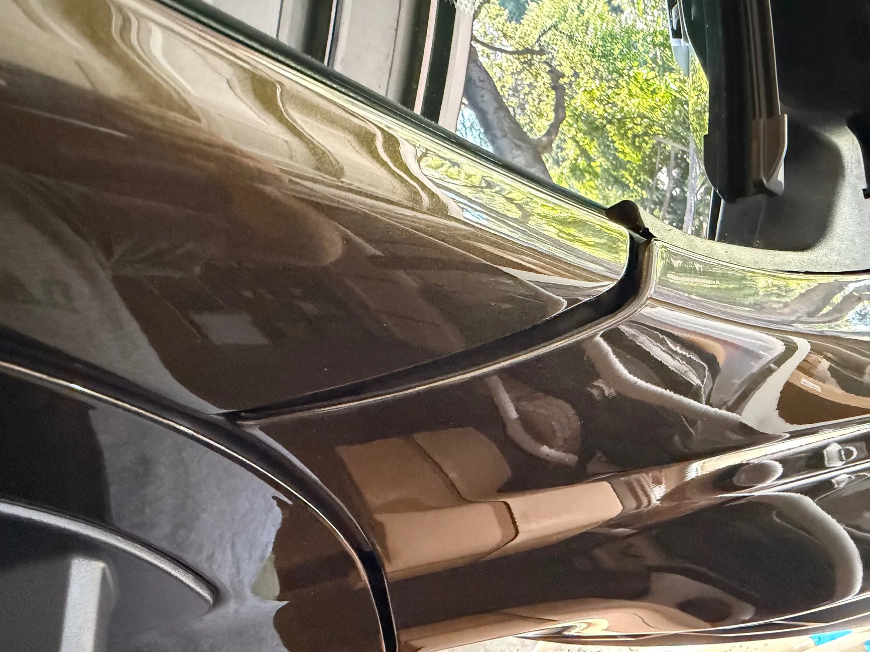

Passenger side
Driver side

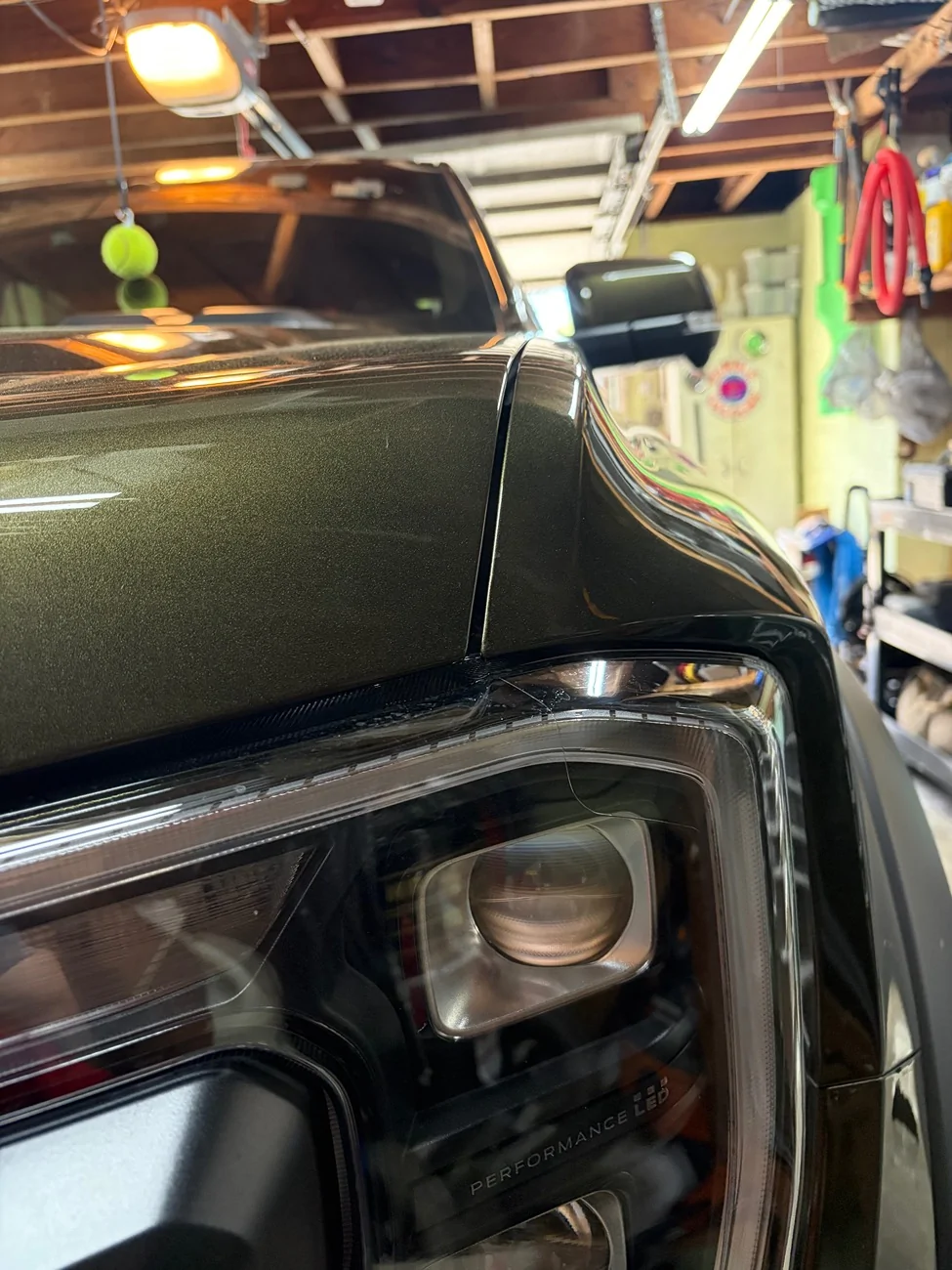

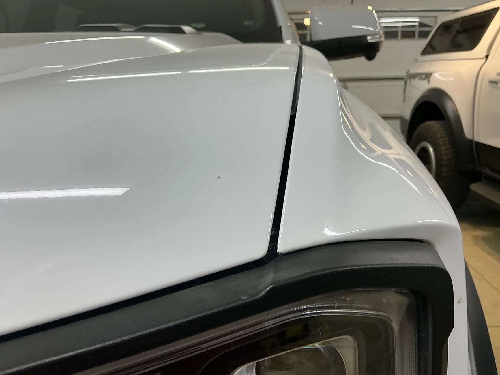

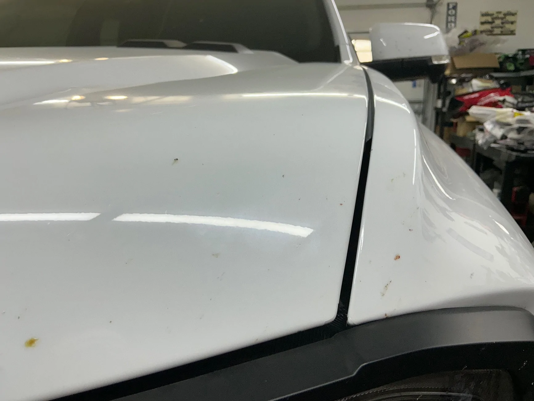

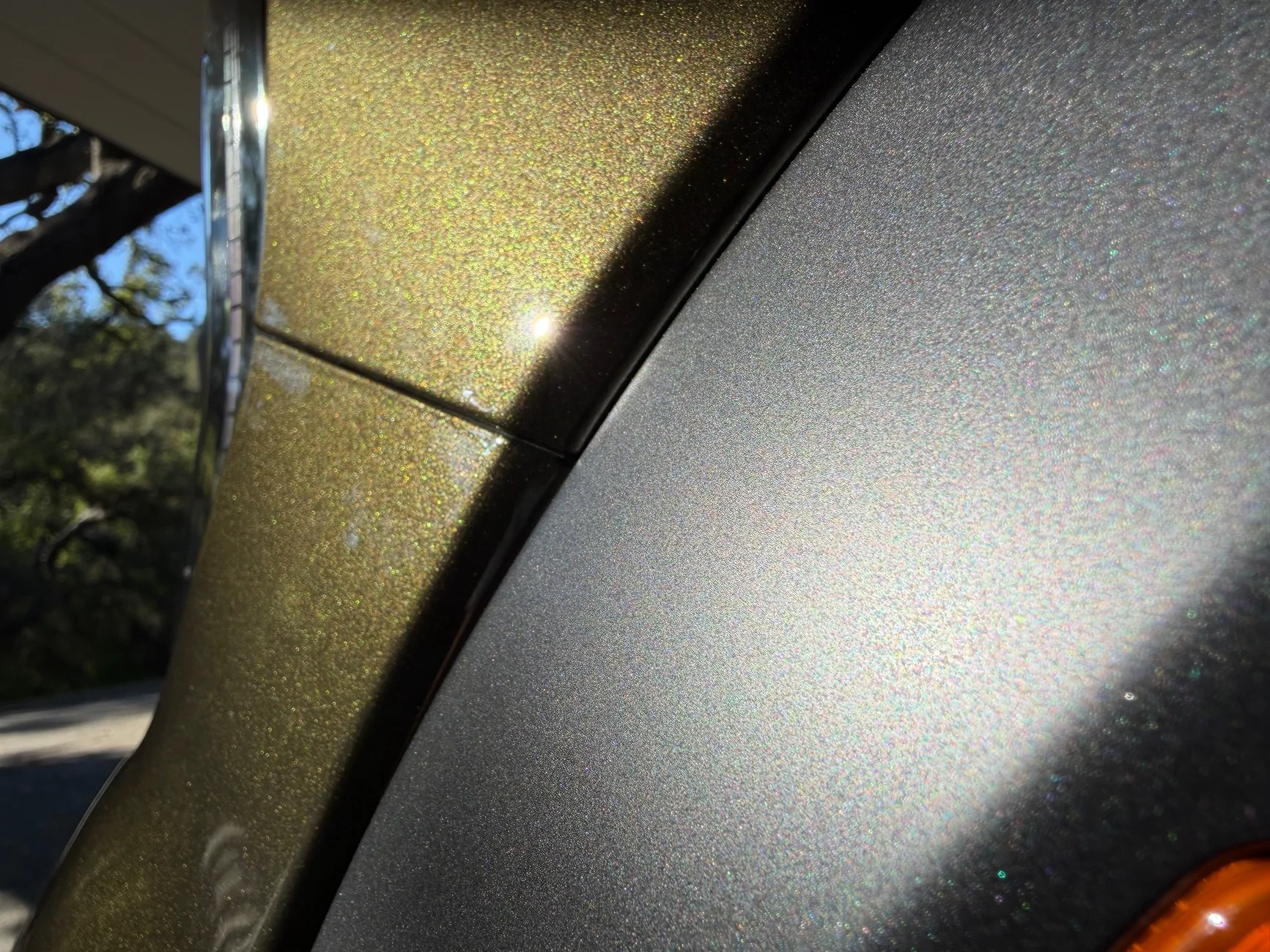

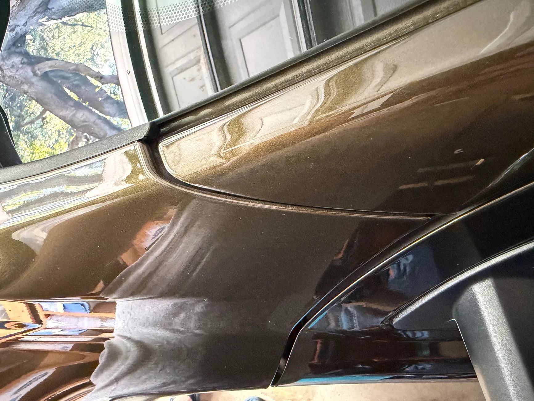

Passenger side now.
Driver side now.
That looks much better than before
