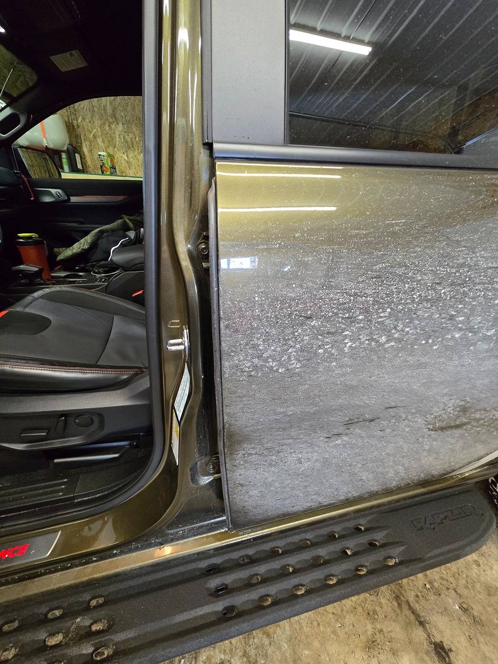

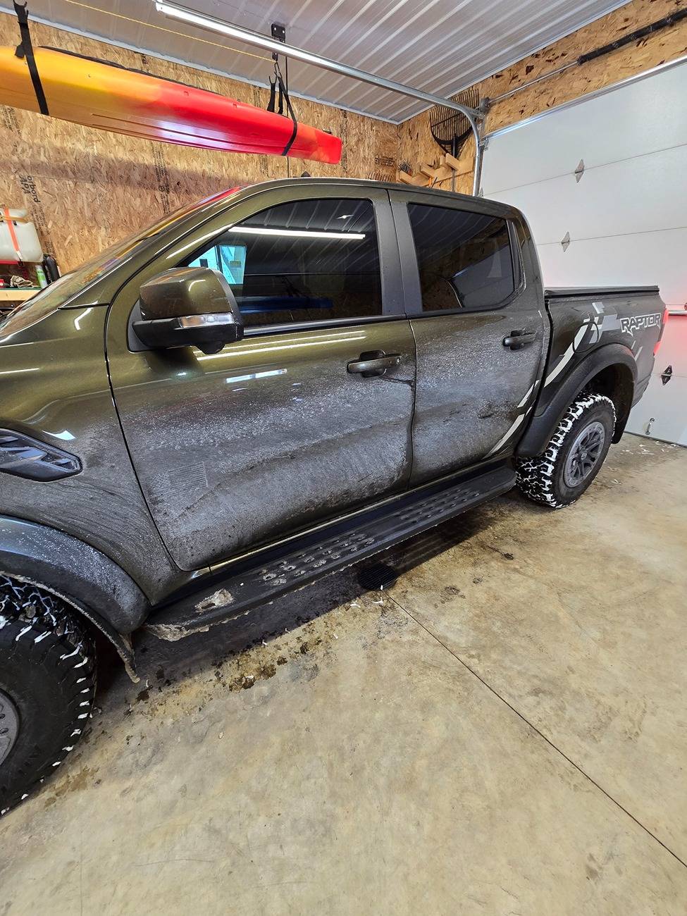

Found a cheap fix for the wind noise issue at the B pillar it cuts wind noise down by 90 percent to the point I only hear wind noise from the side mirrors now at highway speeds. If you look at the front edge of rear passenger doors where they meet the front passenger doors you will see a lip that was designed to hold a weather seal. Apparently Ford never got around to installing the seal on our trucks hence the wind noise. I got 3/8x1/4 D seals peel and stick from Amazon and they seal the front door to back door gap completely.

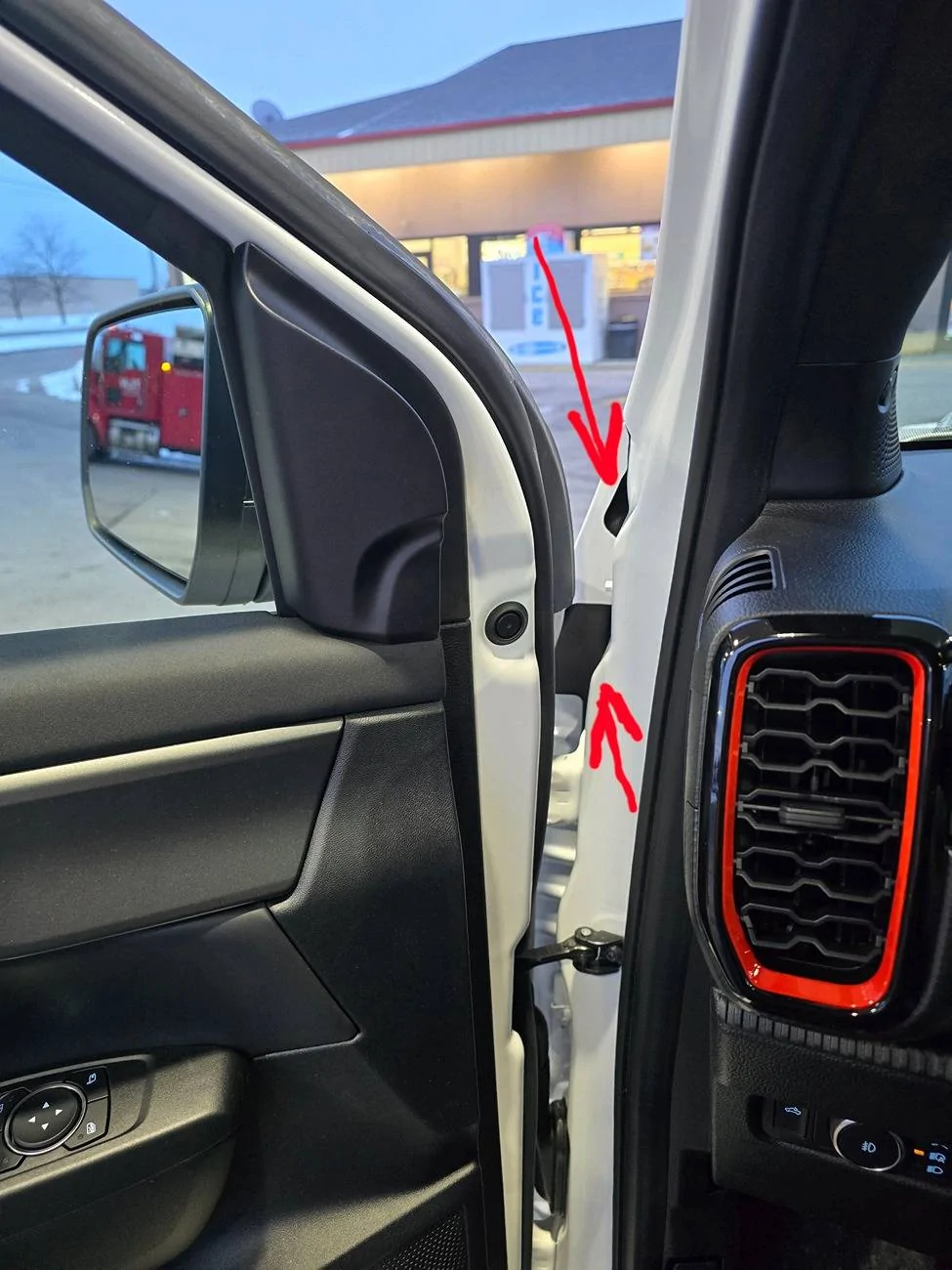

Maybe the noise is coming from these two large openings in the fender ???

There is a foam piece in those openings. If you put your hand in there, you can feel it. Mine actually moves a little bit, and I'm not getting any noise issues.
