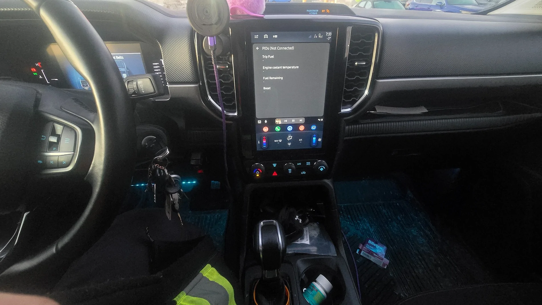

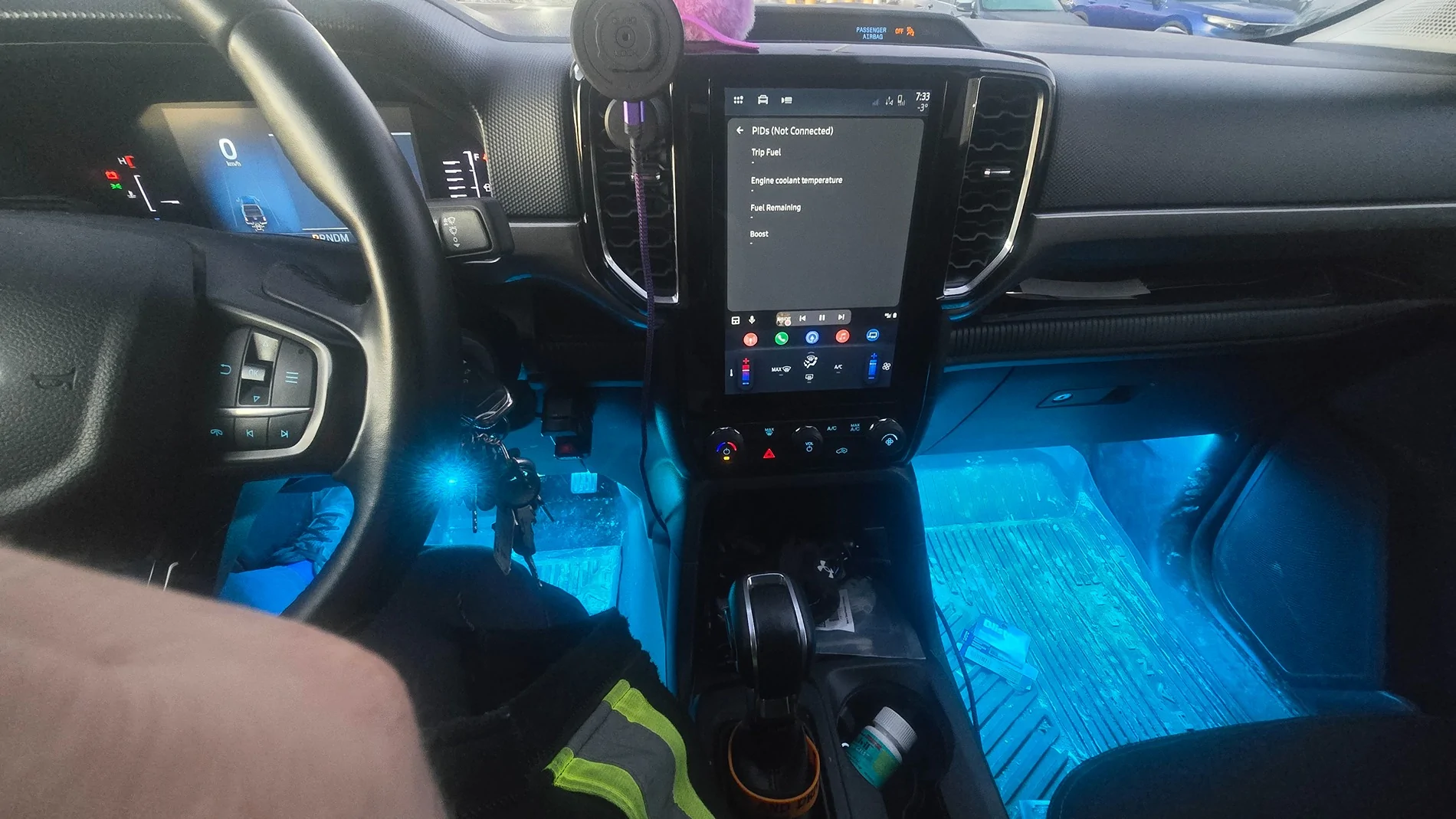

I'm running Diode Dynamics, my "brain box" the bluetooh module is under the center console then I am running the wires to the front foot wells and under the front seats. I got some velcro with double stick tape on one side, and put it on the lights to stick to the seat,

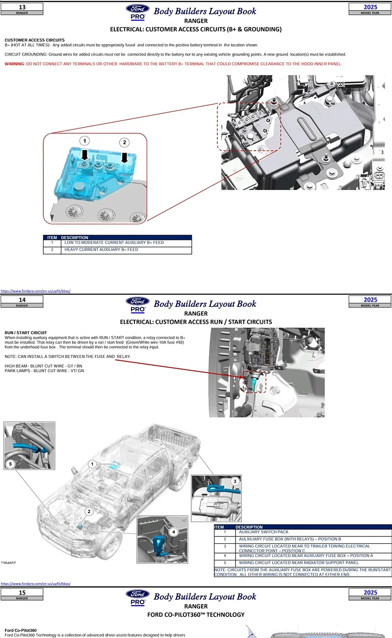

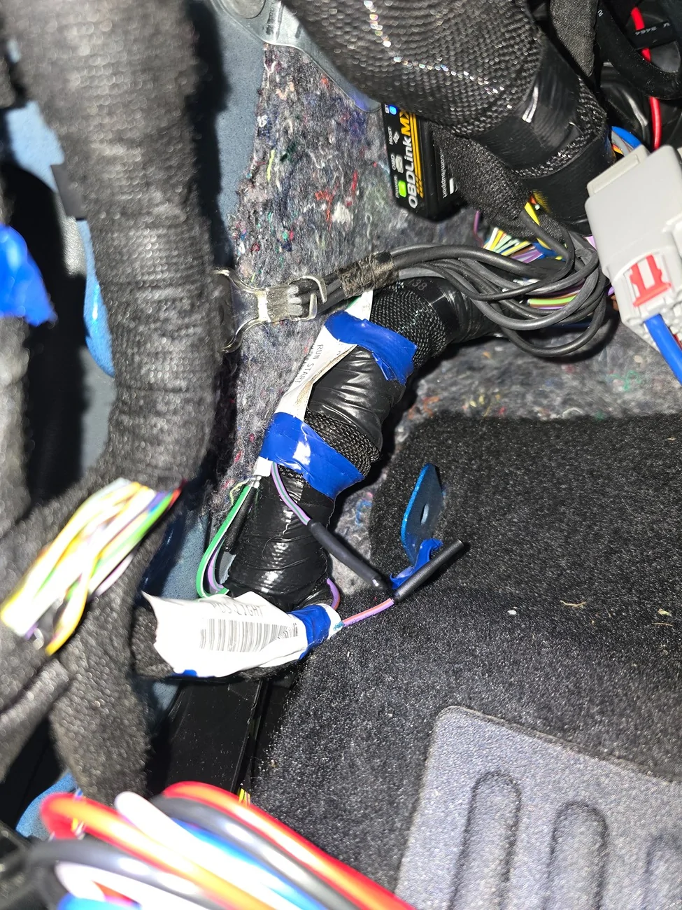

there are blunt cut wires under the bcm near the wire grommet you said. theres a high beam trigger, marker and ignition on wire.
I got my DD in a fuse tap at the bcm, this was before I found out about the blunt cuts.
