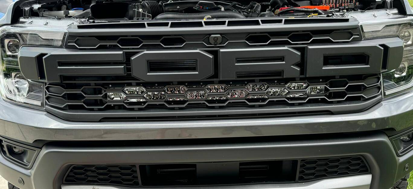

I really wanted some additional light on the Raptor but didn't want to have to hack up any of the OEM plastics like I've seen in some other videos (no hate).

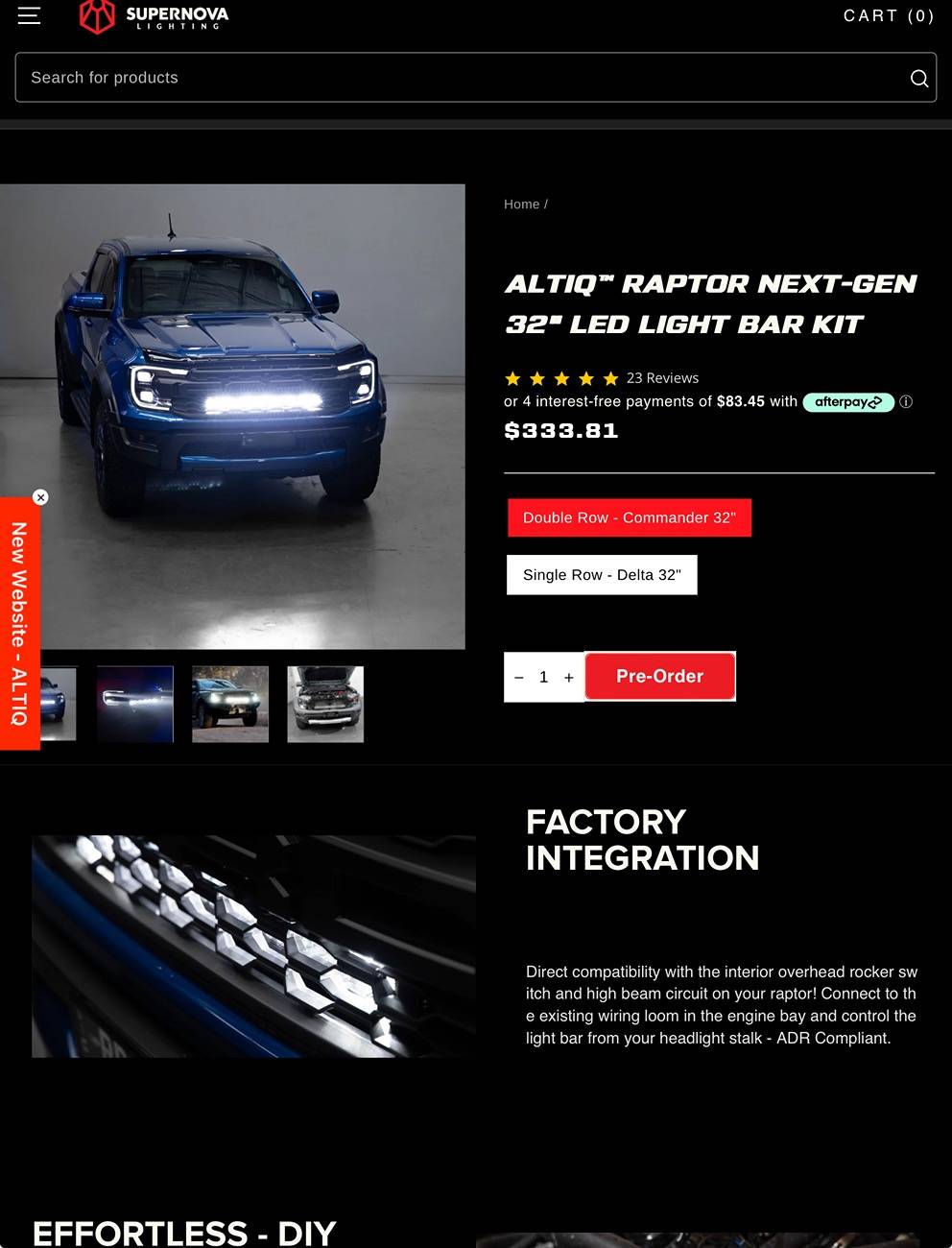

I found and landed on the Altiq 32" double row hybrid light bar, they are a company in Australia, Ordered on 14MAY and delivered the next week.
https://altiq.com.au/products/next-gen-raptor-32-light-bar-kit
This was exactly what I wanted, super bright, direct bolt-in, no-cutting, and what appears to be solid craftsmanship.

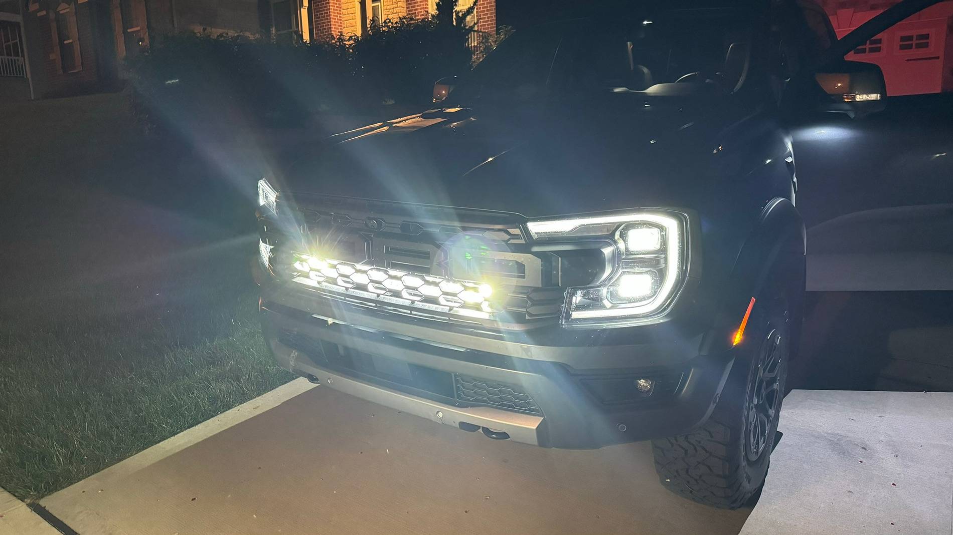

Light bar off:
Ford Ranger Raptor LED Stealth Light Bar Installed IMG_2864
Light Bar On:
Ford Ranger Raptor LED Stealth Light Bar Installed IMG_2865
Installed pic:

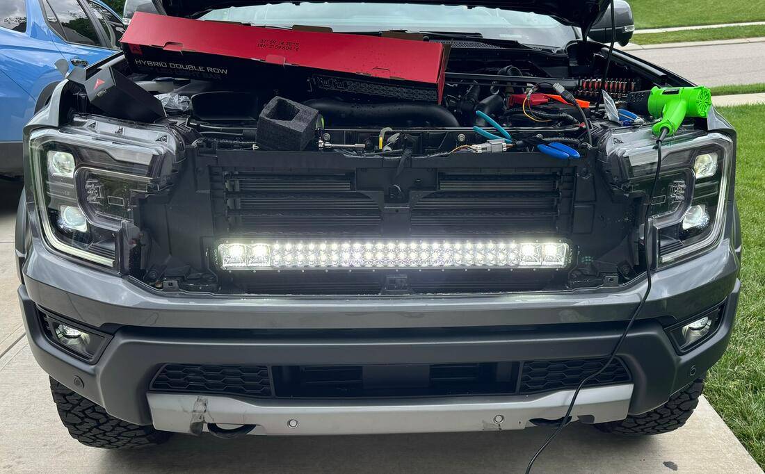

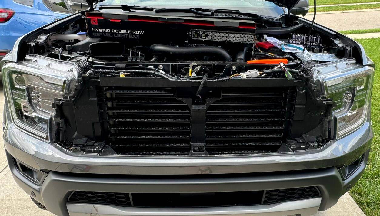

Install was super easy, the company provided a video:
Basically, open hood, remove the radiator splash guard cover, remove trim in the bottom of the grill, two bolts on the top of the grill, three on the bottom then pop the grill off. Install the light bar on the existing 2 bolts and 2 push pins, wire into Aux 6.
Grill Off:
Ford Ranger Raptor LED Stealth Light Bar Installed 1716921482633-8
Light Bar in and wired (I ran the cable under the plastic side guard and up):
Ford Ranger Raptor LED Stealth Light Bar Installed 1716921549459-8y
All back together:
Ford Ranger Raptor LED Stealth Light Bar Installed 1716921607737-rd

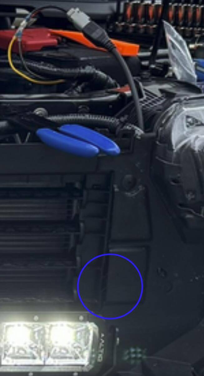

Where did you route the wiring for the light bar?

Mine is a US raptor, on the drivers side there is a plastic close off panel that covers the gap between the raiderator support and the head lamp, I posed a clip out of it, routed the wire through there, put the clip back and and bought it up beside the harness on the driver side headlamp.
The kit doesn't interfere with the louvers and they remain functional.
EDIT: Here is a photo, the wire goes behind the plastic panel around the blue circle area.
Ford Ranger Raptor LED Stealth Light Bar Installed Screenshot 2024-05-28 at 9.27.56 PM
Thank you so much! I ordered the kit and am excited to get it installed. How long did it take for it to get delivered once it shipped?
