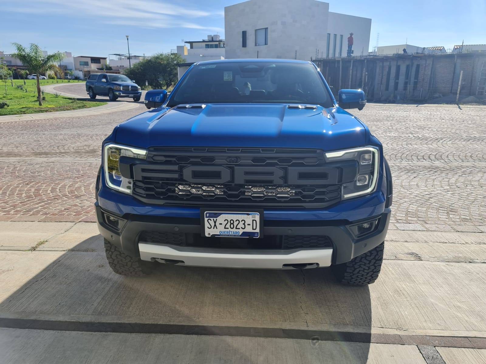

I installed my lights for incoming people who drive with the high beams and don't care about other drivers, even when you flash them back. It turned out to be pretty effective, mine are effective up to 900mts away (2700 ft) :) .
The only downside of this behind the grille install is the cleaning of it.

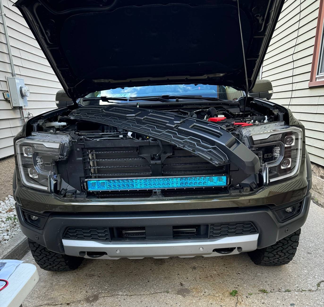

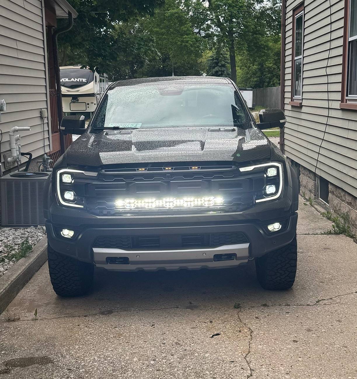

Price is reasonable for a double row and can't beat the no mod install. Ordered a set for my RR.
For any of you wondering about lead times.
Ordered May 28th.
Shipped May 29th.
Entered customs on June 2nd.
Cleared customs on June 3rd.
Delivered June 5th.
Installed June 6th.

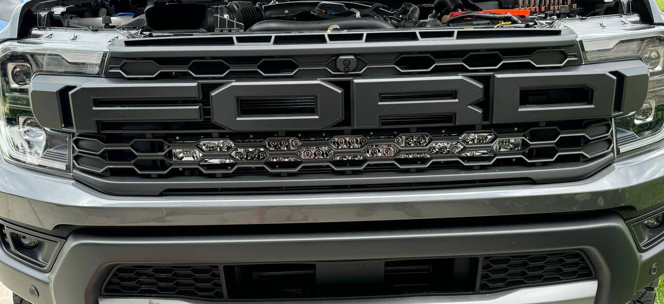

I like the light bar! Where did you get the 3 amber LEDs in the top of the grill and How did you mount them?
Ag3ntC00p3r
Apr 24, 2024
412
497
Wisconsin
Product Manager
Thanks. I got the marker lights on eBay but I wish I would have gotten the F150leds.com lights instead. I already have one of them flaking out (diodes dim/flash). Not a wiring issue as I soldered the connections.
You have to drill a small hole behind each pod to feed the +- wires and tie all three into one of the AUX wire points. The pods have 3m type tape on them to secure them to the grille slots. I used AUX1 for the marker lights and AUX6 for the light bar.
skhale69
Aug 27, 2023
62
62
Oxford, MS
2018 F150 FX4 Lariat Supercrew, 2024 Ranger Raptor
Retired Firefighter
Thanks for the details. I also got a set from Ebay, but they are too wide to fit the top 3 slots. They came with 4 pods so I may install them in the 4 open slots in the next row down.
