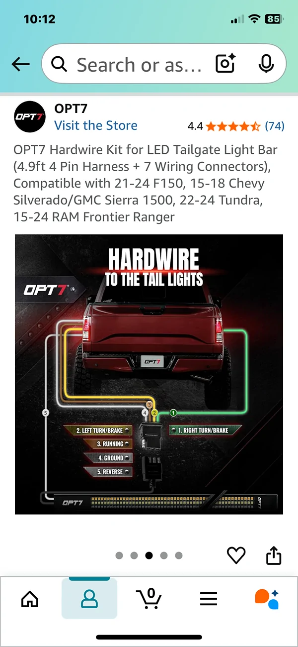

Here are some pictures of the things you need to buy from Amazon for this project, with some alternatives for the adhesive promoter.
This DOES NOT give you brake lights. I haven’t investigated Shadow Dragon 24’s post above, that may be above my skill set.

The brown on the harness from the light bar should go to the violet/green wire on the left hand, side taillight harness
You need the trailer harness

Yep have all this, I figured it out...I need to connect to both left and right sides! I was connecting the wires only to the left side (plus the right side turn only). I needed to run a wire to connect the same violet/green from the left and right side together to the hardwire harness then it worked exactly as expected. I'll admit when I bought, I thought the brake would work too but I'm just happy to get the same functionality as you.

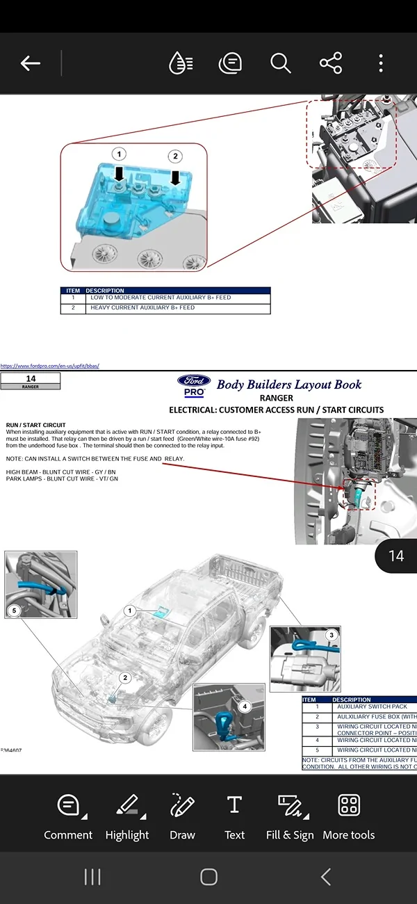

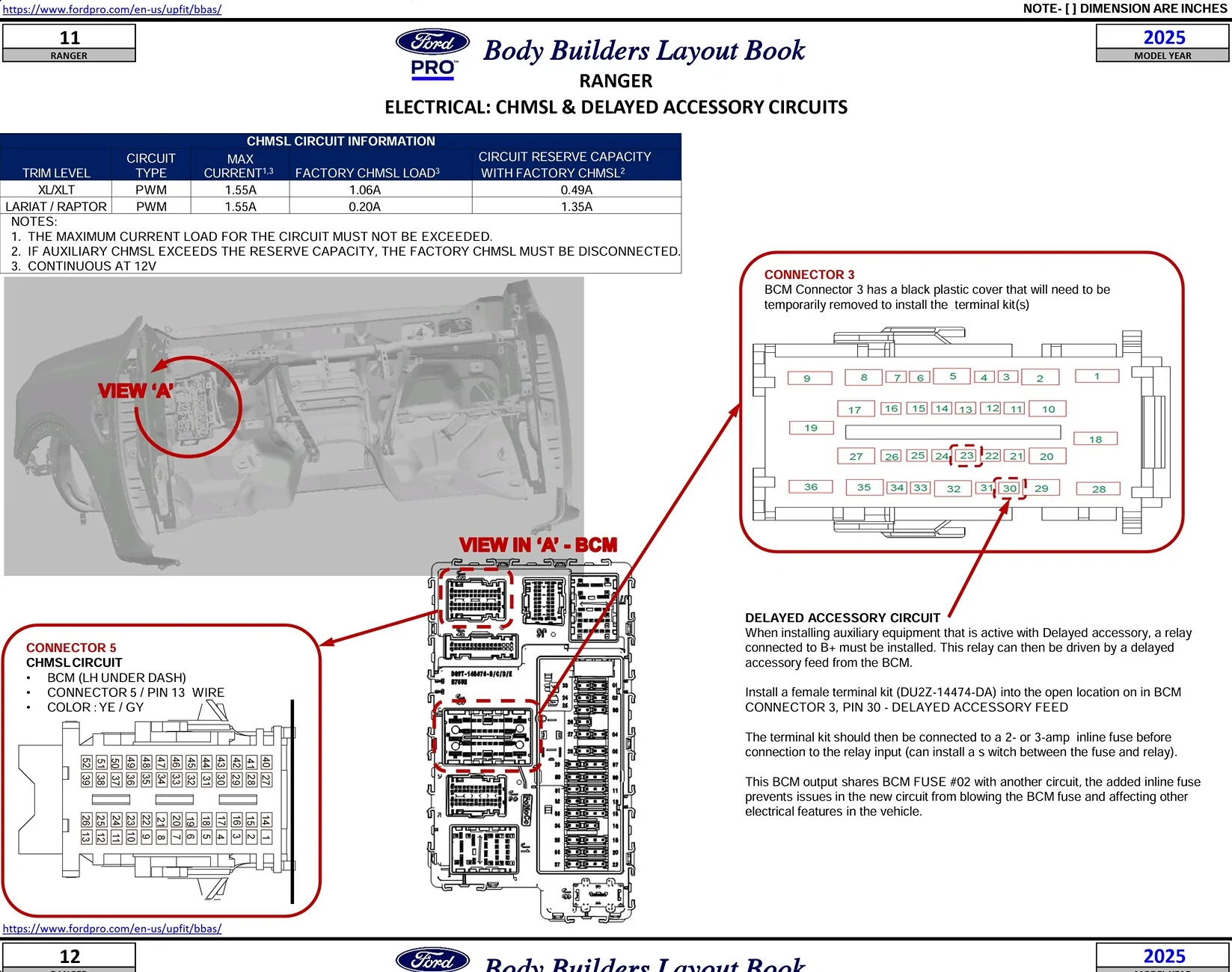

the ford upfitter/body builders guide says you tap the 3rd brake signal wire at the bcm. I did this for my 3rd brake on my cap, and my Diode Dynamics C1R's.
modified the 7pin plug it came with. cut the brake signal off both turn signals. hooked it to that new brake wire, and then sent it up to the cap plug. the 7pin harness still has my ground, marker, and and reverse power.

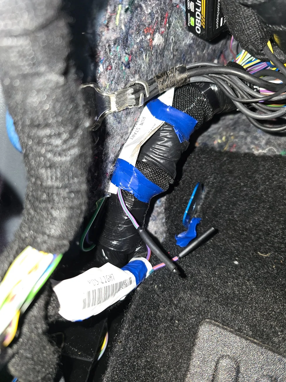

there's also 3 blunt cut wires under the bcm, behind the kick panel. a ignition wire (run/start) marker(pos light) and high beam. my high beam and marker light wires were labeled wrong. the high beam is the marker wire, and the marker is the high beam. lol

That is a solution, but i personally do not want to run up into the cab, ideally there would be a wiring kit for us so that we dont have to tap in/modify the original harnesses. Thats my desire at least.

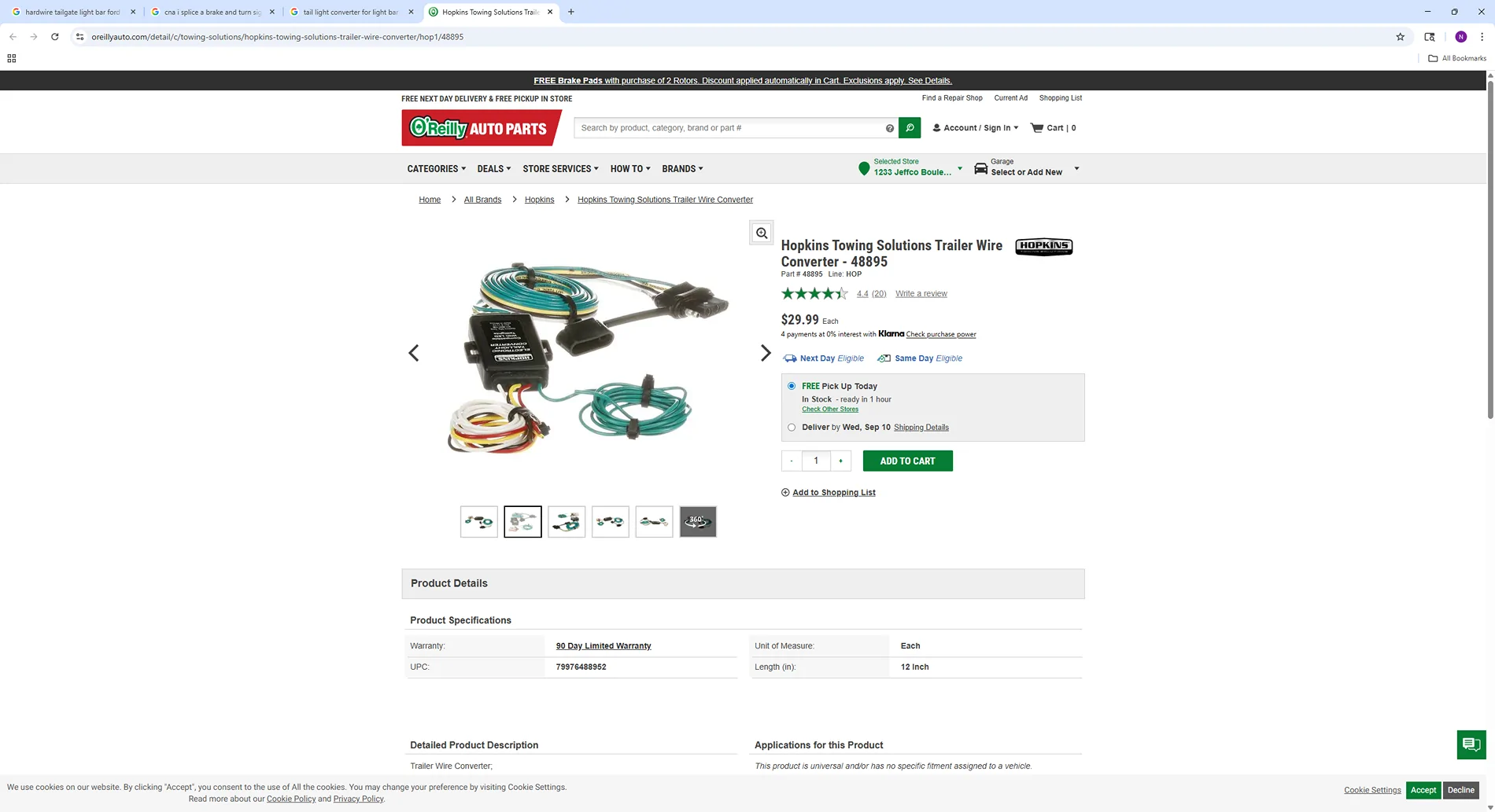

think i may have found a solution, not going with diode splices, ill let yall know.

as long as you dont get the signals from the trailer plug you will be good. when I used DD 7pin harness the brake module got its signal from both turn signals at the trailer plug it would kick out a trailer bulb outtage, unless my foot was on the brake. thus why I ran the wire I was doing it anyways, because I didnt want the upfitter cutting into the tail light harness. so I did it the ford approved way. the way ford wants it to be done. But there is nothing stopping tapping the tail lights. the Putoco light blade on ford accessories site. used tail lights. has a custom harness. but only for the ranger light through ford. cant order the kit or harness outside of ford.
