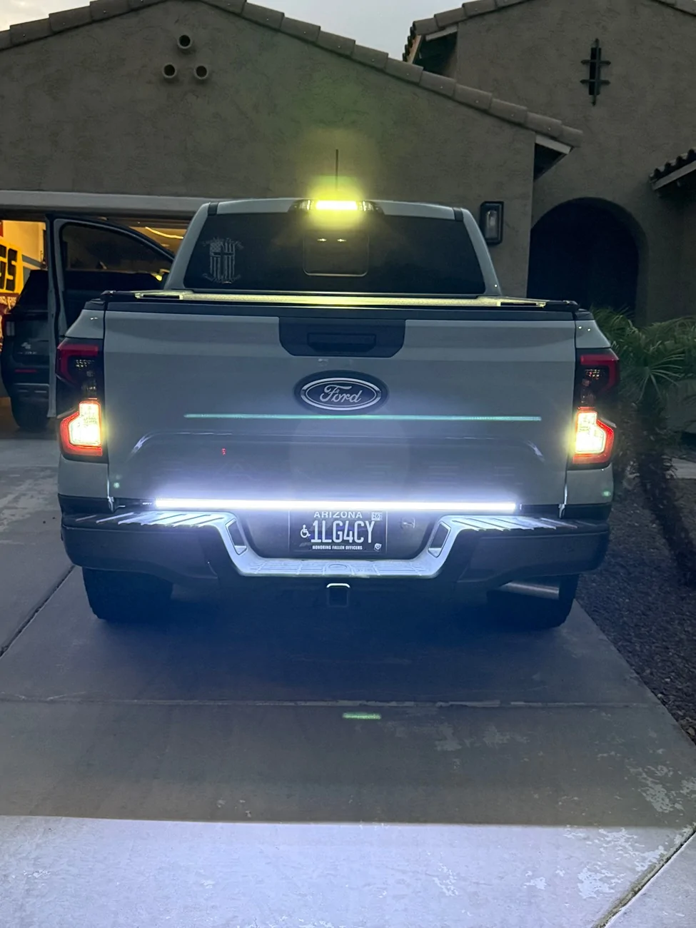

This is the kit from ford accessories.com that is for rangers with BLIS. It is completely plug and play and made by putco. For whatever reason it isn't available on putco's website. The only hard part is hooking up the brake light part of the bar. The kit comes with a t harness to tie into the third brake light on the back of the cab. I installed it on my ranger and can confirm it works perfectly without cutting any wires.

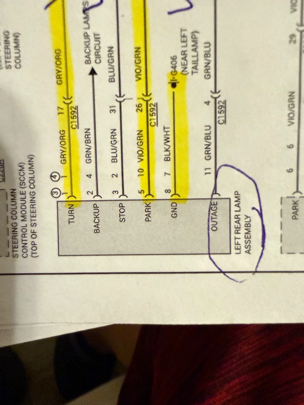

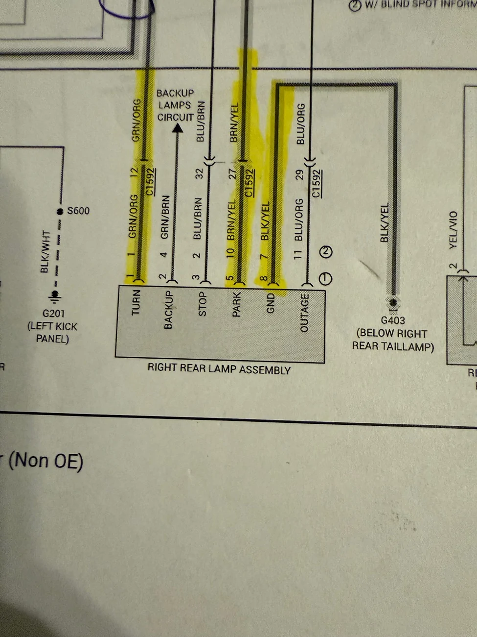

I know a bunch of people have wanted to do this on their rangers but with out a plug and play option out there it’s difficult. If you use the 4 wire plug at the hitch the truck freaks out and thinks a trailer is attached, gives faults for trailer tail lights not working and disables the blind spot/ cross traffic system.
I was able to get my hands on the wiring diagrams from a friend that works at a shop so I could hard wire into the tail lamp harness. If you plan on doing this modification you will find if you pull the tail lamps the harness to them is no help. All the wiring to the lamps is black wires. You need to get under the rear and out each outside of the hitch you will find a harness the you can follow up to the tail lamps I tapped in to this harness
i have attached photos of the harness diagram. Hope this helps you all out.
This was a huge help to me much thanks!! Got my favorite Opt7 tri-lightbar installed instead of the overpriced single color Putco light.

That is where I am tappin, I peeled about 5” of tape back.
Those wires are pretty small. What type of connector did you use to tap into these wires. I am trying to connect a light bar to the parking lights so that these turn on when the parking lights are running which from your diagram is the Violet/Green. But I’m afraid of using the wrong connector and cutting the wire completely. It would be great if you had a picture with the actual wire tap. Thanks for the diagram and instructions for your install.

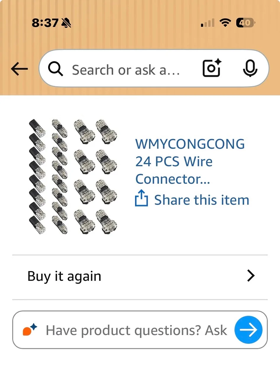

2024 Ranger XLT
I used these, bought them from Amazon

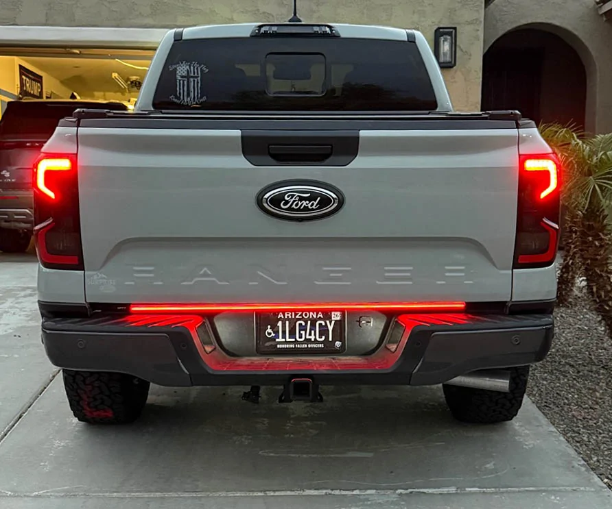

Ford Ranger LED tailgate light bar installed (harness wiring diagram attached) IMG_8369
