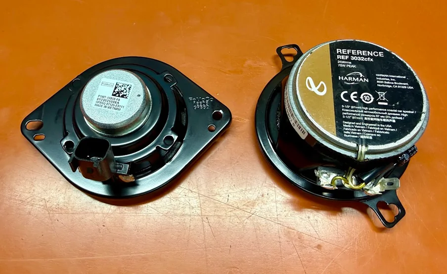

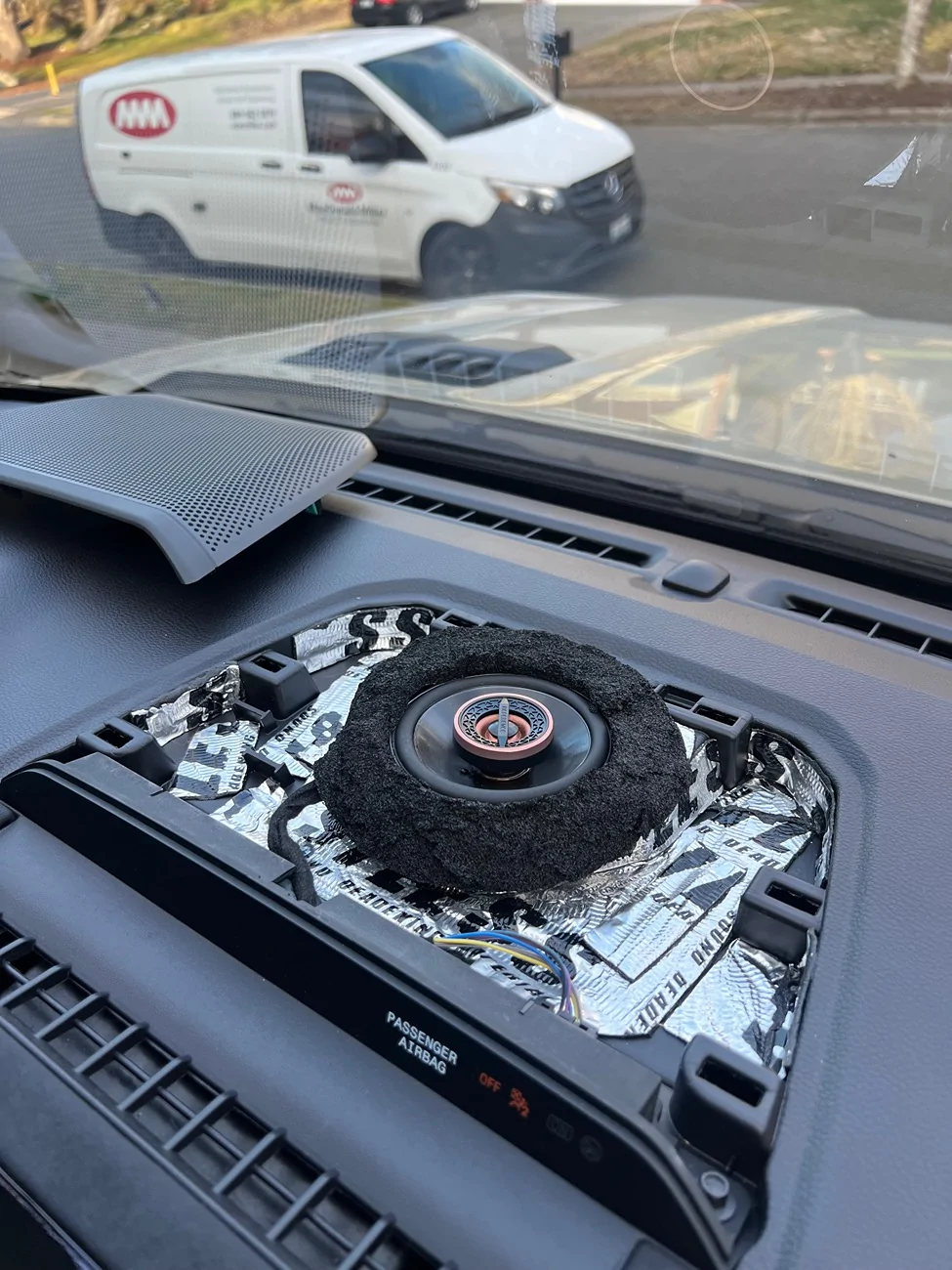

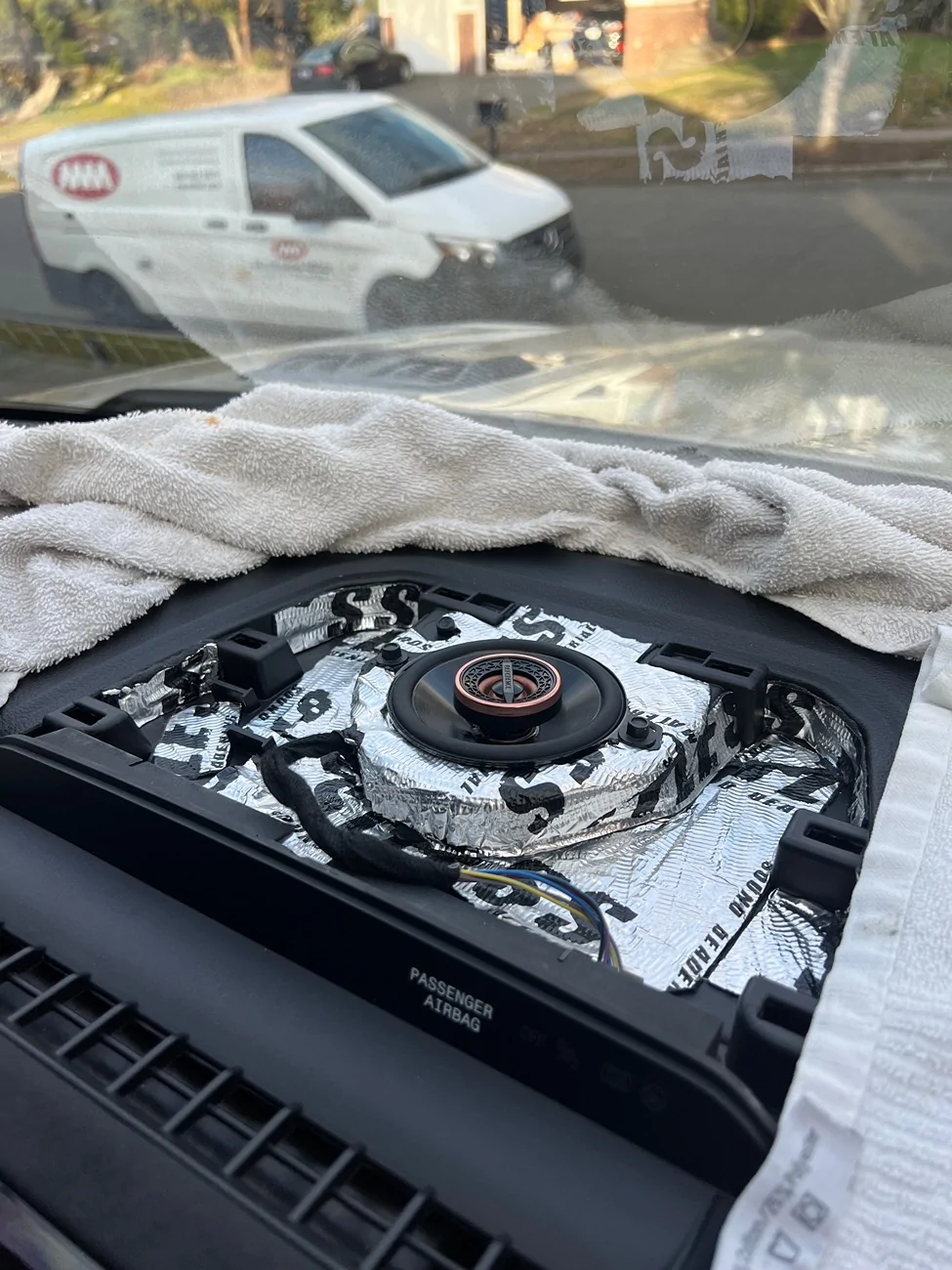

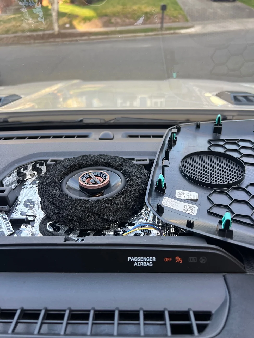

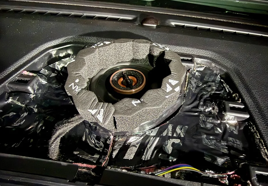

I personally love the center channel and run the system in surround sound mode. Listen to a lot of metal & industrial so I’m a fan of it being a bit “bright”. I noticed a big difference after doing the cc. Like the last post I also did the Infinity 2-way and find it to be a perfect balance. I had JUST that speaker in a couple days before doing the Focal 6x9’s & tweeters upgrade and then adding a Hertz 10” sub running off a Punch 300.1 through a Kicker Keyloc DSP.
The Infinity 2-way is a big upgrade over the stock B&O. And like the post above I also sound deadened the opening and did a haphazard foam ring around the speaker. Worth the hour & 1/2 of work to re-wire it and s/d the opening in my opinion.
