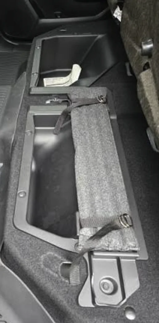

Has anyone attempted to fiberglass the under part of the back seat. And added with a 2" seat lift? How much free net air space were you able to achieve. I'm going to attempt this soon and need a solid .8CF Net for a Hertz MPS 300 S2 12. Any feedback would be appreciated.

It’s been measured and it’s no where near .8, don’t think anything bigger than a 10” will fit under the seat.

Get the Wavtech ThinPro 10. It only needs 9L and you can get that moulding the storage well and leave the seat as is. I’m running it now and seat bottom locks down and still sounds great

I actually made my own. I used painters plastic in the recess and mixed some expanding foam for a cast then fiberglassed that. I wanted to have all that space to work with vs just the plastic to mold from. I have a second one in case you’re in the PNW. I love the Wavtech! When it finally broke in it was almost like a switch flipped. It was really good and then one day I realized it was great hahah.

I got 9L, you may be able to squeeze out another L but having that lip along the front edge and door side I knew getting it in/out would be tricky. I think it’s the equivalent of like .3cu but a perfect fit for the Wavtech. Line it with painters plastic, get a 2 part expanding foam kit from amazon and pour it in there. You’ll need something to keep downward pressure though otherwise might end up with some voids. Sand it down a little, tape it off and fiberglass away!

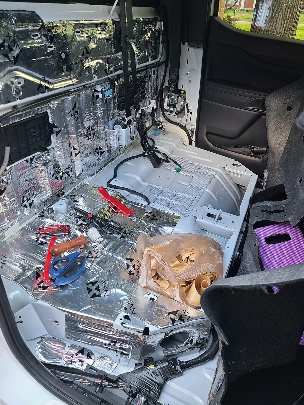

This is what you have back there with everything removed.
I thought it would be interesting if someone built a tuned box and used that hole in the PS riser as the port exit. I'm not that person. Lol

Ported boxes need more room and the port takes it’s own space away form the total. Only possible for a tiny speaker that will end up sounding like the stock one.
