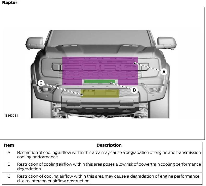

Is that not blocking almost all the air flow for the intercooler though?? See this insert from the body manual
