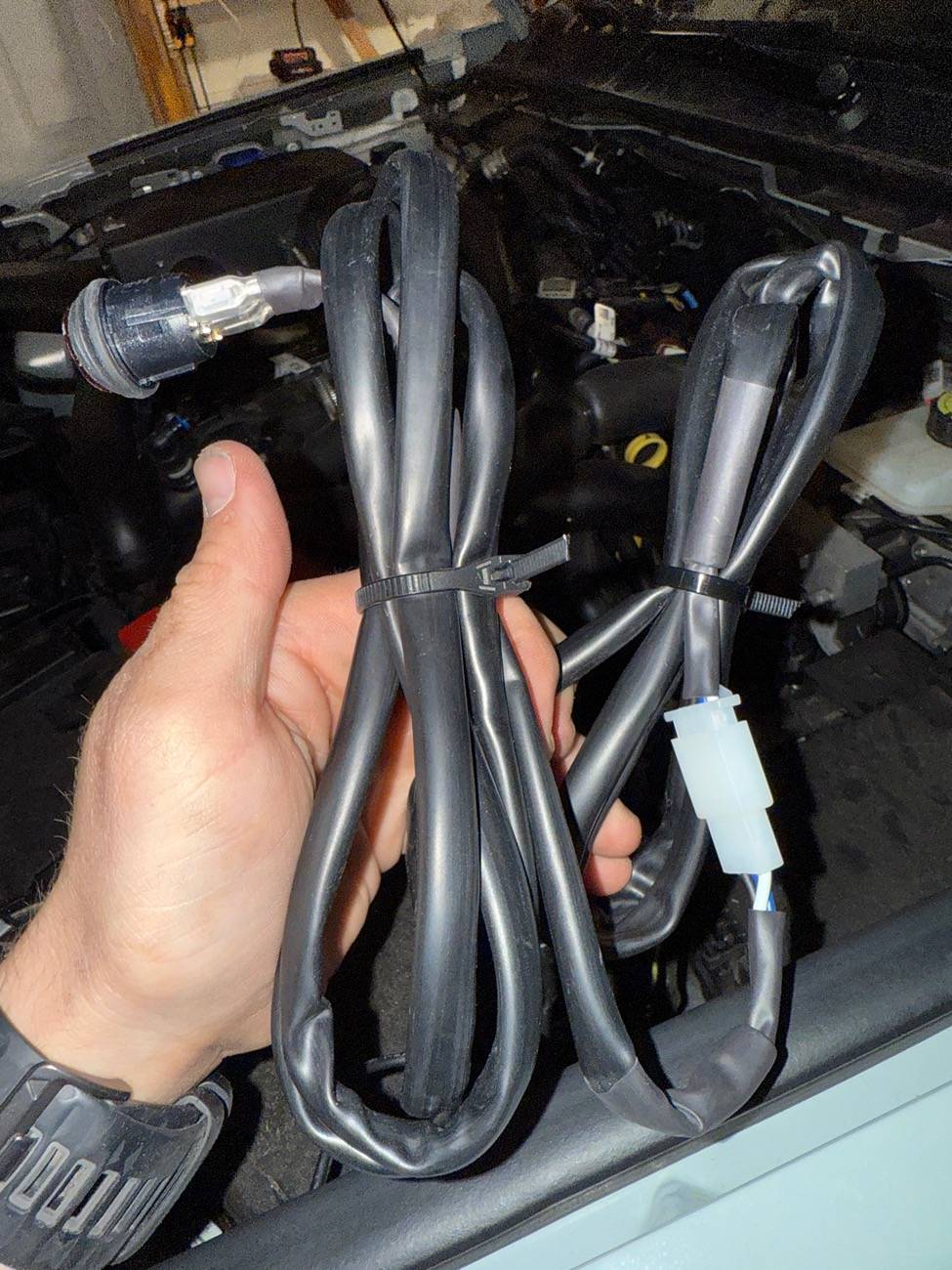

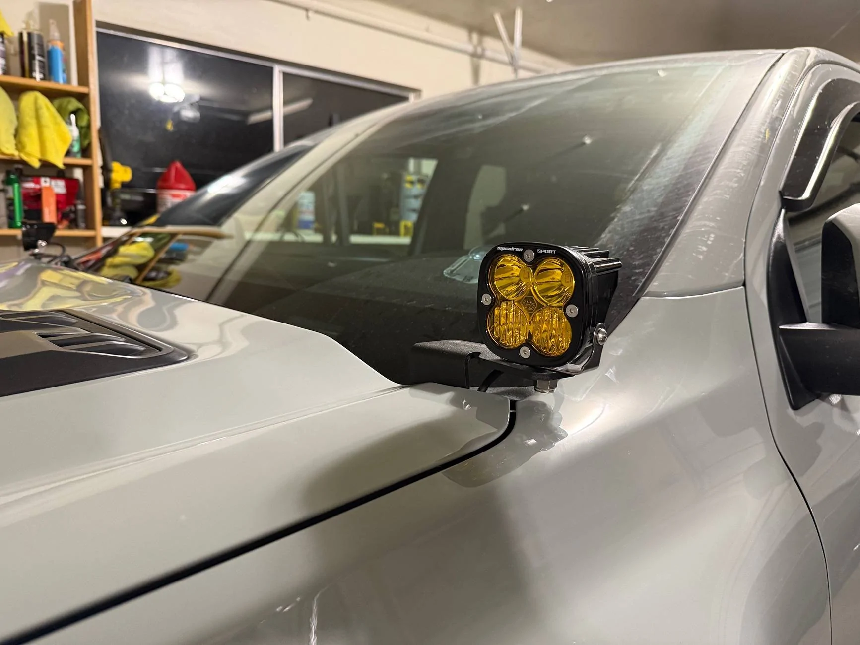

Installed a pair of Baja Squadron Sport Lights and was hoping there’s a way to delete the switch connected to the harness. It’s wired into the AUX 2 switch so there’s no need for the switch on the harness but if I remove the switch the lights won’t work at all. Any advice?
Ford Ranger Baja Squadron Sport Install - Switch on harness IMG_5329
Ford Ranger Baja Squadron Sport Install - Switch on harness IMG_5327

Do those have a three wire harness for a halo?
ducktapeonmydesk
Sep 7, 2023
135
106
VW Golf R
Can you post a pic of the harness itself laid out?
I'm guessing it has a relay with one side going to the lights, one to the switch, and one for battery and ground?
If so, the lights portion needs to stay intact. The battery (red) needs to go the battery. Ground (black) needs to go to ground. The switch side should have 3 colors: red, black, and something else (blue maybe?). You will wire the blue to the aux switch. The other two wires on the switch side will not be used.
