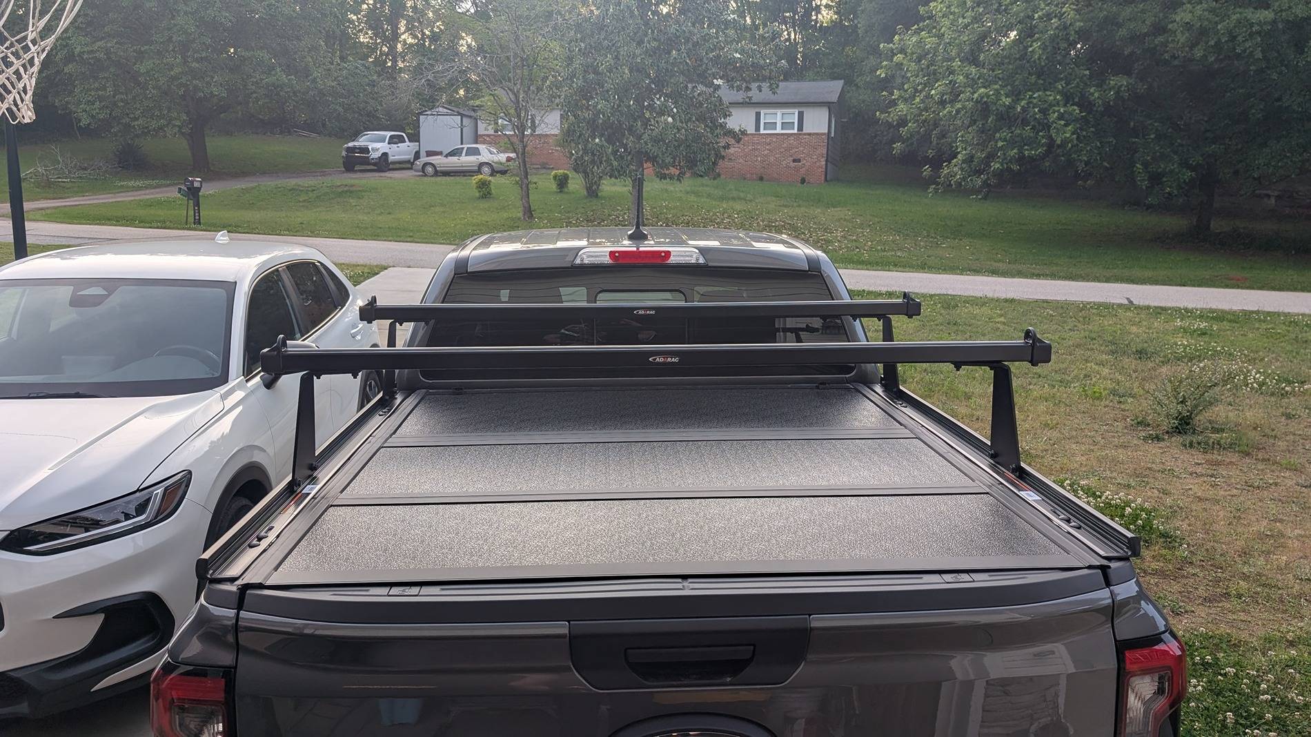

This is the Adarac M-series (mid height) rack.
"Height above the box rail: 12 in. for all trucks. Weight Capacity: 1,000 lbs. static, 500 lbs. dynamic and 400 lbs. off-road dynamic"
They make a taller one that is 12" taller than this that would sit roughly 6 inches above the roof line. Same specs as far as weight ratings.

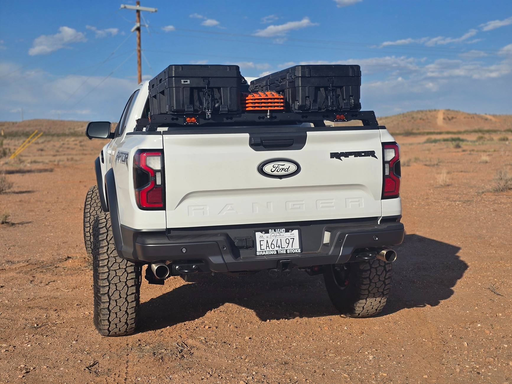

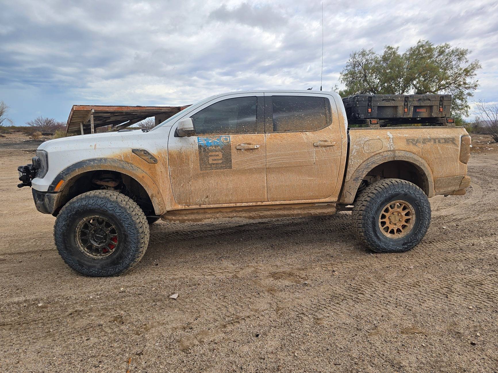

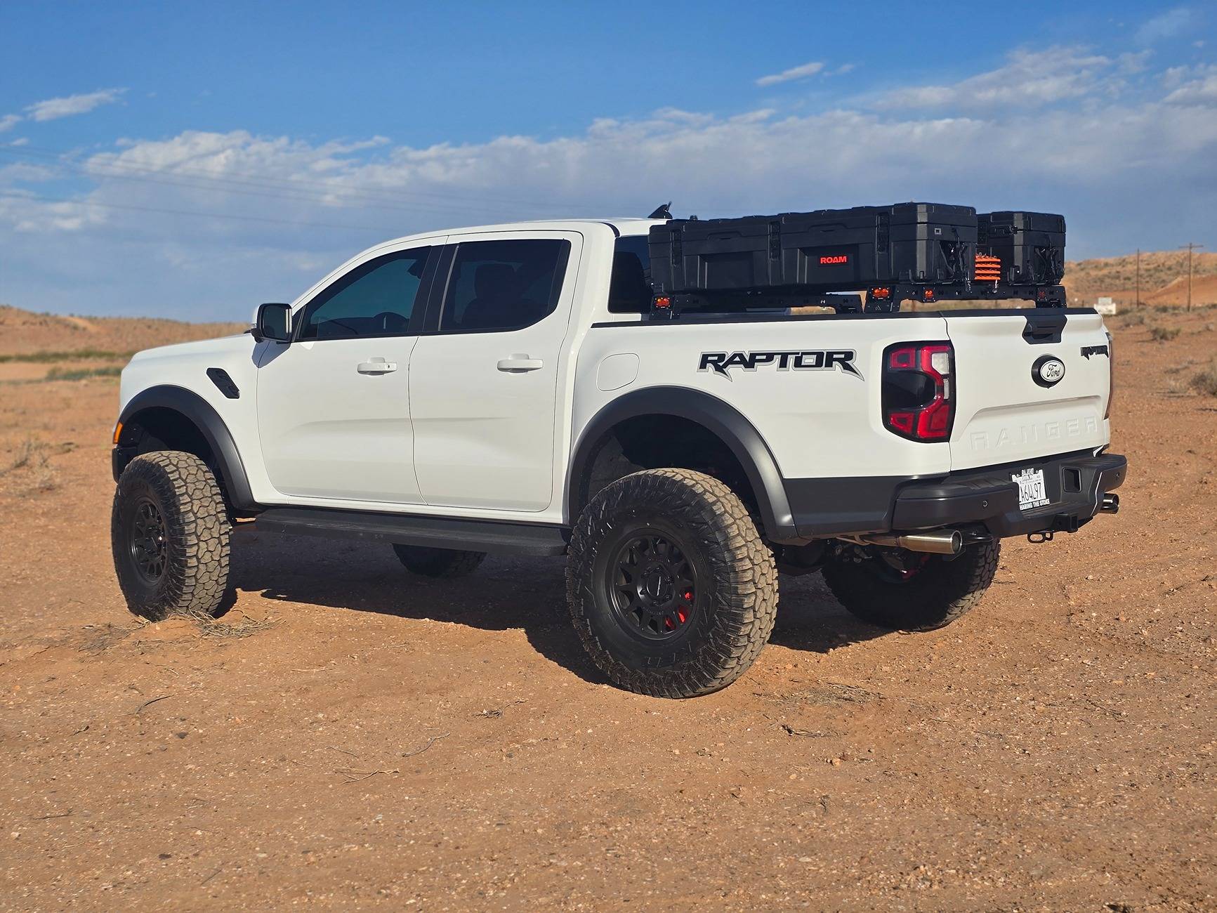

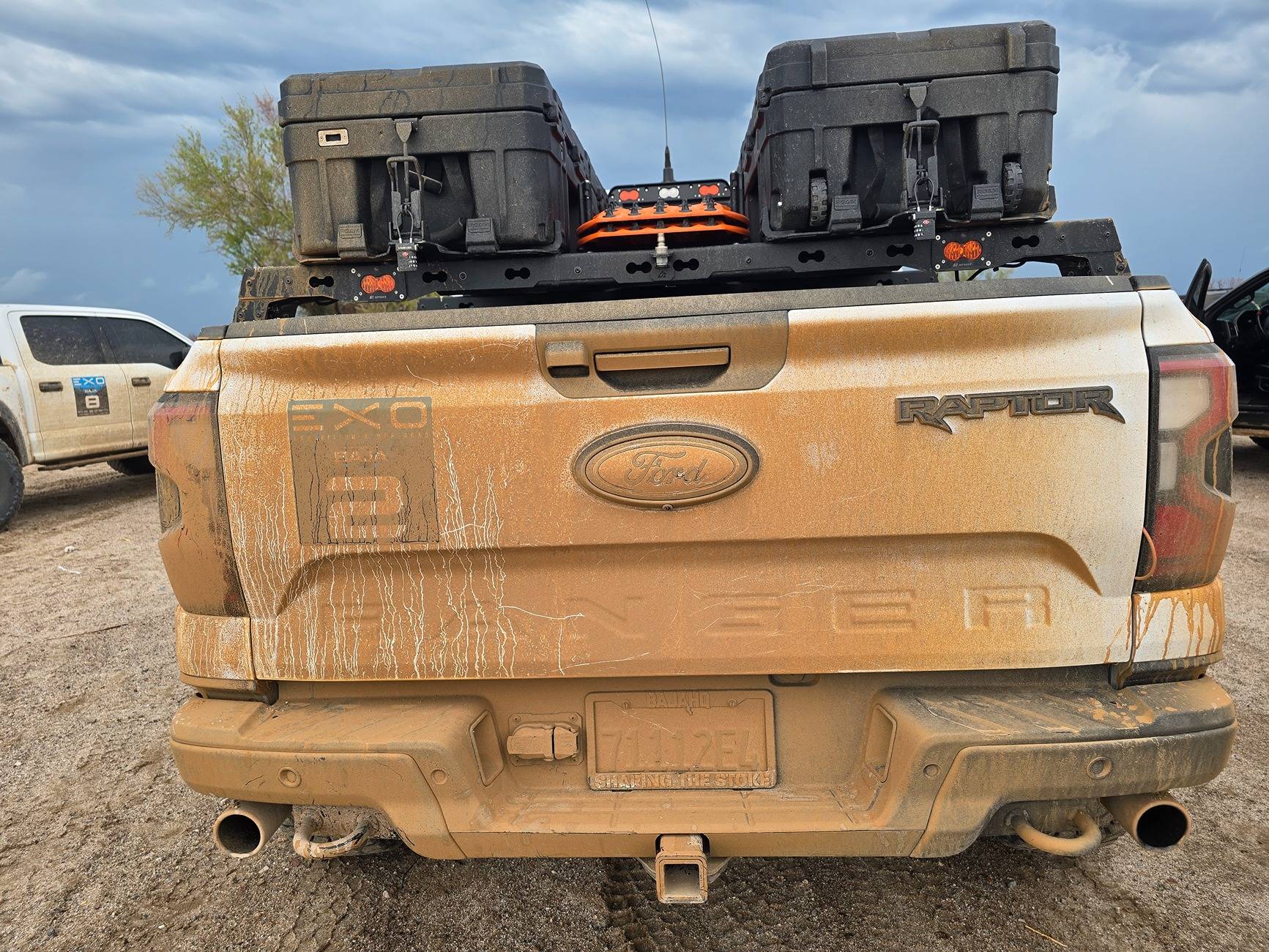

We beat the crap out of @AdventureLab rack for 8 days in Baja and heading back for 4 more days later this week.
The rack is entirely flexible but in this case "perfectly" holds 2 x 128l Roam cases and either 2 or 4 Maxtrax Extreme boards while staying fully aero.. Highly recommended.

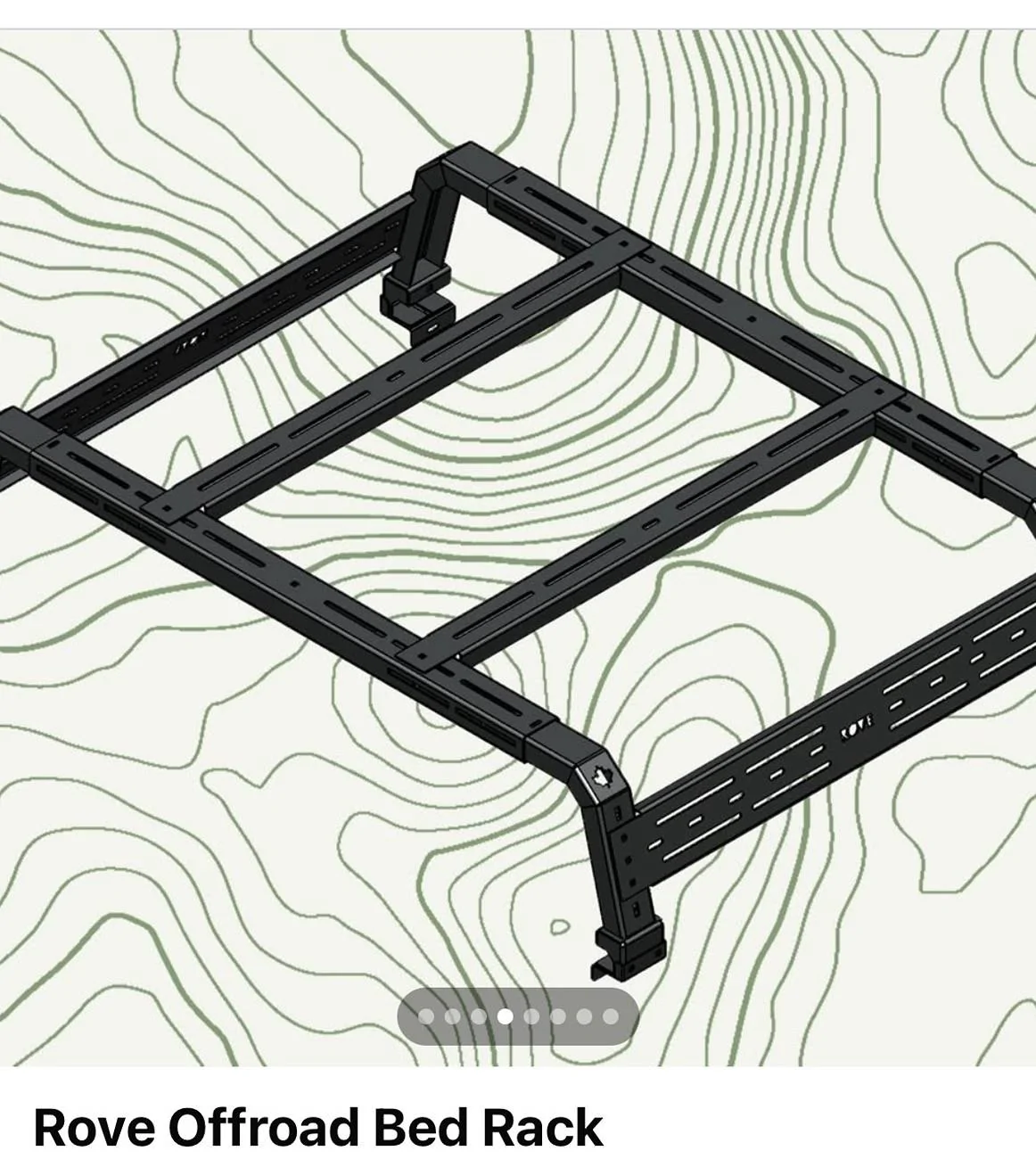

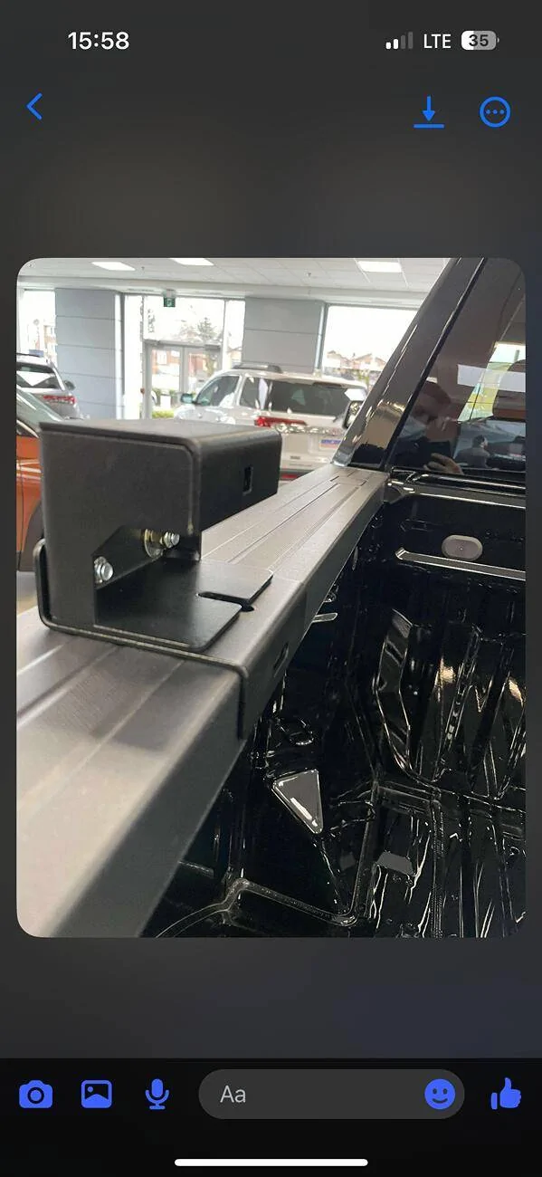

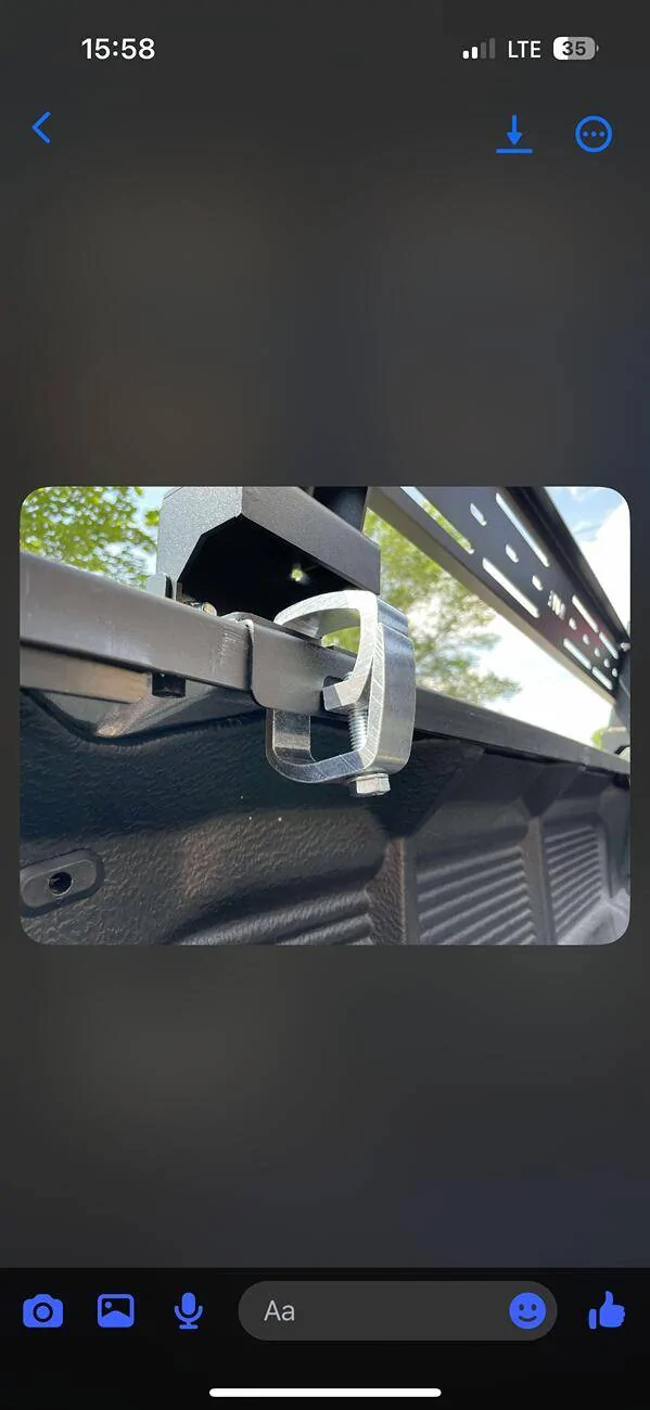

I’m
Looking at adding this rack, hoping it works… anything I should be worried about?
It has a few mounting options. Looks like
It would mount over the stake pockets

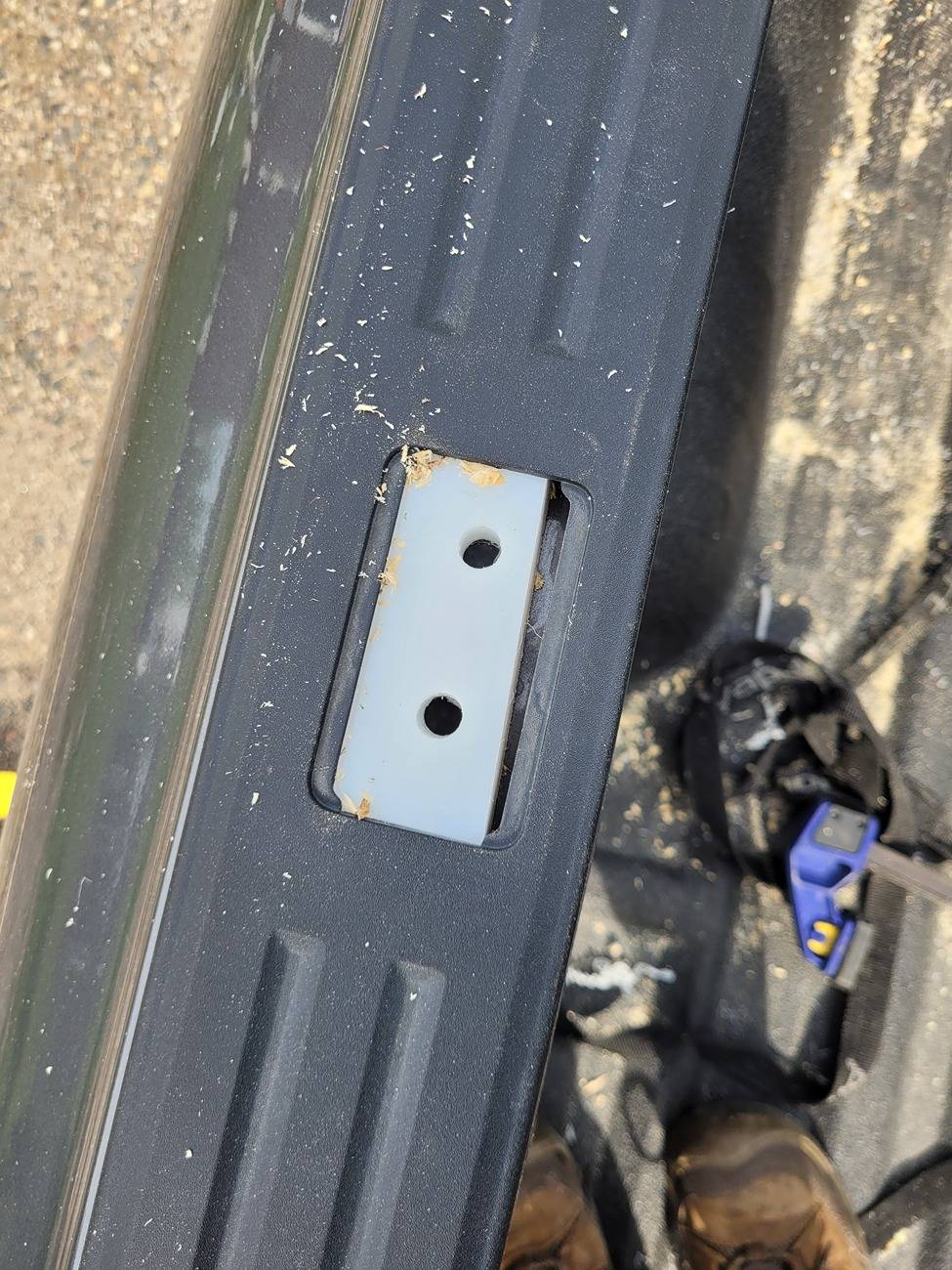

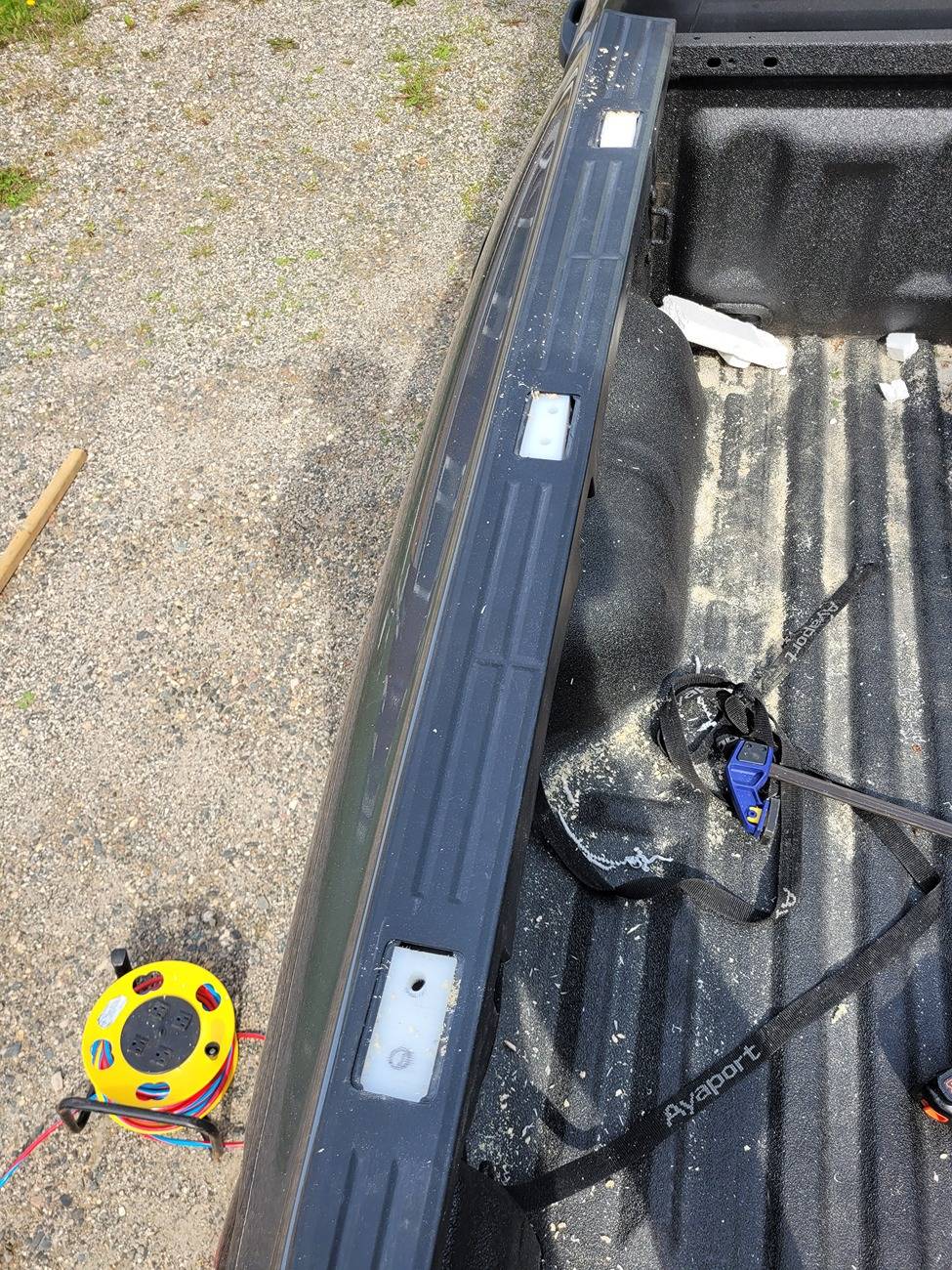

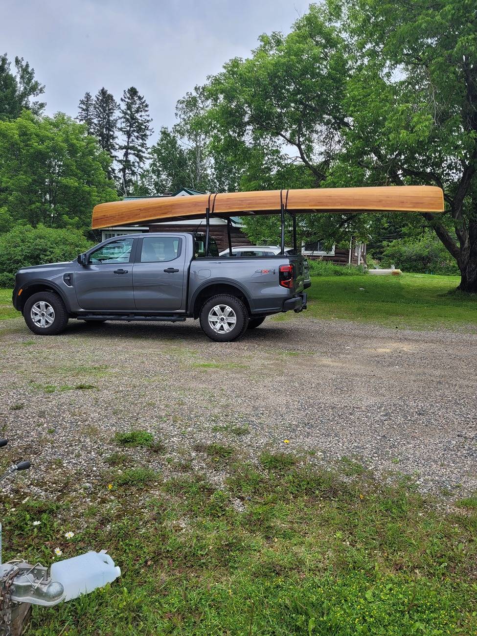

So I played with some high density plastic, cut out six shims, drilled holes through them, matched it with some pressure treated full box length 2 x 4s and bolted my racks through the 2 x 4 and the shims. Turned out to be very solid. Taking a 20 foot canoe on a 500 mile trip tomorrow, see how it holds up.
