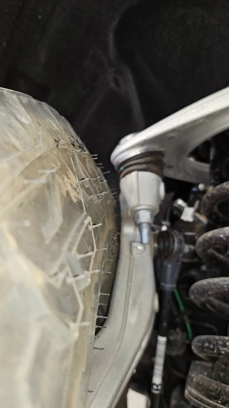

I have purchased the Ford Performance wheels 8.5” rim width 55 offset. Just waiting for my truck delivery. Do you have any pics of your truck with that wheel/tire setup you can share? I’m worried I’m going to be too tight to the suspension. Thanks!
It is really tight, but it never touched. I had about 4,000 miles on that combo before I swapped to my winter wheels and tires.

Wow, that’s very tight. Looks like no more than 1/2”, perhaps even less. I appreciate your reply. I will give it a try and if I’m uncomfortable, I will change to something else. I really like the FP wheels mind you. Thank-you for taking the time to post send a picture. 👍🏻

That photo is what the clearance looks like on my stock FX4 with the 255 tires. I can't get a finger in there, so it's less than ½". I suspect that a wider tire with the same offset might rub.

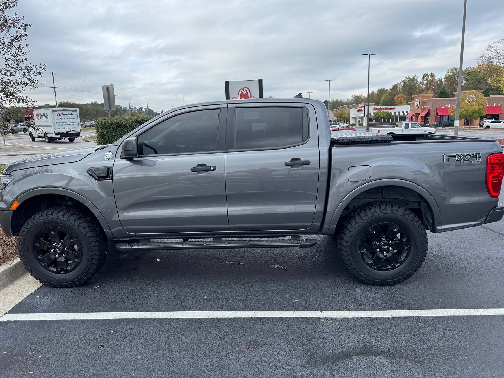

I'm putting a 2.5in leveling kit on my '24 non raptor. My question is will a 275/70R17 fit without rubbing issues? I know I can definitely upsize to a 265/70R17 but would rather go bigger if possible. If anyone has any insight on this that would be appreciated.
I have a 3 inch leveling kit with 18l wheels, originally 265/60/18. I stayed with the 18” factory rims and put 275/70/18 KO3’s and no rubbing

Awesome looking Ranger, Donald! Thanks for sharing with the community.
That's my goal, with a 2" strut lift(once they come out) Is the picture of the 265s or 275s? kind of looks like 265s.
