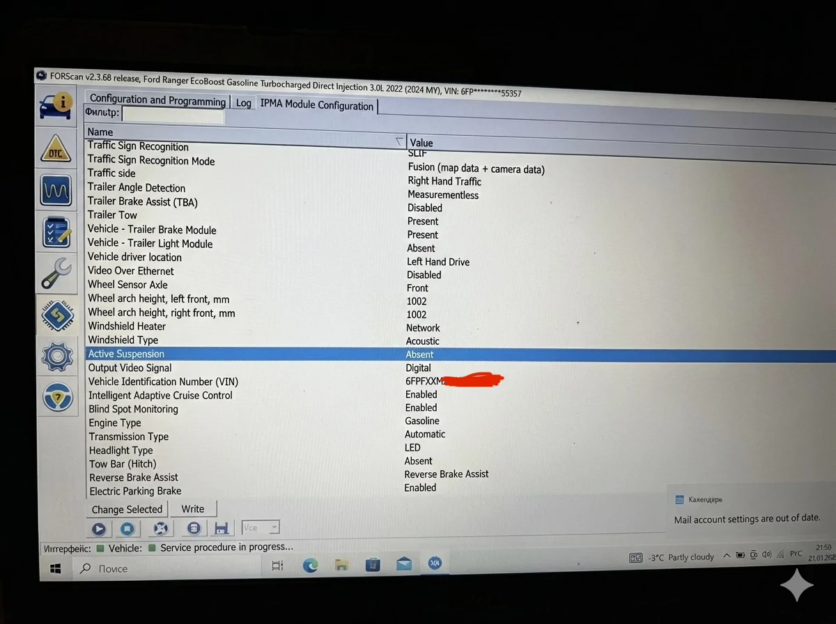

Hi. I noticed that my shock absorber and suspension sensor linkage is broken. Can someone tell me the part number for this part or where I can order it? Also, after two years of driving, my RR's suspension has become much stiffer than when it was new. I also started hearing a knocking sound that subsides after driving for a while, as if after the suspension has warmed up. What could be causing the stiff suspension? I also noticed in Forscan's IPMA module that the "active suspension" indicator is "absent." Is this normal?

The broken sensor is causing your “smart” shocks to work incorrectly. Fix that and also install a pair of steel guards to prevent it from happening again.
