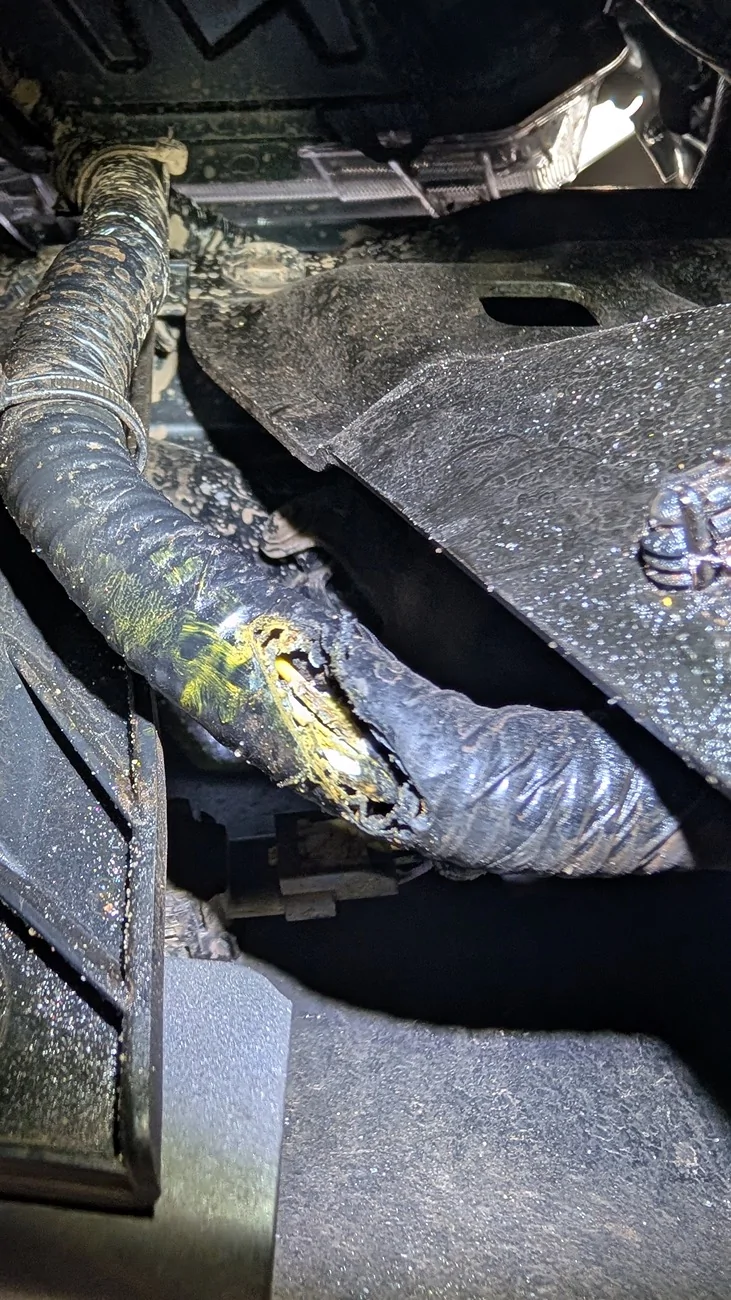

Tech found the loom behind the front bumper to be cut/damaged. Was told not covered under warranty due to my aftermarket led grill lights. The ones from F150 LED. Tried to explain that’s no where near the bumper which then they said it was some external damage so Ford wouldn’t even cover it with the warranty if they tried to submit it. Tech ended up stripping back a couple wires in the loom and repaired them. Kind of bummed and annoyed but paid the bill and got my truck back.

That almost looks like it could have been a rodent. I've already had a mouse tear off part of my battery insulation after only a month of ownership.

Looks like rodant damage to me. My friend had his Bronco towed twice in 2 months because squirrels had chewed the main wiring harness. $4,000.00 each time to fix.
