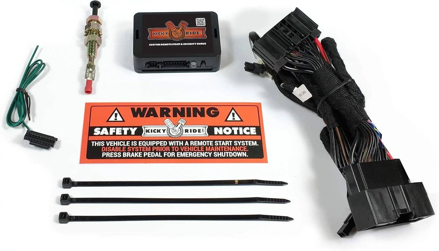

There might be aftermarket kits out there that will utilize the OEM fob that makes you press the lock button like 3X to initiate a remote start. I had one for my 2020 XL F-150.
Jason B
Apr 27, 2023
1,355
1,488
2024 Ranger XLT FX4
machinist
You could get a module from Start-X for about $100 that plugs into the OBD port that works with
non-push button starts and factory fob.
