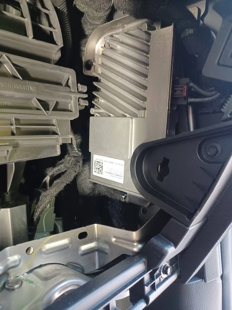

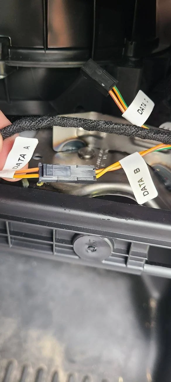

Update....STARTX is now making remote start for 2024-2025 key&push start both...t,s into module behind glove box..this fit mine just fine!!! Works well! 140$ plus tax
