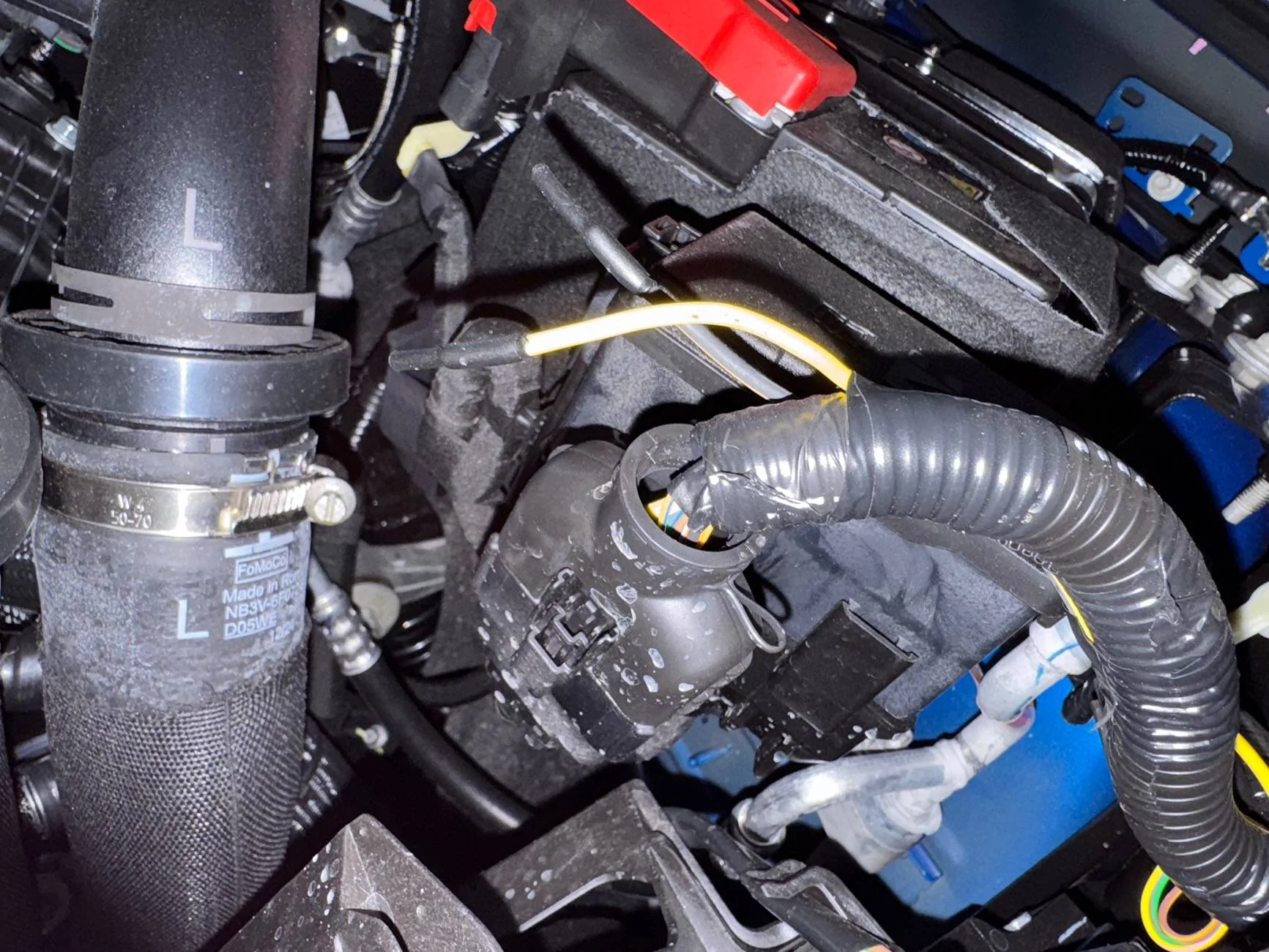

I just got my new Ranger Raptor and noticed the conduit that should be attached to the connector beside the battery is pulled out. Can I safely split the connector and reattach the conduit or should I just go to the dealership? Any help would be great!

its up to you. if you are close to the dealer and its no trouble, let them do it in case there is any moisture or corrosion inside. if its not, or you want to check it out yourself, open it up and check everything and then put it back together properly.

Thank you for the reply. Would I need to disconnect the battery to pull it apart? Without a schematic I’m not sure what the connector is.

i would just disconnect the power from the battery and undo the little latch on the side so i could pull it up and mess with it

Mine looks exactly the same as yours. The one I test drove was exactly the same too.

that is not good. wahts the point of those weather proof connectors if the other end is open.

I was thinking the same thing. I’m going to either fix mine or get it fixed ASAP. Luckily it’s only been two weeks for me. Are there any issues disconnecting the battery? What will I erase?

Radio stations and maybe fuel and trip meters will reset
