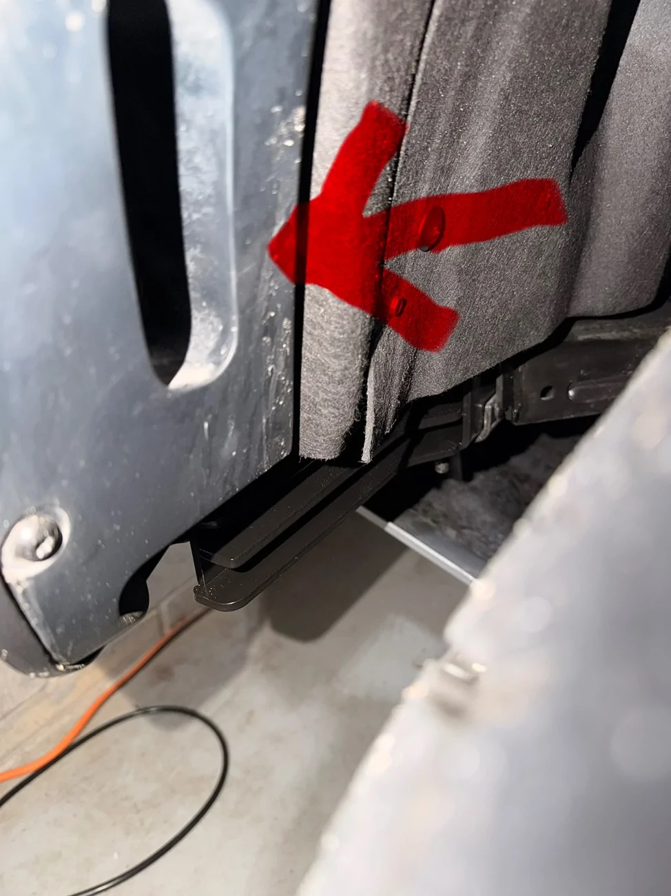

My mistake. I was talking about the rear one. I removed the piece in the picture, has 3 screws. I also removed the 1 large star bolt underneath screwed into the fender for a few mm more space and the front ones slid right out.
