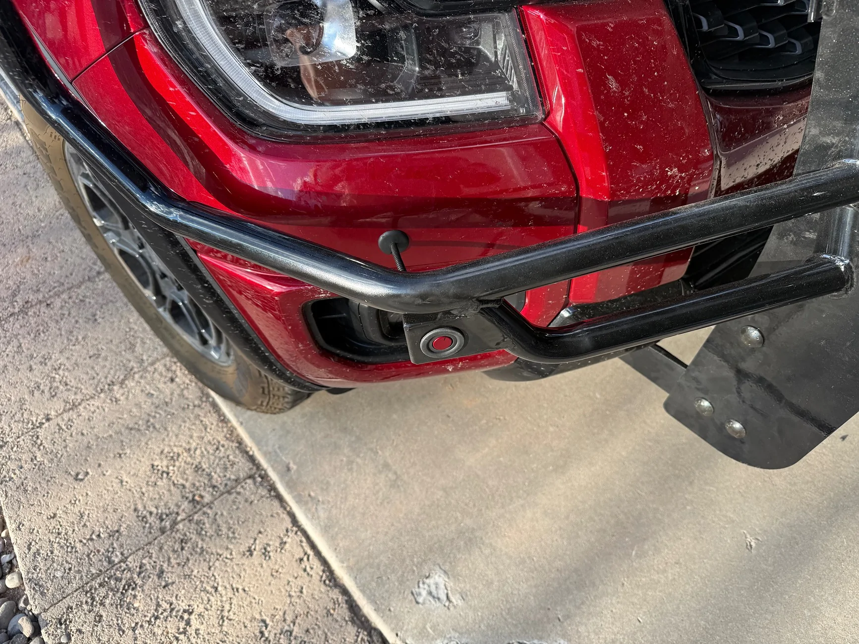

I added the grill guard because I liked the look, and the only one that even offered compatibility with a 2025 Ranger was Ranch Hand (real truck.com had one that was really more of a glorified bull bar). They said it wouldn’t fit a lariat because it blocked the sensors. After modifyinga sensor relocation kit from Black Rhino that used sensor extensions for a 23 ranger, I ordered Flux3D Ranger extensions but unfortunately they had to be shipped from Australia. And by shipped, it wasn’t because they shipped to the states. I had to have a buddy pick them up and send them to me! However they work perfectly, and now my Ranch Hand IS compatible with a Ranger lariat!

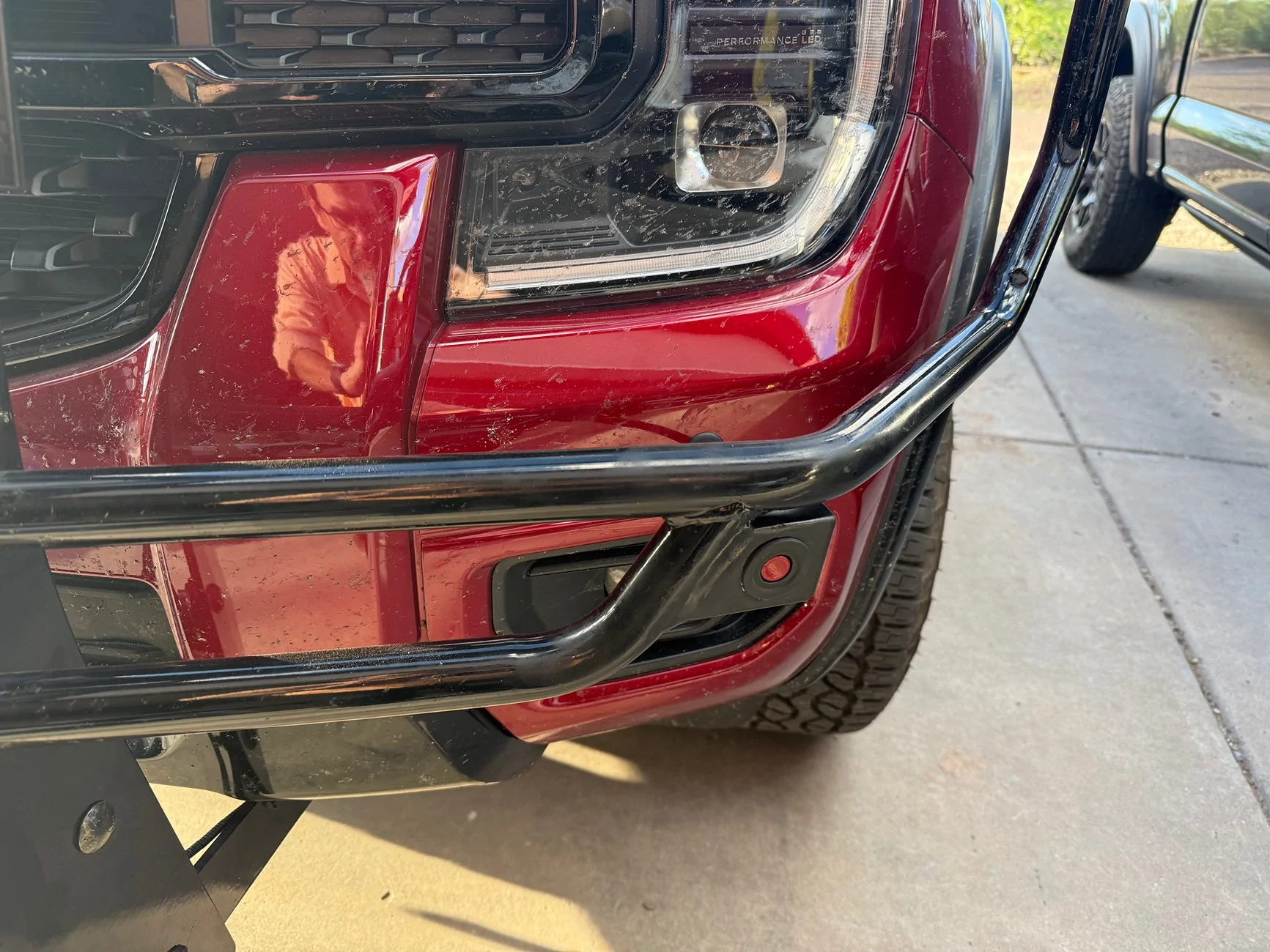

And now my front sensors work. I’d like to take credit for the welding, but I did not. The amazing part is that I took it to the high school welding program, because they are always looking for projects, and a senior did this. The only potential complaint is that he cut the boxes a little small and there is a bit of an angle to the sensor so I may have to take it to be recalibrated. Very small price to pay!

nice!!
those high school votec classes do some good work. i know people htat have had vehicles painted and engines rebuilt. you just supply the parts/supplies and they get it done.
