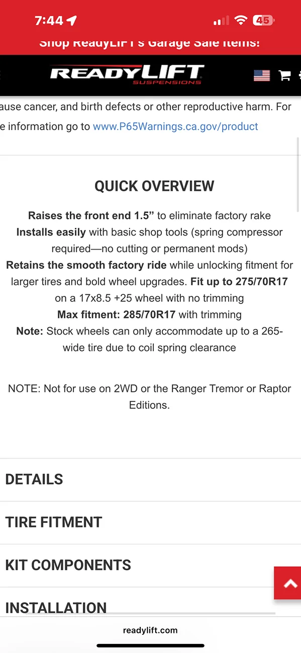

Ready lift sells a 1.5” level and mentions in the fine print that 285/70/17 will only fit with their level after trimming and that stock wheels won’t clear a 285. I would go 265/70/17

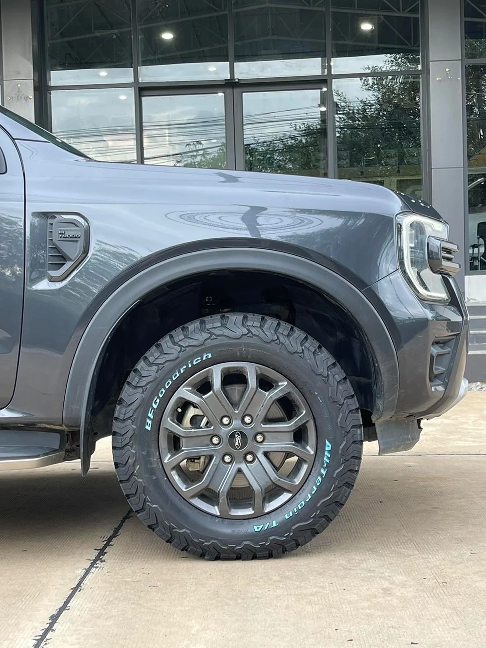

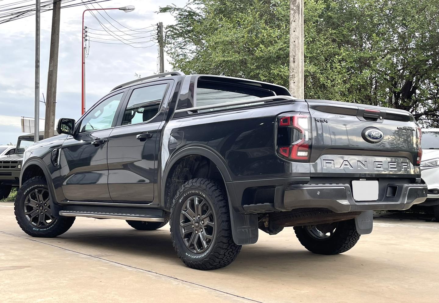

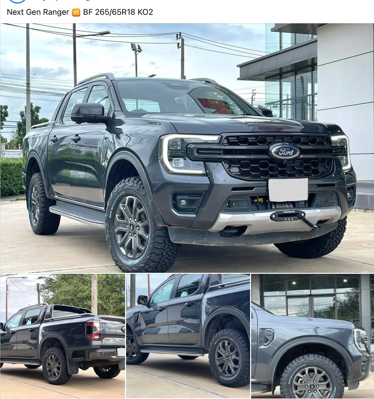

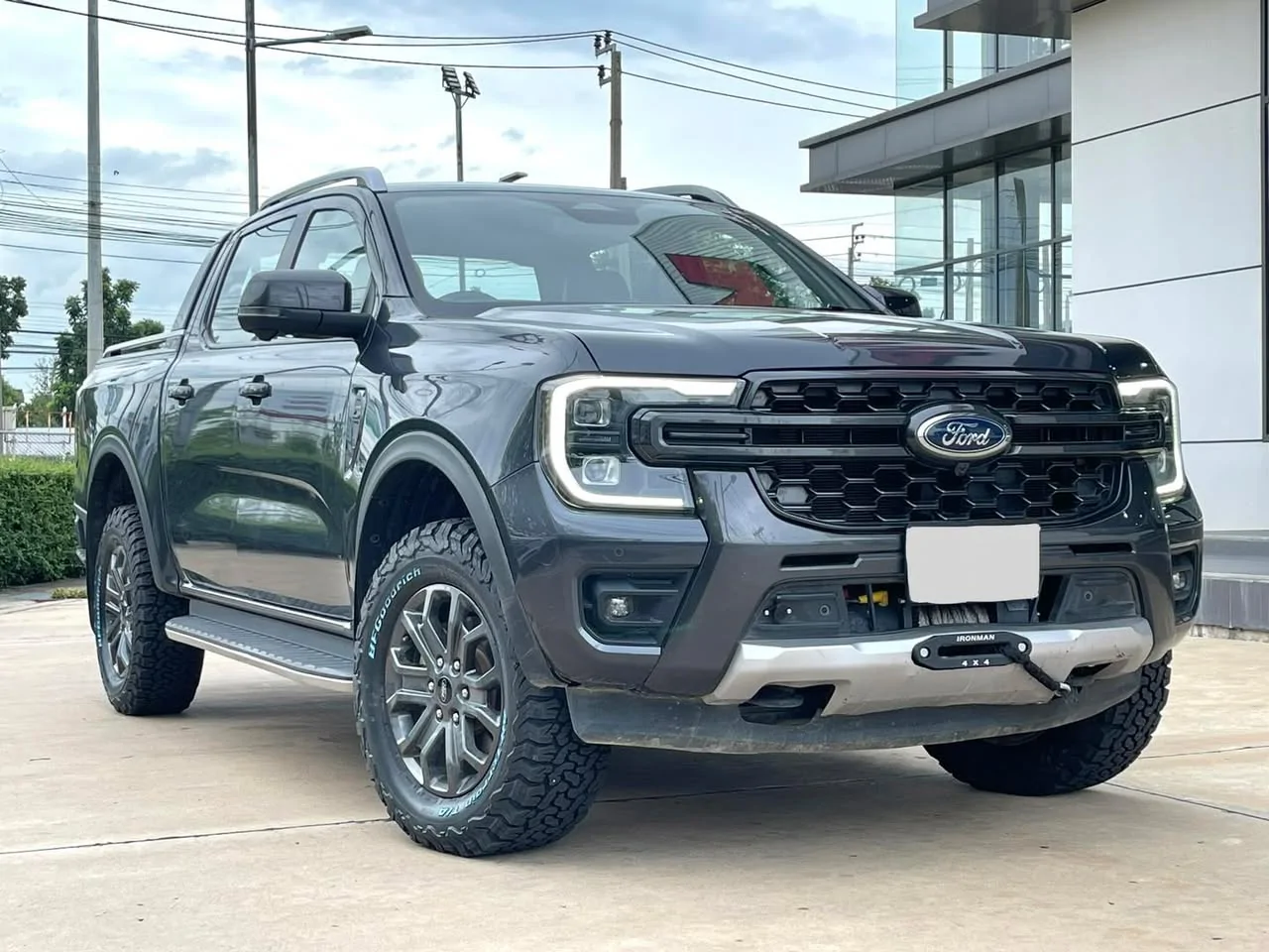

Do you have any pic's to share? TIA
I found these pics just now in an open google search of a 6g Ranger with 265/65R18s.
Better then stock 255/65R18s but still maybe a little smaller then what I was shooting for.
‘Could just be the nature of the BFGs, they tend to be narrower then most where tread width is concerned.
I agree.
