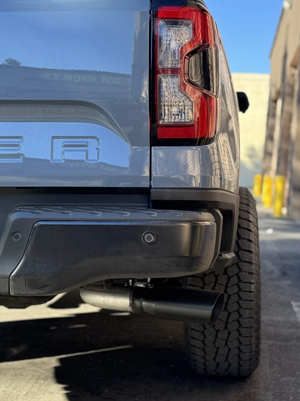

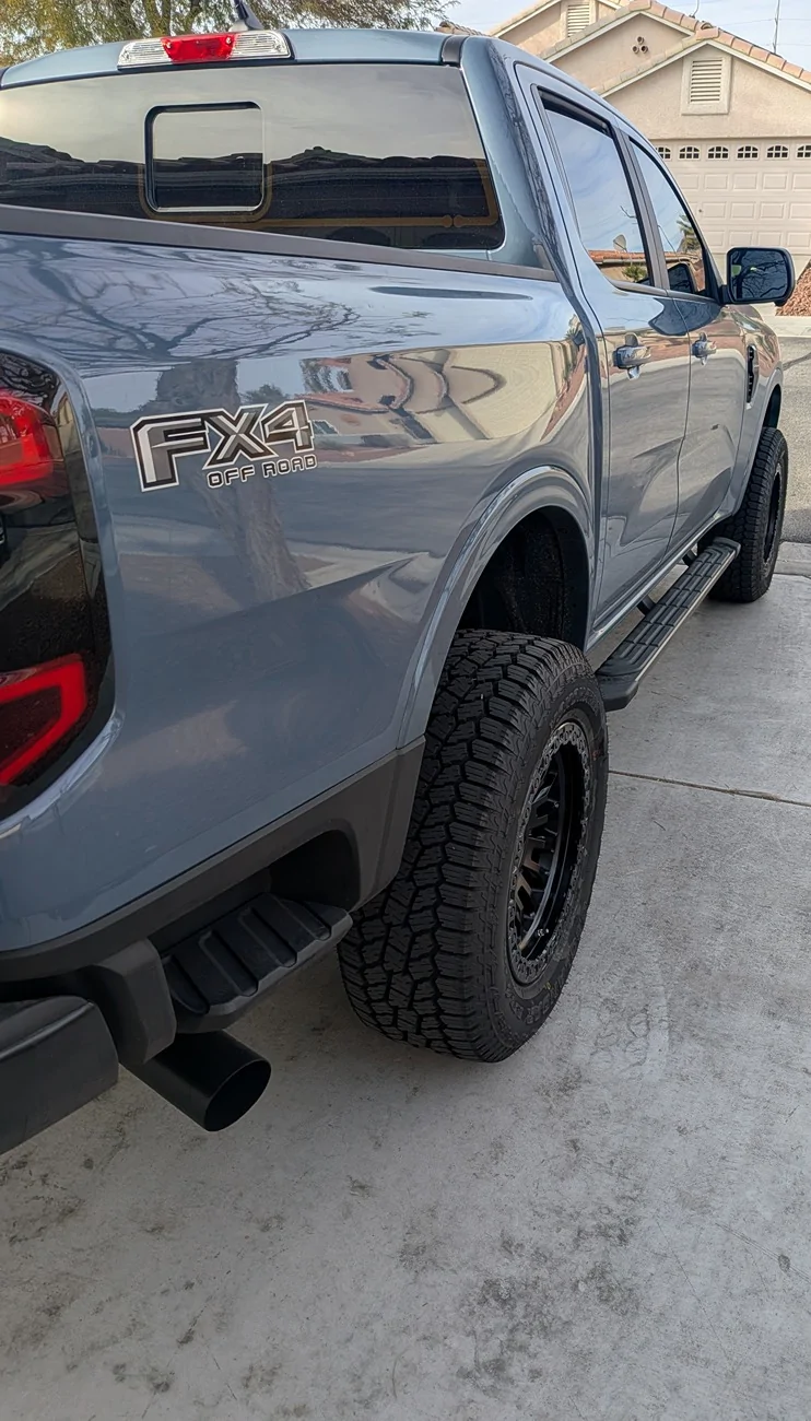

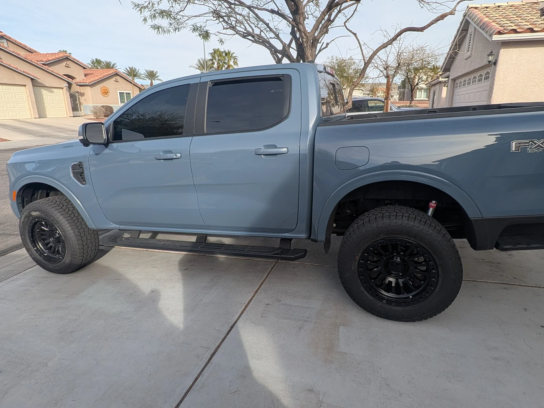

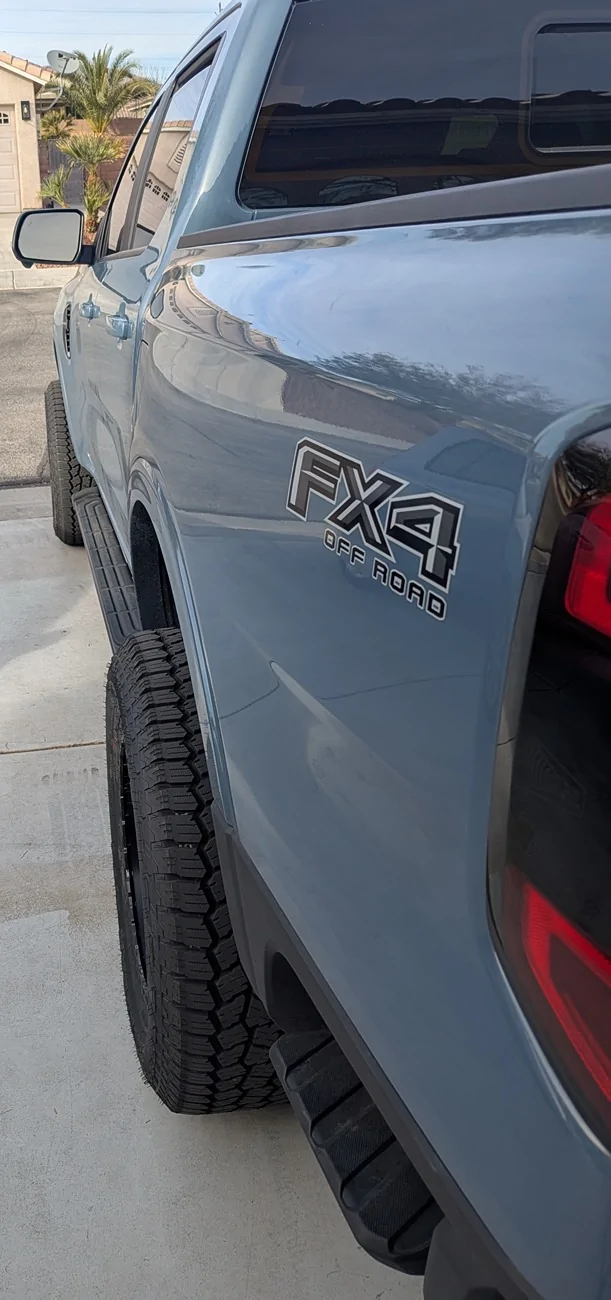

@HighDesertRanger
WHEELS - Fuel Wheels Rincon Matte Black with Gloss Black Lip
6-Lug Wheel; 18x9; -12mm Offset
TIRES - 285/60R18 Yokohama Geolandar A/T4 G018
This is without the fendor flares as I am waiting for them to be delivered.
