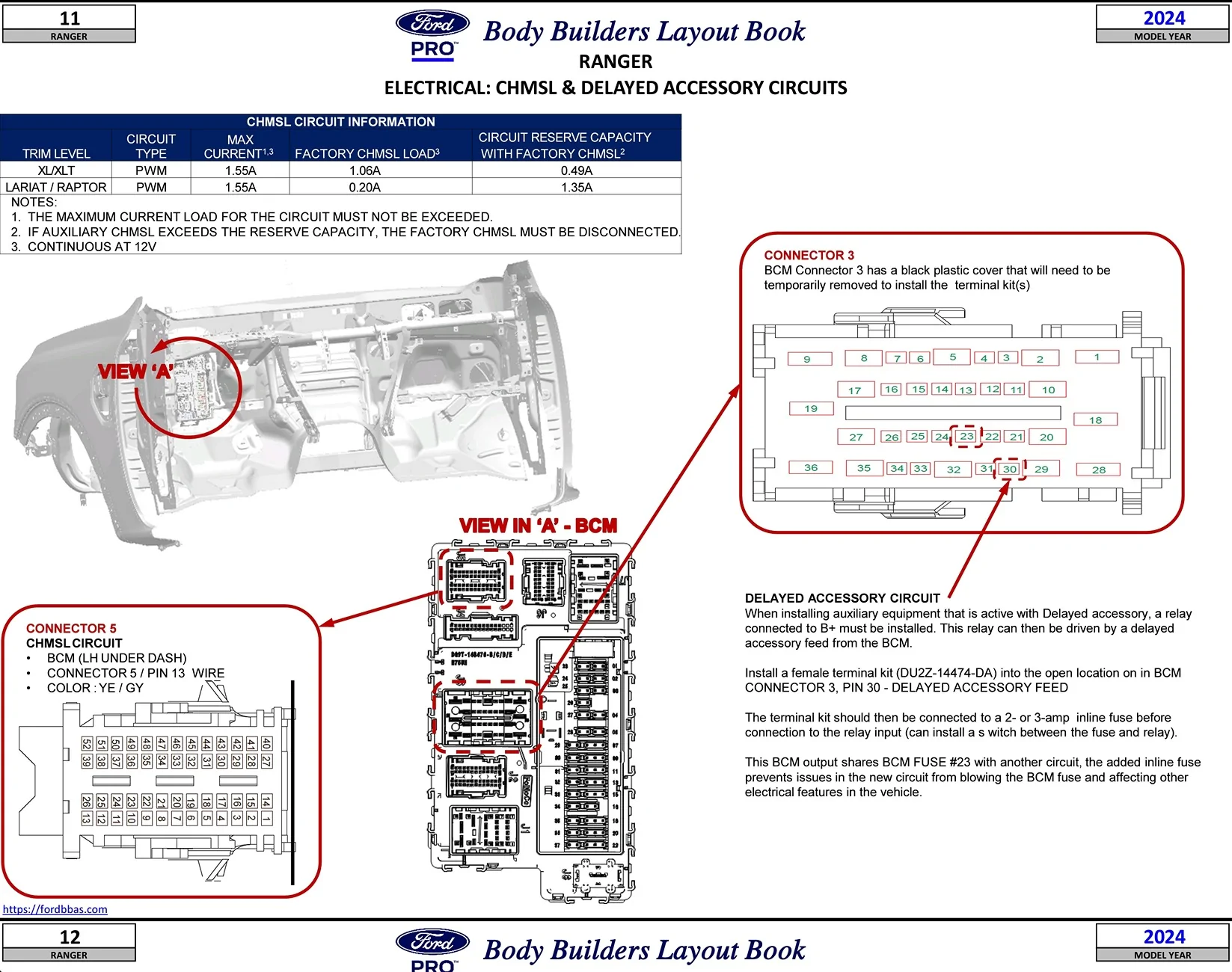

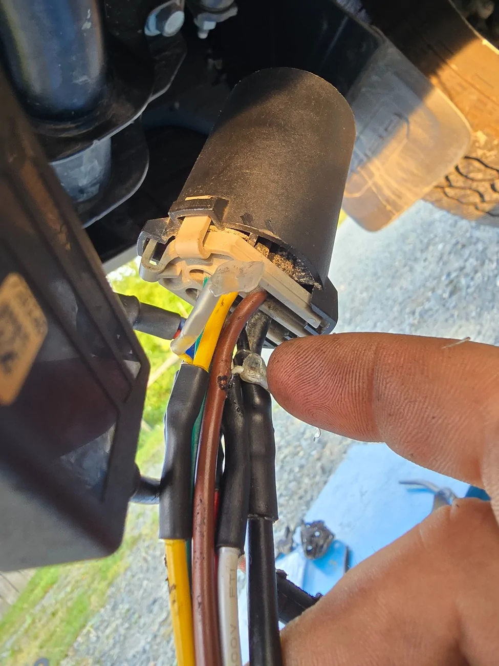

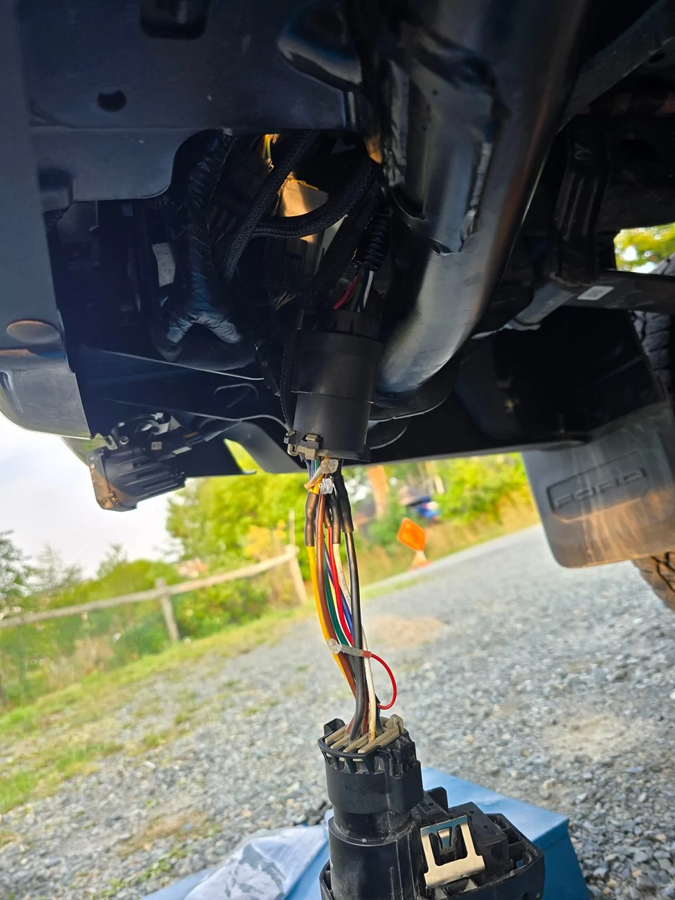

I got the c1r's I had on my old escape, using the 7pin dual harness, I was getting trailer brake/turn errors, as the brake module uses both left and right turn/brake for the brake signal. it stays brake if only 1 brake signal and would flash if you put your hazards on.
As per the ford body builder guide I tapped the 3rd brake signal off the bcm and ran a wire back to the rear for my cap, and the c1r's. I cut the brake module off the dd 7pin harness and capped them and hooked them to the brake wire from bcm. the diode harness still gives me my marker, ground and reverse power.
