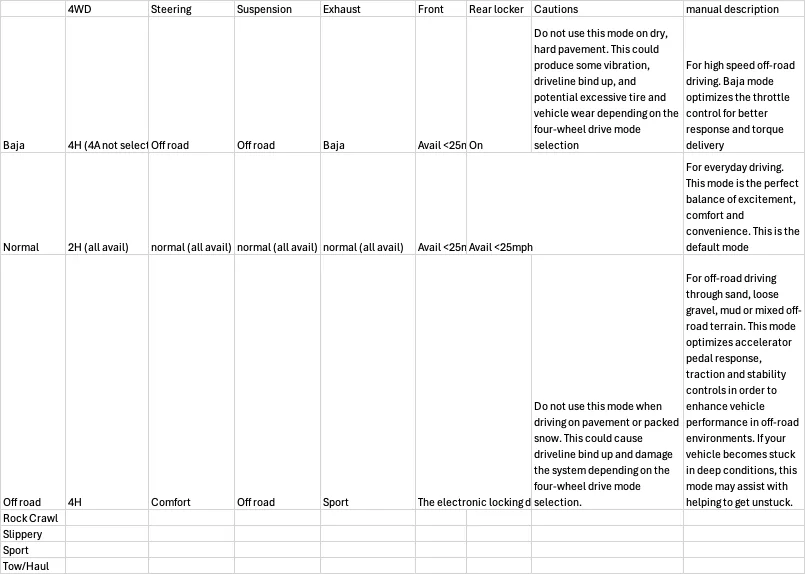

Oh, in trying to get my head around things I'm summarizing what I see in the manual. At least for the ones that matter to me at the moment.
Ford Ranger Drive modes details: how can I be good to my truck while flogging the sh*t out of it? 1769997791260-3c

The locker is stronger than your driveline and u-joints. Per your manual, use the locked differential at speeds under 25 mph.
4 H is for off road use, typically under 55 mph. Do not use 4H on hard pavement, or ice covered pavement at high speeds.
Baja mode is for high speed off road use
Slippery mode is basically a traction control setting, for rainy slick, snow packed or icy roads. You don’t want a peppy throttle response. It applies the brakes slightly to a certain wheel if it looses traction. It’s not designed to be s fun or thrilling drive mode. It’s a keep your truck going straight in crappy weather mode.
I don’t have a raptor, so I don’t know how ford has the 4A setting configured. Maybe someone else will chime in on it.
