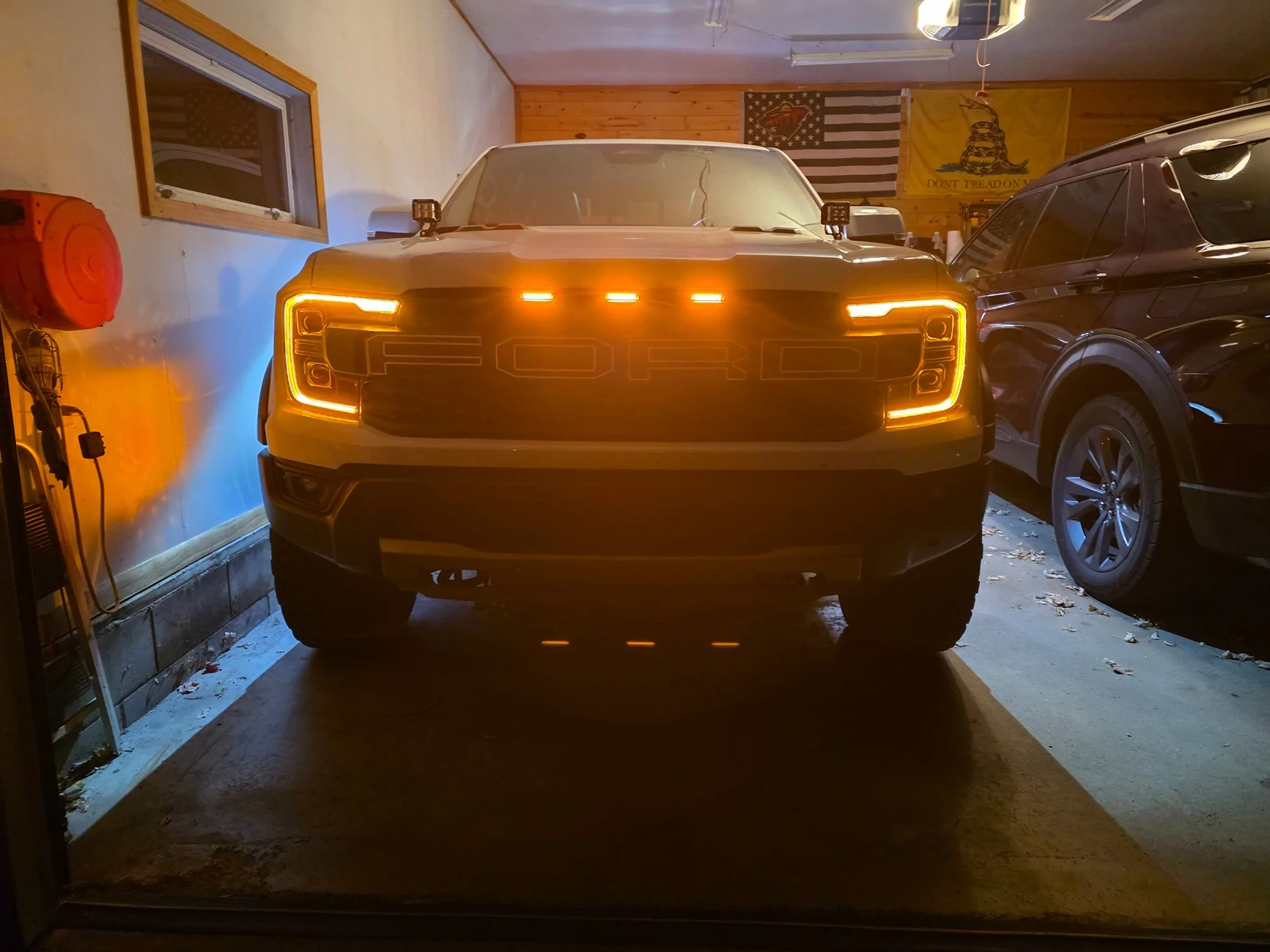

Also got mine installed. I used 1/4" drill bit and made 2 holes right next to each other then opened them up downwards to make a big enough hole for the plug to fit (it flexes) vs the 7/16" bit recommended. That way I was only drilling at the back of the opening. Biggest pain was routing the side marker light harness. I didn't like the quick release connectors so I replaced them with weatherproof butt connectors.

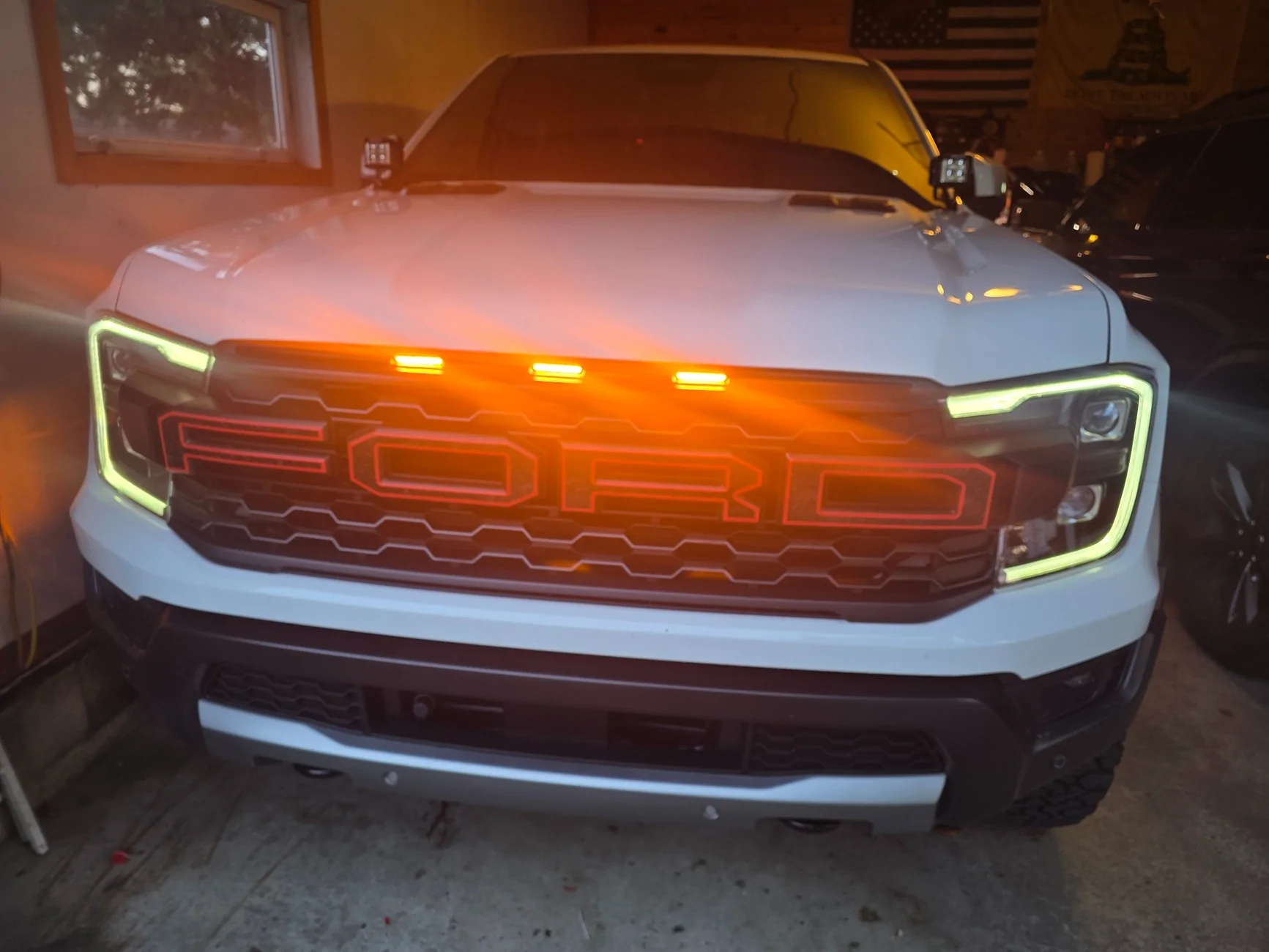

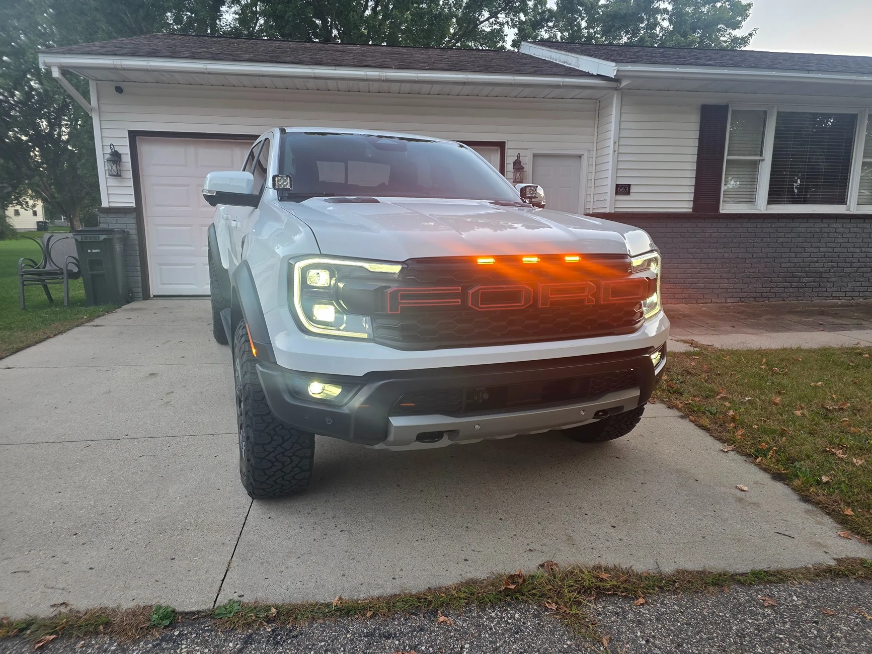

installed mine the other day, by far the best light with no dots!
Love the photos and the lights look fantastic! We appreciate your support! :cool:
