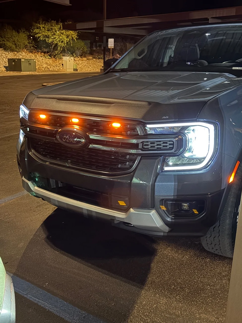

I tapped the side marker lights with no problem. I did have to use a wire snake to pull the grill light wire down to the marker light but once I did that it was pretty easy. I tried using their plug and play harness but it didn't work for me so I tapped the wires of the marker light instead. works great....
