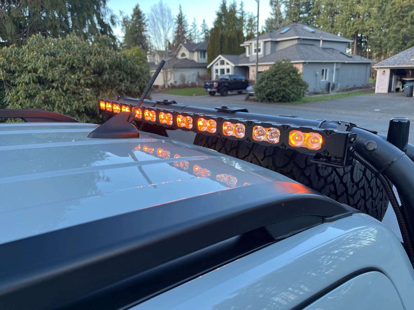

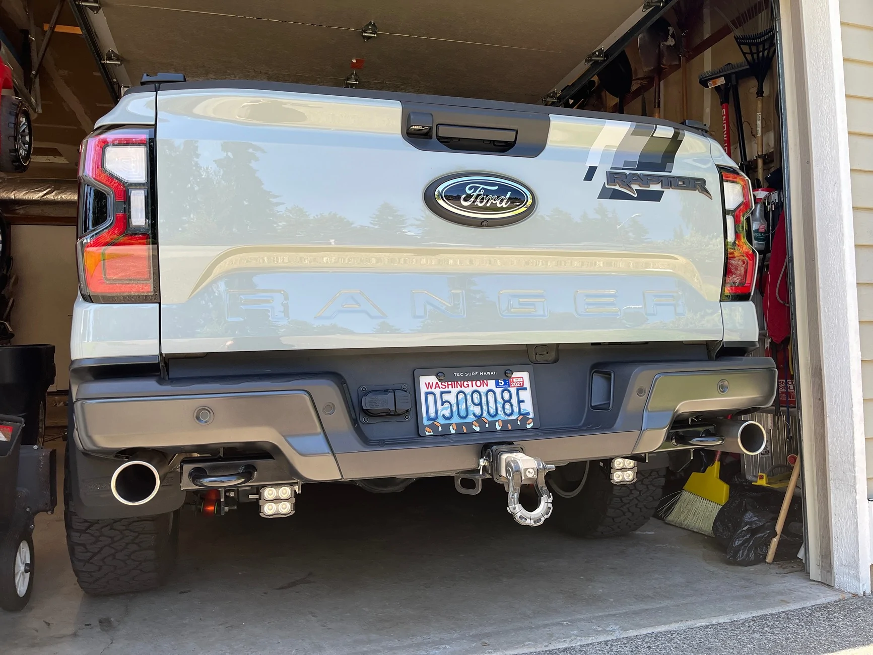

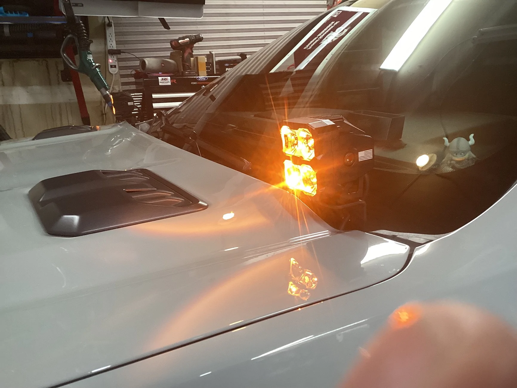

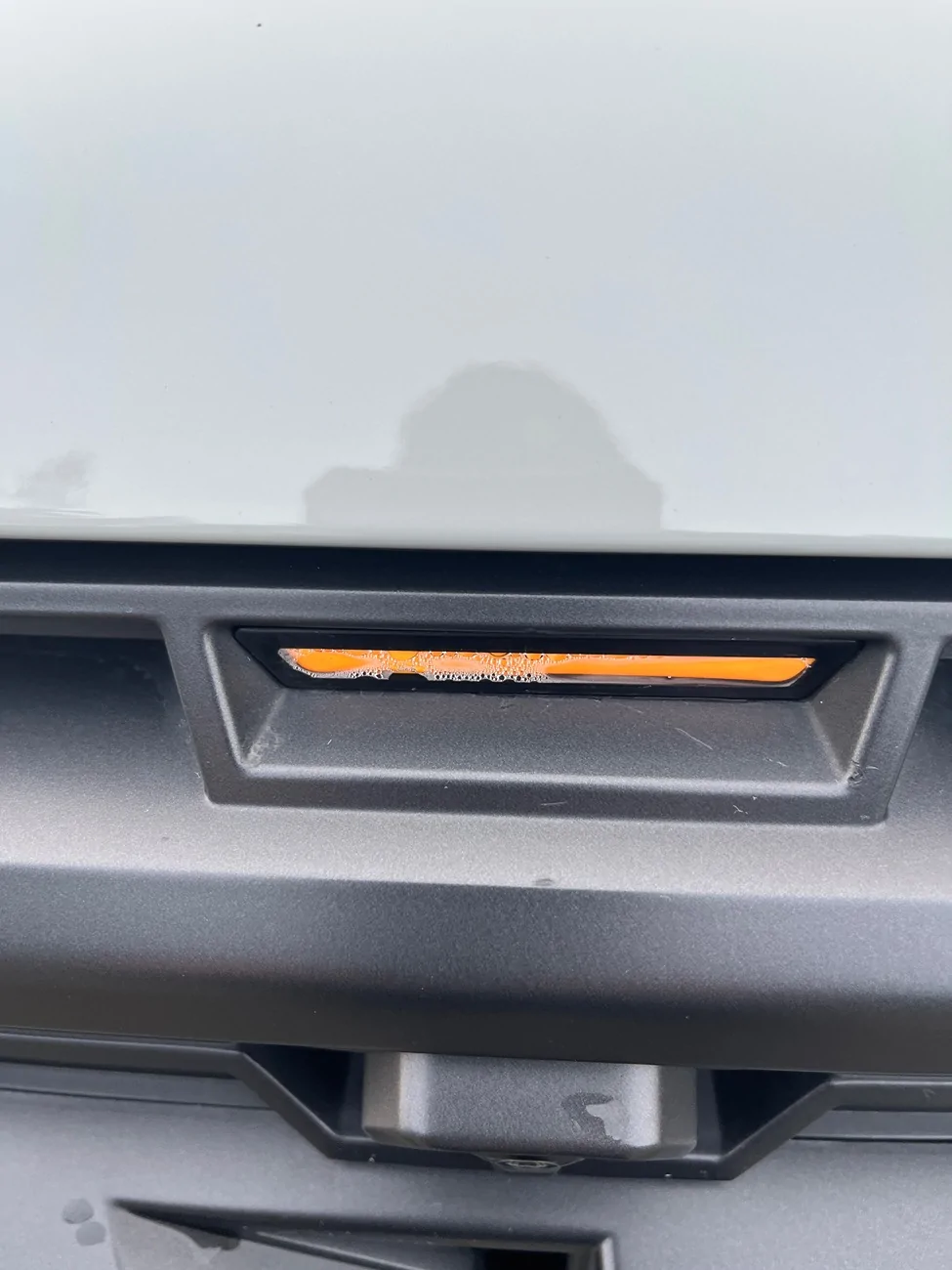

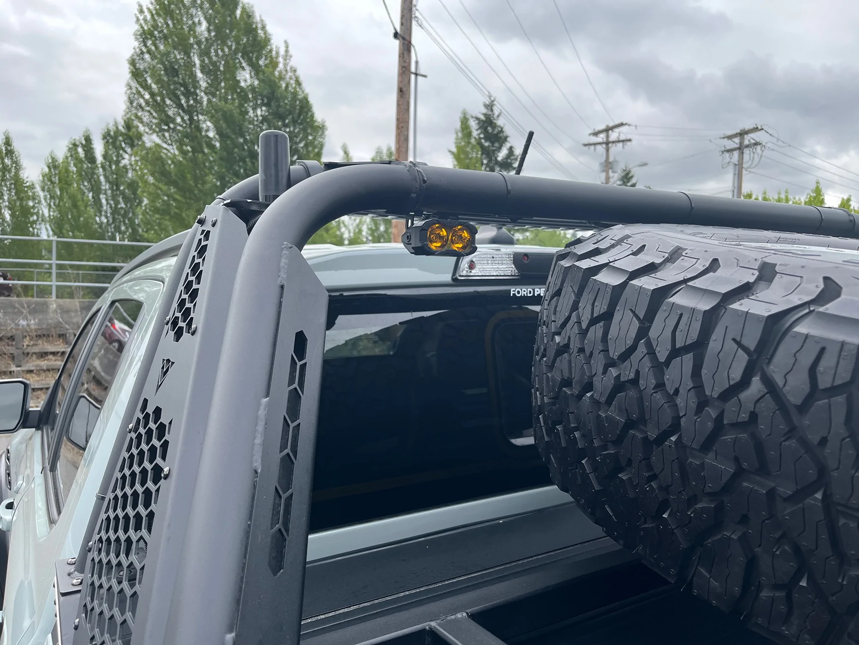

I cut the ends on mine, had one get a little moisture in it. I sent this pic off to them, no questions asked new kit araived four days later. I have many of thier products on my RR, great product!

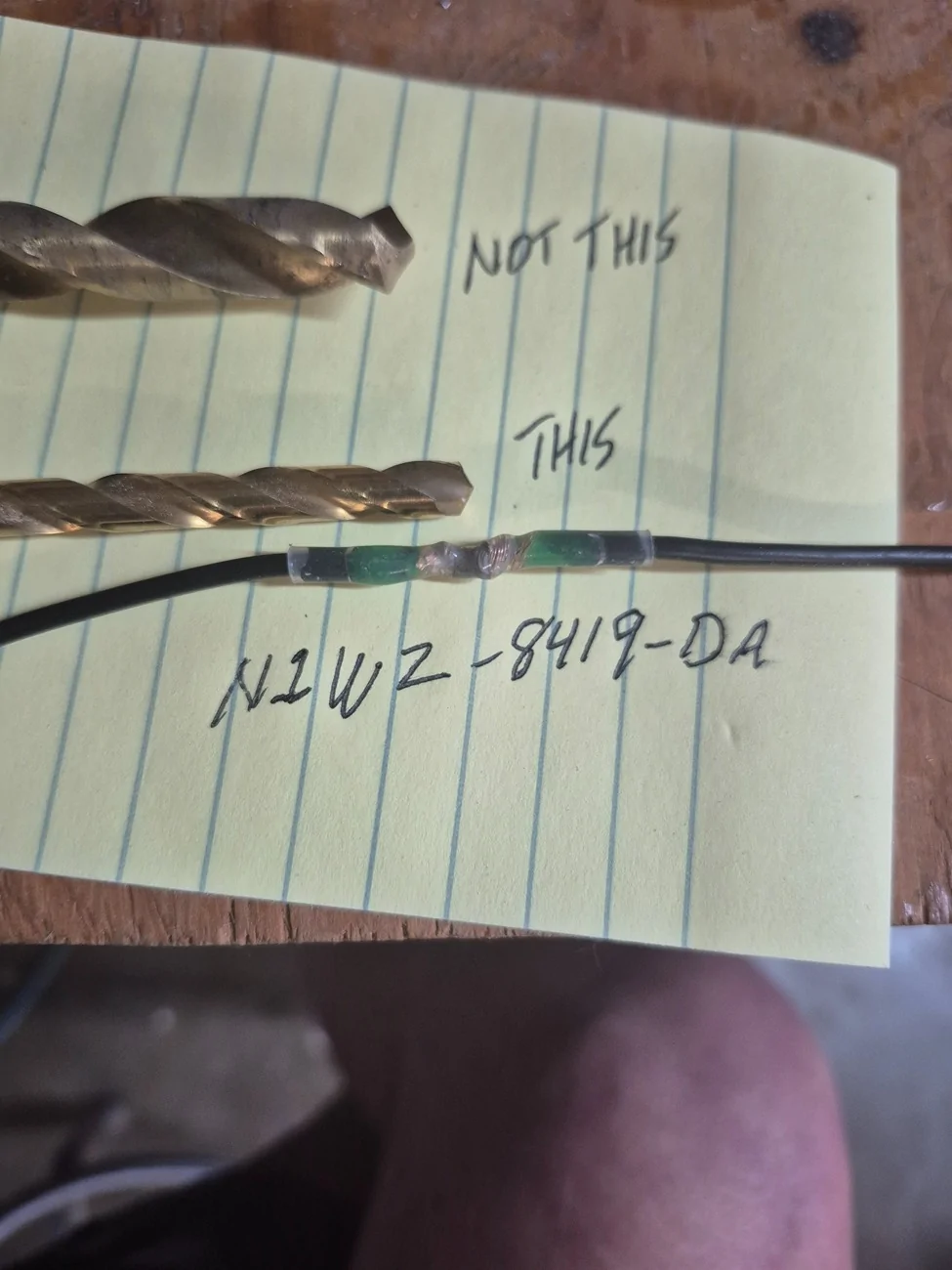

To my friends, and F150LEDS. Here's how to do it without risk. Below is grill upper part #. The splice is waterproof shrink tube with solder. ENJOY
