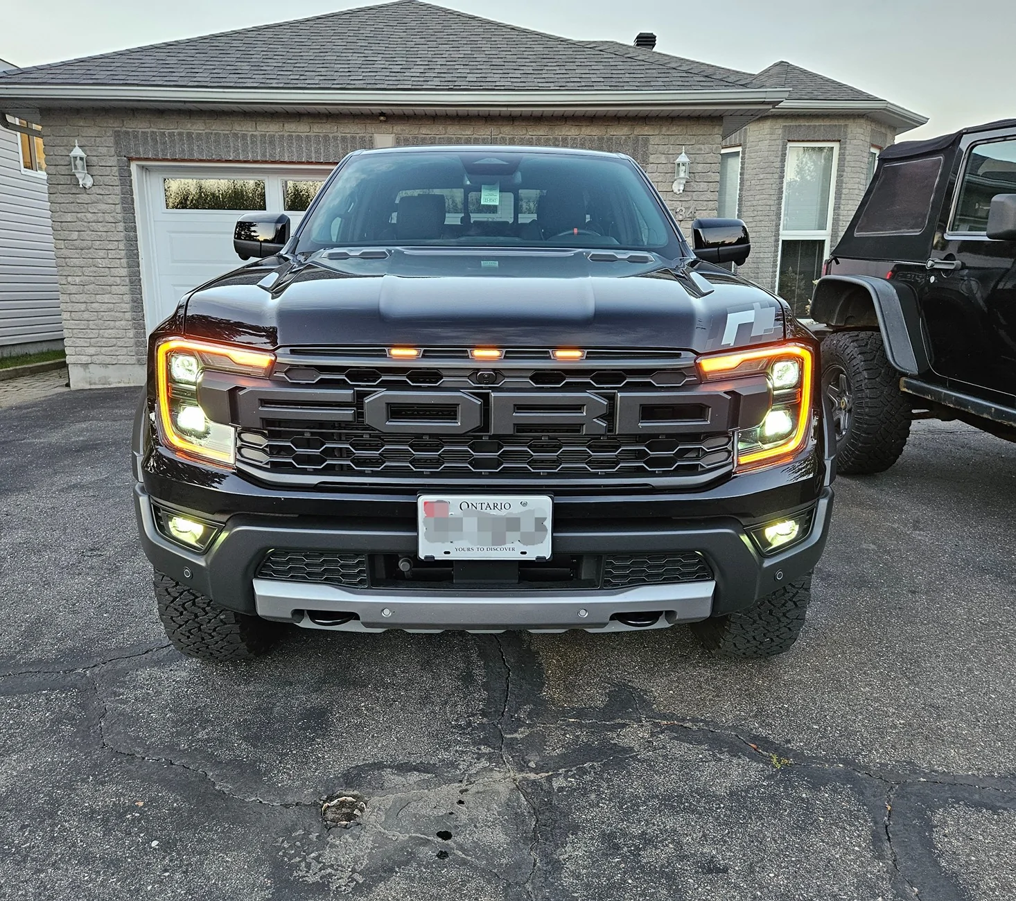

Just finished installing the amber lighting. I don't have any night pics yet, but I took one with the front end in the garage.

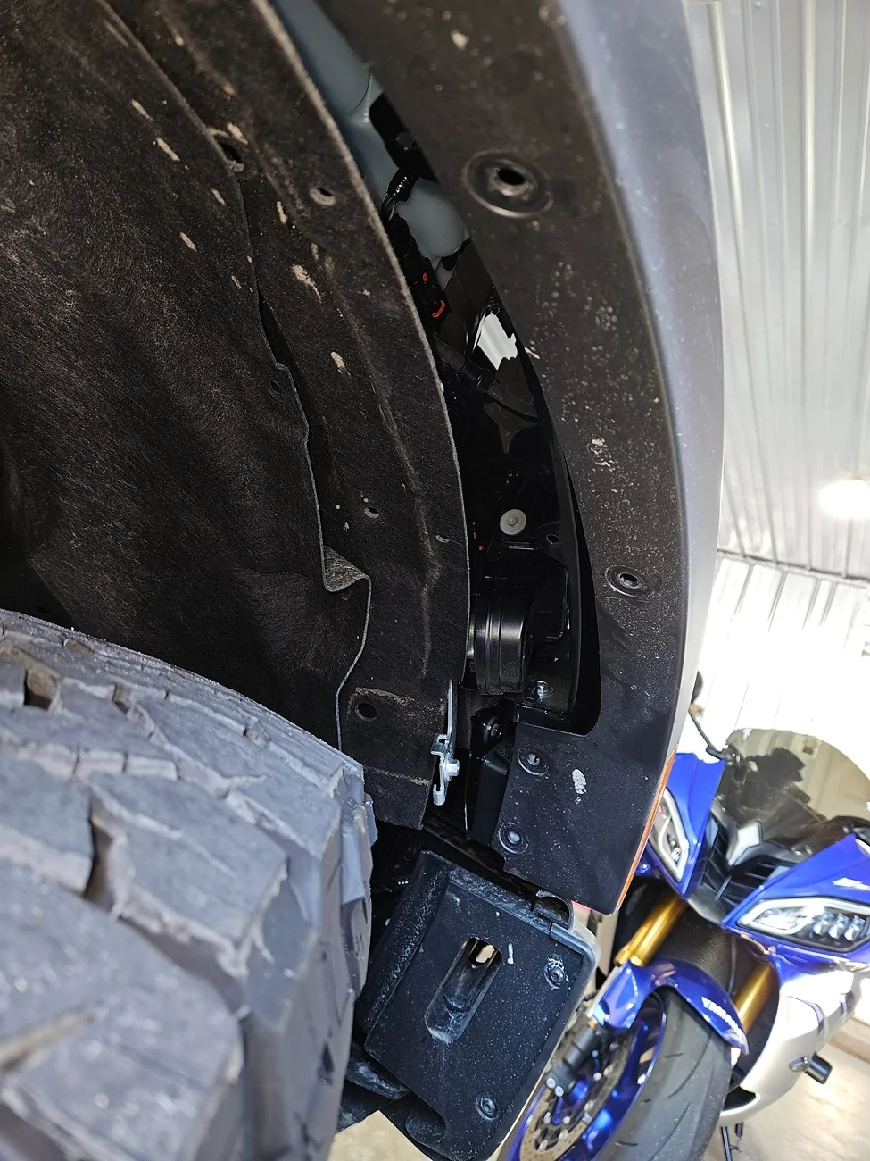

The install was fairly easy, I didn't remove the wheels or fender liners and I didn't use any fancy tools, no adjustible snake drivers. All I did was turn the wheels towards the engine. I then removed all the hardware connecting the outer liner to the inner liner and the fender flares. I ended up pushing the outer liner under the inner liner, didn't have to fold it back. It gave me enough room to get to the modules. I removed the horn on the passenger side, but left it in on the driver side. I also removed the two bolts holding the fenders and pulled it out and put a small screwdriver in the bolt hole to hold the fender out.

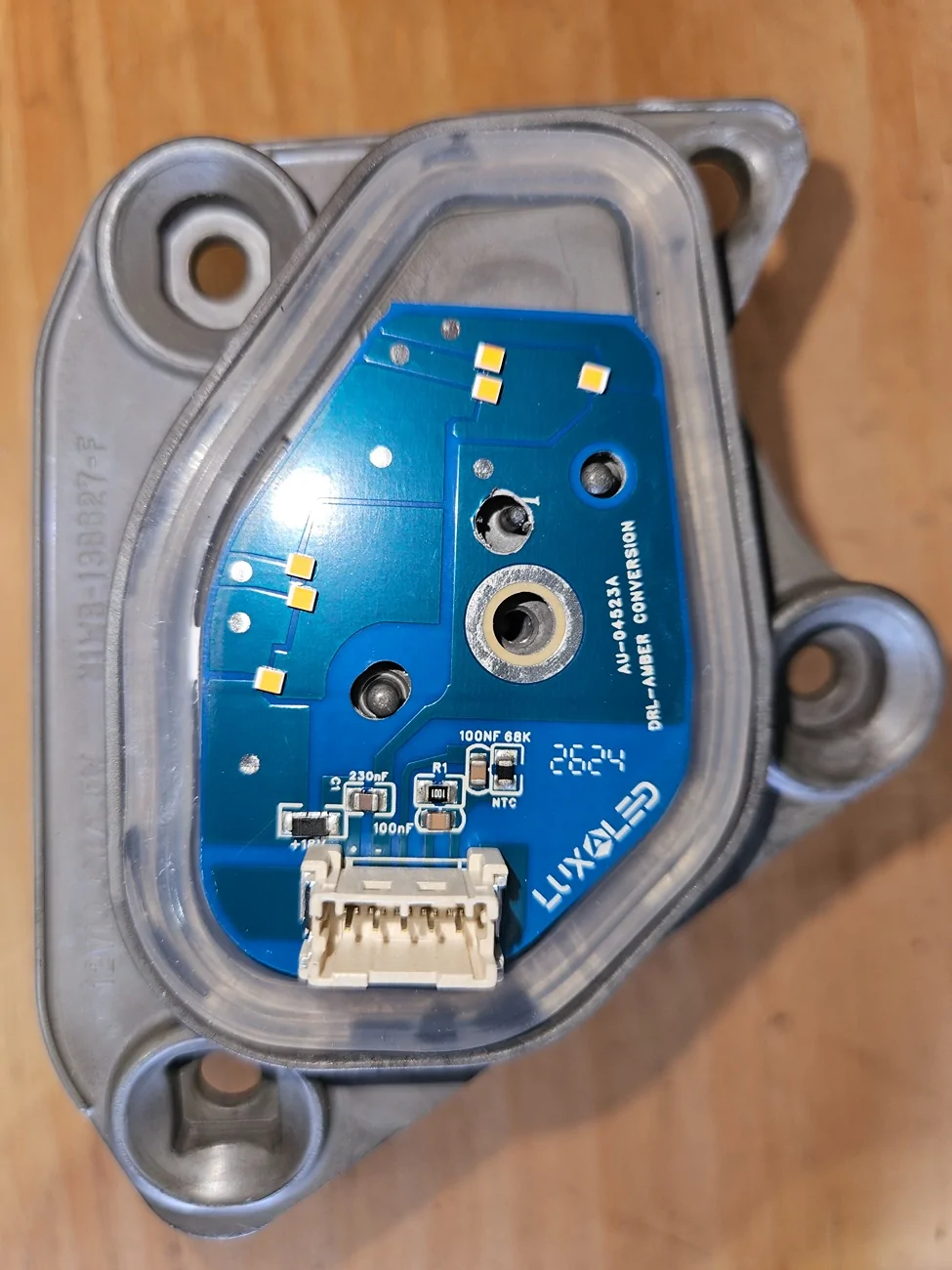

I didn't have to break the line up tabs when installing the boards, but I did have to file the driver side board hole a lil since it didn't line up. Here's a picture showing how it didn't line up.
I didn't snap a picture of the driver side, but the outer liner did not slide in as much since it's a bit different than the passenger side, it slid a bit and then i had to lift the liner up a bit to get my hand in there.
Amber DRLs = Signature Lux matrix version
Grill lights = Moustas LED panel dual aux control
