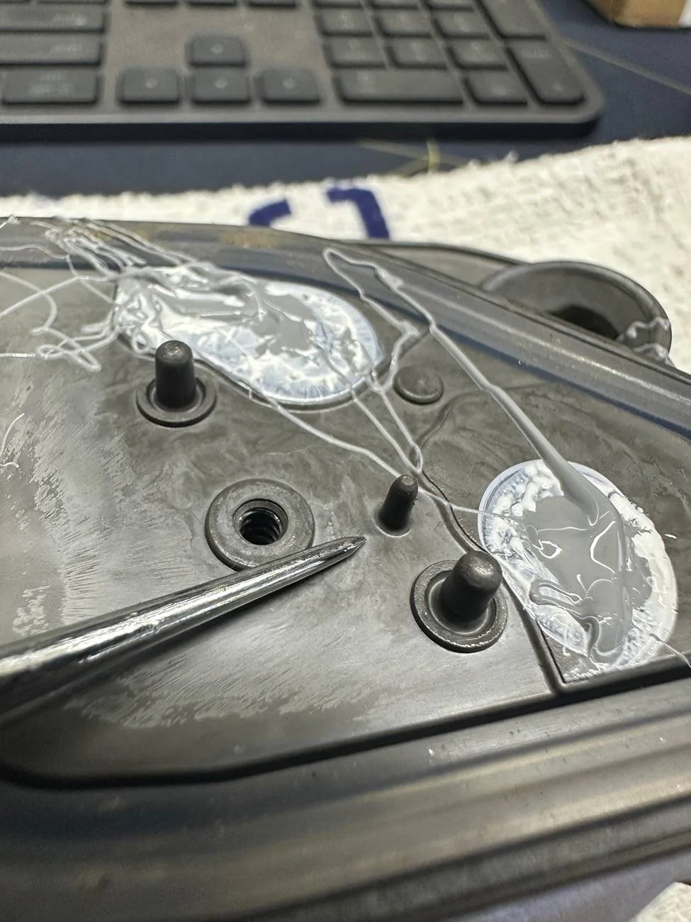

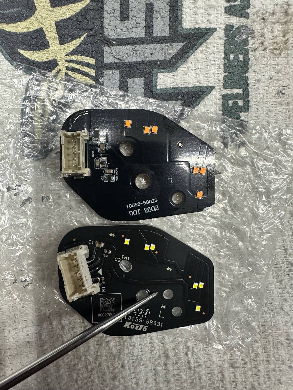

Again trying to save coin I ordered from eBay.
Picked up a set of the Amber DRL boards and tackling that as I type. I finally wrestle the first one out and having an issue with the new one not fitting. The old one (white) has 3 locating pins and a screw hole. The new one (amber) has only two pins holes and one screw hole.
Do I grind the pin off of the module? Drill a hole in the new board? Or send them back?
Anyone else run into this?

Cut em! Thanks for the recommendation @stuartmunto

In case anybody is wondering, I just bought a set from signature lux and the paid they sent me actually has the 3 holes in them so you don’t need to break any of the pins off.
