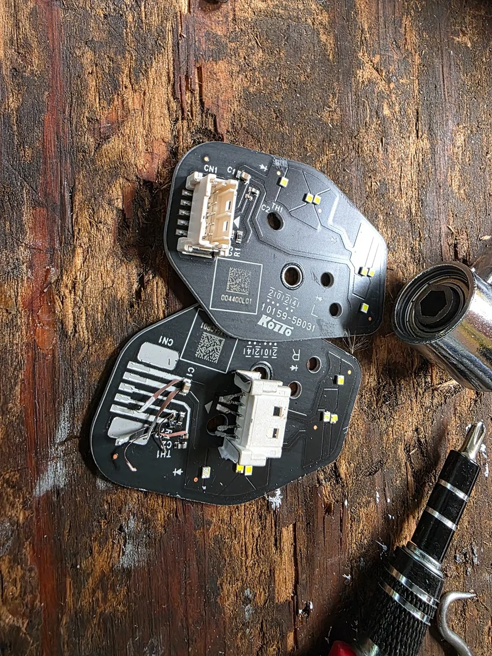

Got mine done. Happy with how they turned out. Should have come this way from the factory. The pic of the board is thr passengers side oem board. It came out like that before I even attempted to disconnect it. The board solder points and glue points fell apart just unbolting the heat sink. This would eventually be a warranty claim or out of pocket as no way it would have lasted in that condition.

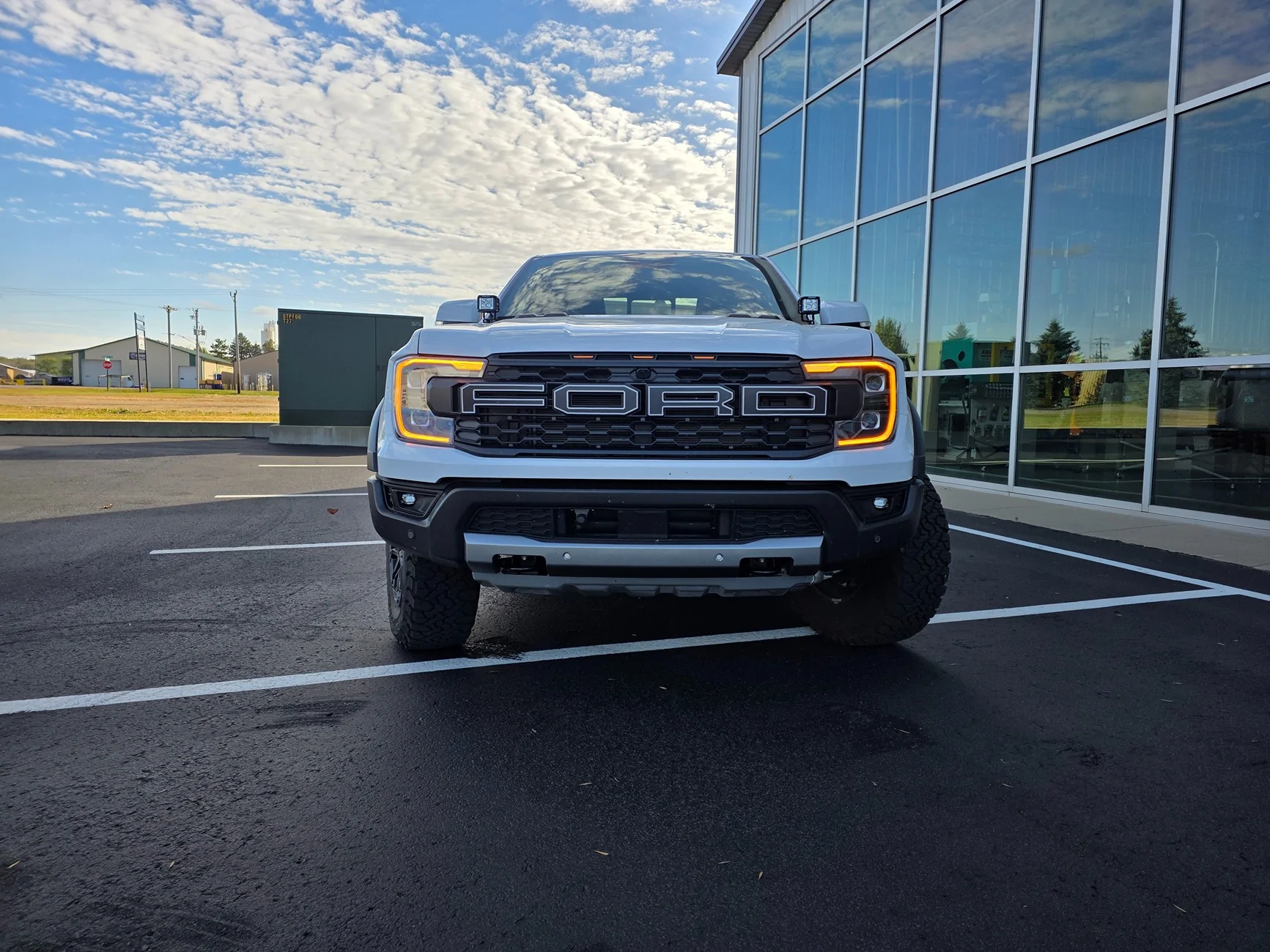

Perfection. How it should have come...
