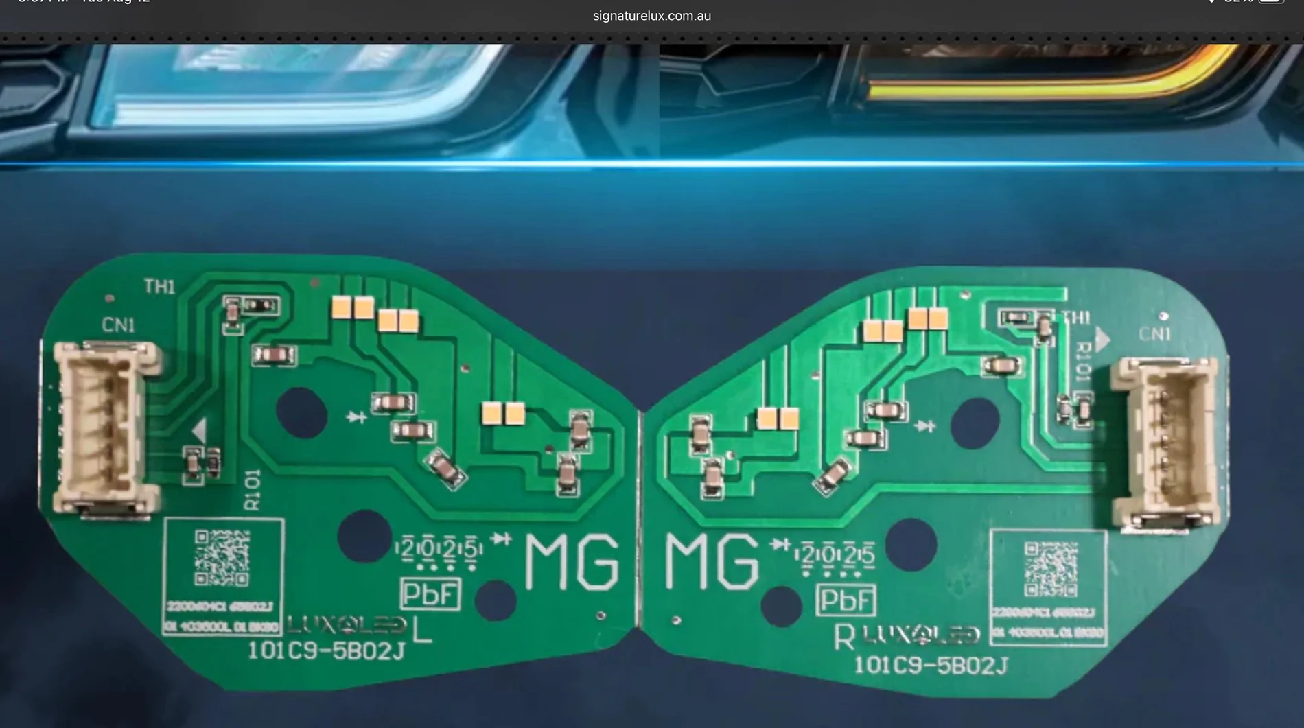

Use a metal shop pick and gently push in the though the two small squares. That will release the two tabs on the male. Worked and was easy.
Look closely at the new amber female and you’ll see the two square holes I’m talking about.
Can you be more specific?
Look at the female receiver and you will see two small SQUARE holes. That is where the tabs on the male harness will set. Gently push the tabs through the holes to release the tabs and the two parts will separate.
Sorry, I’m a little dense today. You mean these square holes?
